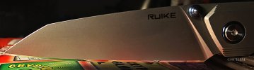

Spyderco Southard. During sharpening, I messed up and chipped off the tip pretty badly & had to reshape it. This is my first attempt at reshaping a tip. This CTS 204P took more time to sharpen than any other steel I've encountered yet...aside from the work on the tip. Glad this one is finally done!Southard mirror reshaped edge.jpg
Spyderco Southard. During sharpening, I messed up and chipped off the tip pretty badly & had to reshape it. This is my first attempt at reshaping a tip. This CTS 204P took more time to sharpen than any other steel I've encountered yet...aside from the work on the tip. Glad this one is finally done!View attachment 793254
I just did my Southard yesterday as well! 16 dps on this one. What angle is yours at?
I dropped down to 13º once I realized the steel was so hard, just to experiment with it. I'm curious how it'll hold up. Right now it's a razor blade. It's only going to get light edc use anyway, so I think it's going to hold up pretty well.
Very interesting. I did the Southard and a 204p Domino yesterday and for me the edges came up rather readily. Although that might be because I also did a GB2 in M4 yesterday that took FOREVER. So maybe it just felt faster by comparison. Do you use diamonds or aluminum oxide for reprofiling?
Diamond 120 grit to reprofile, then Edge Pro 120, 220, 400, 600, 1000, 2K tape, 3k tape, 6k tape, green Strop Block, then .5 micron diamond paste strop and .25 micron diamond paste strop. Reshaped the tip with a Worksharp I recently picked up. It's a pretty cool, versatile little belt sander. I have the day off today and started this little project about 3 hours ago. I think I'm done with this stuff for the day. Time for sushi! PS. Halden, I don't think I've done any M4 yet. Based on your description...and my morning with CTS 204P....I'm not looking forward to it. :)
