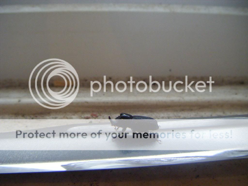

Wow there are some pretty edges in here. Actually just this morning I ran across an old (crappy) pic I took of a relatively cheap knife, Schrade schf14. Done on an Edge Pro, then freehand stropped....for hours. :eek: I need to take some better pics of current knives.

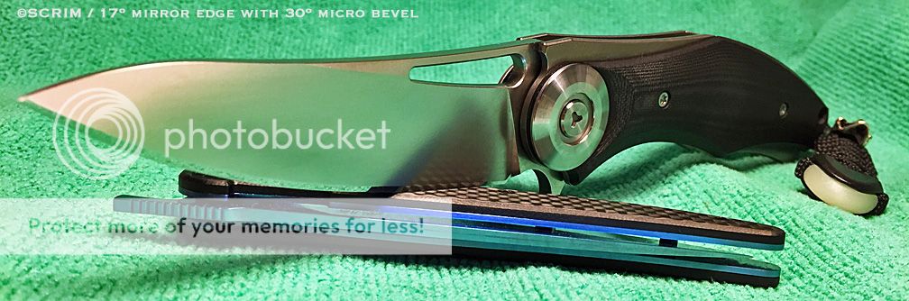

Here's one that I put a jeweled edge on. Unfortunately another bad pic, you can only see the edge where my micro keychain light hit. But it gives you an idea of how the edge looks. In actual daylight, my edges that are done like this sparkle like a blade length diamond. :D I've been doing this edge on most of my carry knives lately. They are really fun to show off because they're just a little different than what people expect to see, and still shaving sharp edge. In fact, because they sparkle like crazy, most non-knife people end up mishandling and draw blood, because they don't expect a piece of jewelry to be that sharp. :cool:

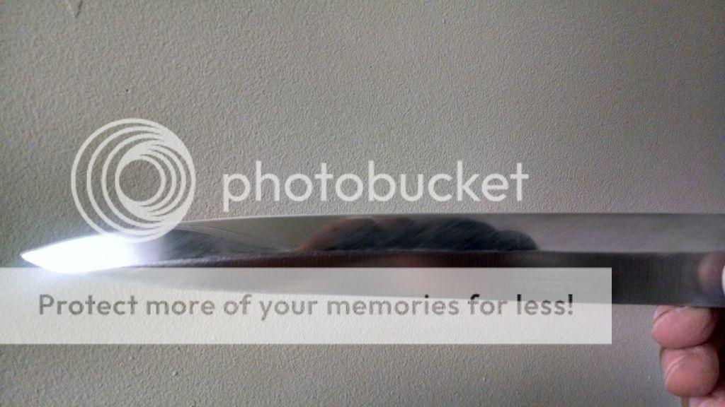

Another high polish on a Boker Nano.

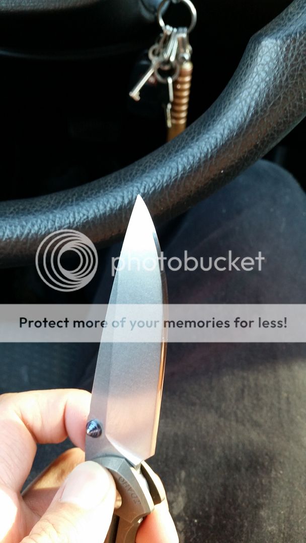

A Jeweled ZT450.

Very nice, what edge angles are you using?

I would say that I shoot for around 20deg as a common average, but that is never how it lands. The index marks on my sharpeners will vary in actual accuracy depending on the knife, thickness, length, where it sits in clamp, etc. Most of the time I'm simply using the ole sharpie trick to come as close to original angle as possible. Then adjust from there if I'm trying change the bevel for a reason. But usually if I attack an edge before its had some real use, it's just because I want to even out the bevel right/left, front/back. Or it's just one I want to show off and want my signature on, so to speak.
So long story longer, most end up between 17-23 degrees. I really should just slap on any of the dozen iPhone level apps I've downloaded. But I'm not sure it would make much of a difference as I'm usually just trying to remove as little metal as possible, and come as close to perfect as my novice skill set will allow. Every knife seems to be a new learning curve whether it's blade shape, thickness, steel type, etc.

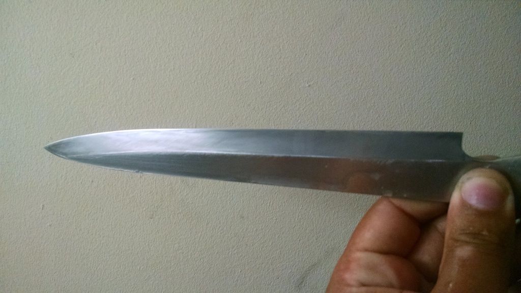

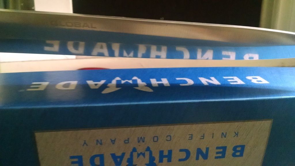

I typically don't mirror polish an edge but when I do, I use waterstones :D
^ Very nice guys!! Japanese polishing of those primary bevels is way beyond me... keep up the great work and thanks for sharing the pics!
