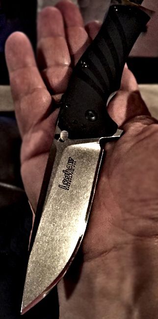

CRK Insingo at 15 dps, passing HHT-3 to 4

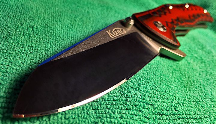

Thx again, Josh. And again your work is beautiful. It's a Kizer 405. And just fyi...the blade isn't black, it's just the angle and the lighting. It's a really solid knife, a frequent heavier user of mine...."abuse-able". Very smooth flipper on washers. I decided it would look (and perform) a lot better with a mirror polished, super sharp edge. What knife doesn't?! :)

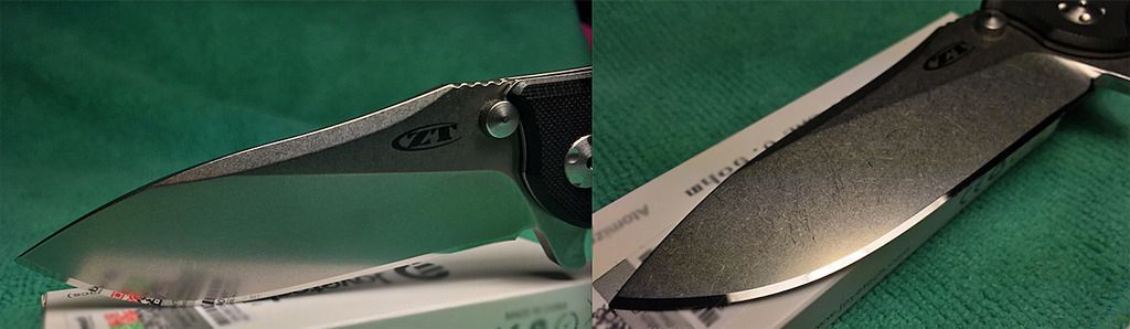

Here's a couple of new pics from me, one of my HAP 40 Endura and one of my ZDP-189 Caly 3.5:

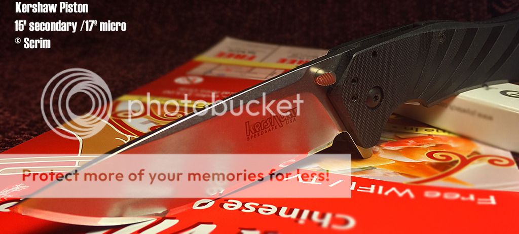

Josh, tried your tip. Hairline micro. You're right...:thumbup: Thx.
high contrast at just the right angle - to highlight the micro...(pixels do funny things when pushed)
^ Very nice dude! I like doing a micro because that way you are guaranteed to hit the apex w/ the finest grit!

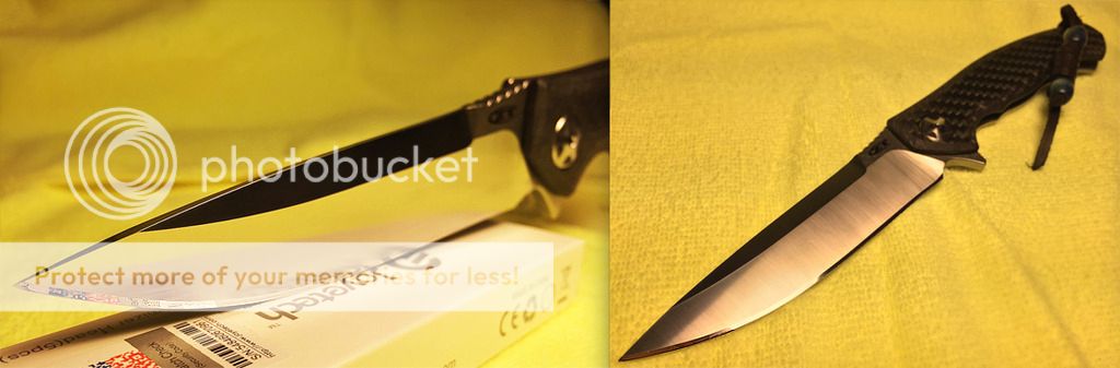

Just finished this up at 15 dps
16%2B-%2B1

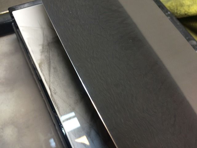

Just did this on an edge pro clone with edge pro stones. No worries, just ordered a real edge pro, the clone's wiggle and cracking parts were pissing me off [emoji12]
Chinese clever, acid etched and polished to 16k with Shapton Glass stones.
