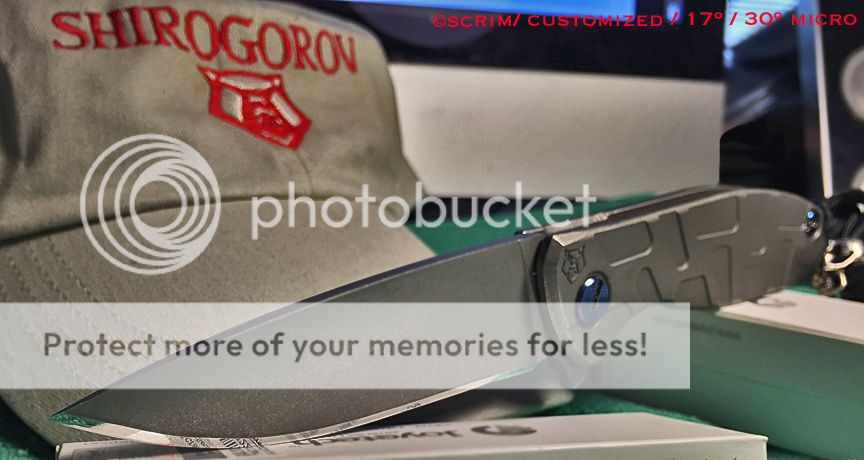

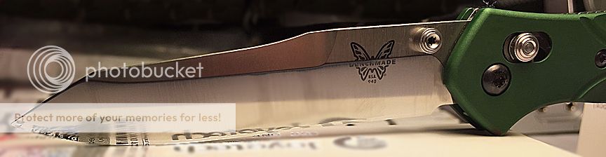

Beautiful work again, Josh. - When you do a mirror edge, do you automatically add a microbevel? Or do you see it as an additional option? I find myself always doing it now primarily because I've read so many times that it further stabilizes an apex by helping to prevent chipping. I haven't decided if it's overkill or genuinely necessary...because I've been able to achieve "scary sharp" both ways.
Keep in mind; a knife edge can be @ a high degree of polish and still not be sharp. The apex does not reflect an image and in the end, its the condition of the apex that matters.
Fred
You do some mighty fine work yourself my friend ;) Most of the time I will increase the angle by 1 dps and microbevel extremely lightly just to be sure I'm hitting the apex w/ my finest stone but other than that - on mirrored edges - I don't. I will, soon, be beginning to push my edges down to 8-10 dps w/ microbevels and see how they hold up to semi-hard use. Should be fun =)
Fred
Very true Fred, the apex is what matters most. Over stropping can kill it as well as round it so much it's ineffective. You can have a pretty bevel w/ zero performance which is not what we are after!
