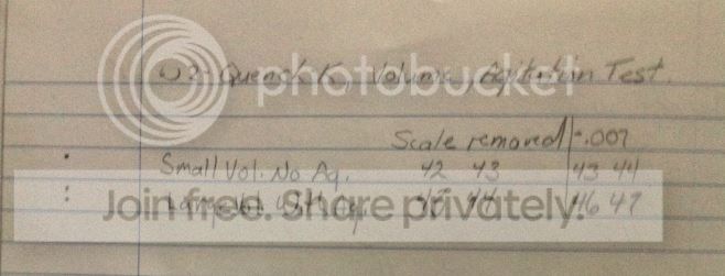

Why are the indentations so close to the edge and to each other? You should be at least two diameters apart from the edge and the last reading. That's not going to fix your problem but to have reliable data you should use proper test methods. You may want to find the ASTM guidelines for Rockwell testing to find other steps you want to fix.

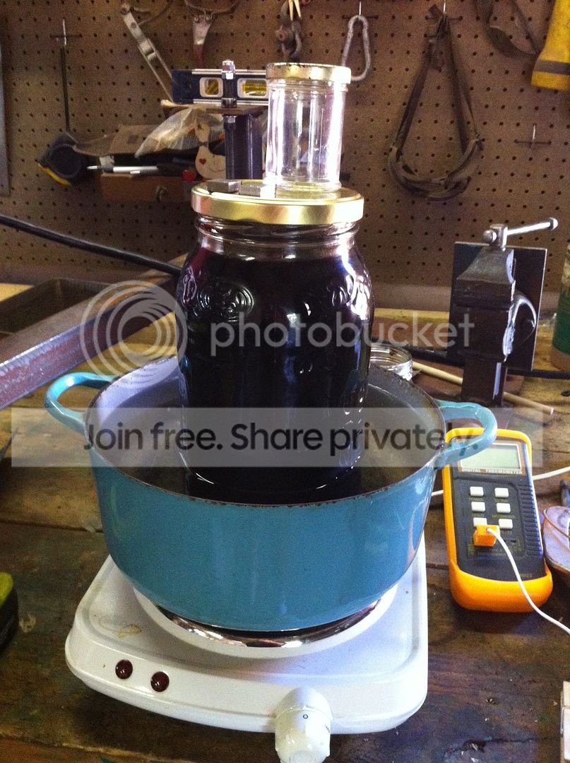

To finally put this quenchant volume and agitation controversy to bed once and for all I did a test. I took two pieces of W-2 quenched one in an 80 ounce jar of Houghto-Quench® K in which I did agitate and a second sample in a two ounce jar of the same quenchant without agitating. Even though I have done all my tests in 16 ounce jars I used a two ounce jar to drive home the point that volume really doesn’t matter enough to affect my tests.
I admit I was wrong I said I didn’t think there would be any difference or maybe a point or two but in fact there was a two or three point difference which considering the hardening didn’t even get to 50 is completely arbitrary.
If people can’t accept that Houghto-Quench® K can’t quench W-2 I can live with that because I feel the proof is indisputable and in my mind the case is closed but if people disagree that’s your right.

in fact it made two or three points difference and that was testing with just 2 ounces of quenchant
I'm not sure just 2 oz of quenchant is enough for it to do it's job, regardless of size of test coupon. The 16 oz is bordering on small size for a usable coupon, but 2 oz???
