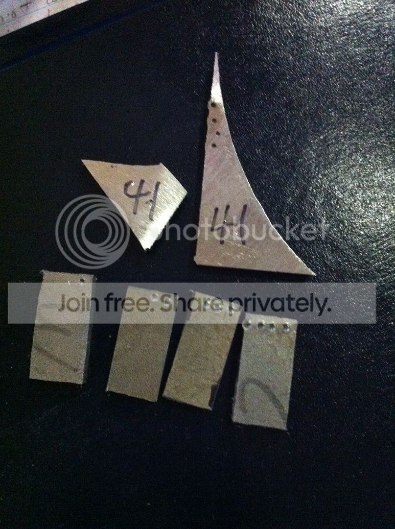

As promised today I tried to re-harden with Brine the pieces of W-2 which failed to harden with Houghto-Quench® K. I had two pieces that both had a hardness of 41 so since they were identical I normalized one piece to see if that would make a difference. I tried normalizing to see if that would increase my hardness.

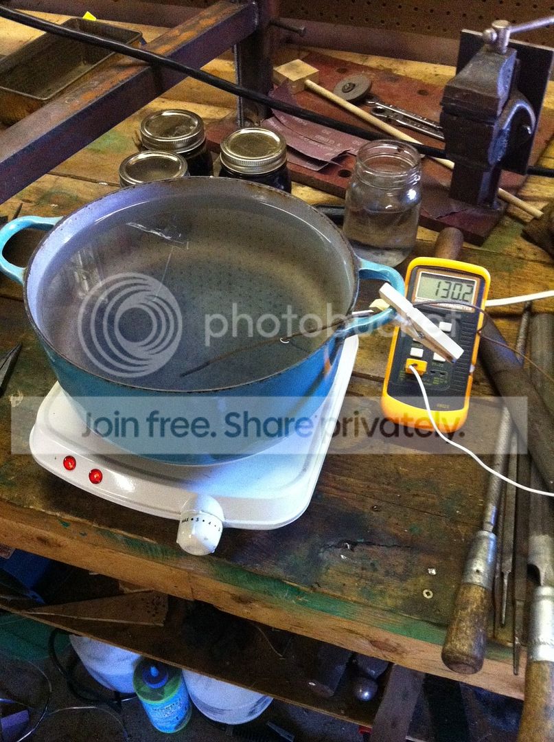

To quell the quench volume debate I used a gallon of brine at 130F.

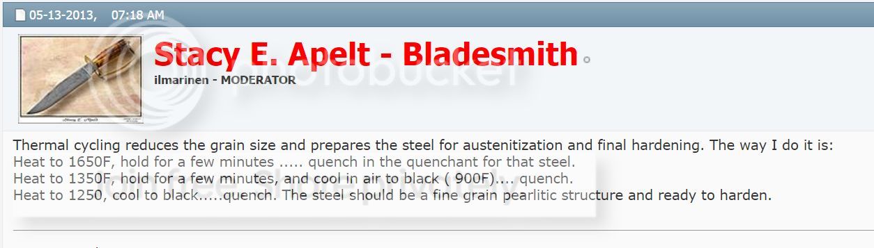

I used Stacy E. Apelt’s system shown here for normalizing:
Since I was heat treating anyways I decided to test four new pieces with normalizing and without and with agitation and without. My first piece I normalized, my second piece I normalized and agitated during quench, my third piece I just agitated and my fourth piece I neither agitated nor normalized.

Normalizing evens out the grain size and breaks up large carbides, if they are present, or if the steel is course spheroidized. If that isn't a problem, then normalizing won't affect hardening. Normalizing will correct for certain problems, but offers no benefit to hardenability on its own.
My W-2 is from Aldo and I was sure that I read somewhere that it comes course spheroidized and that is why I thought normalizing may increase my hardness.
