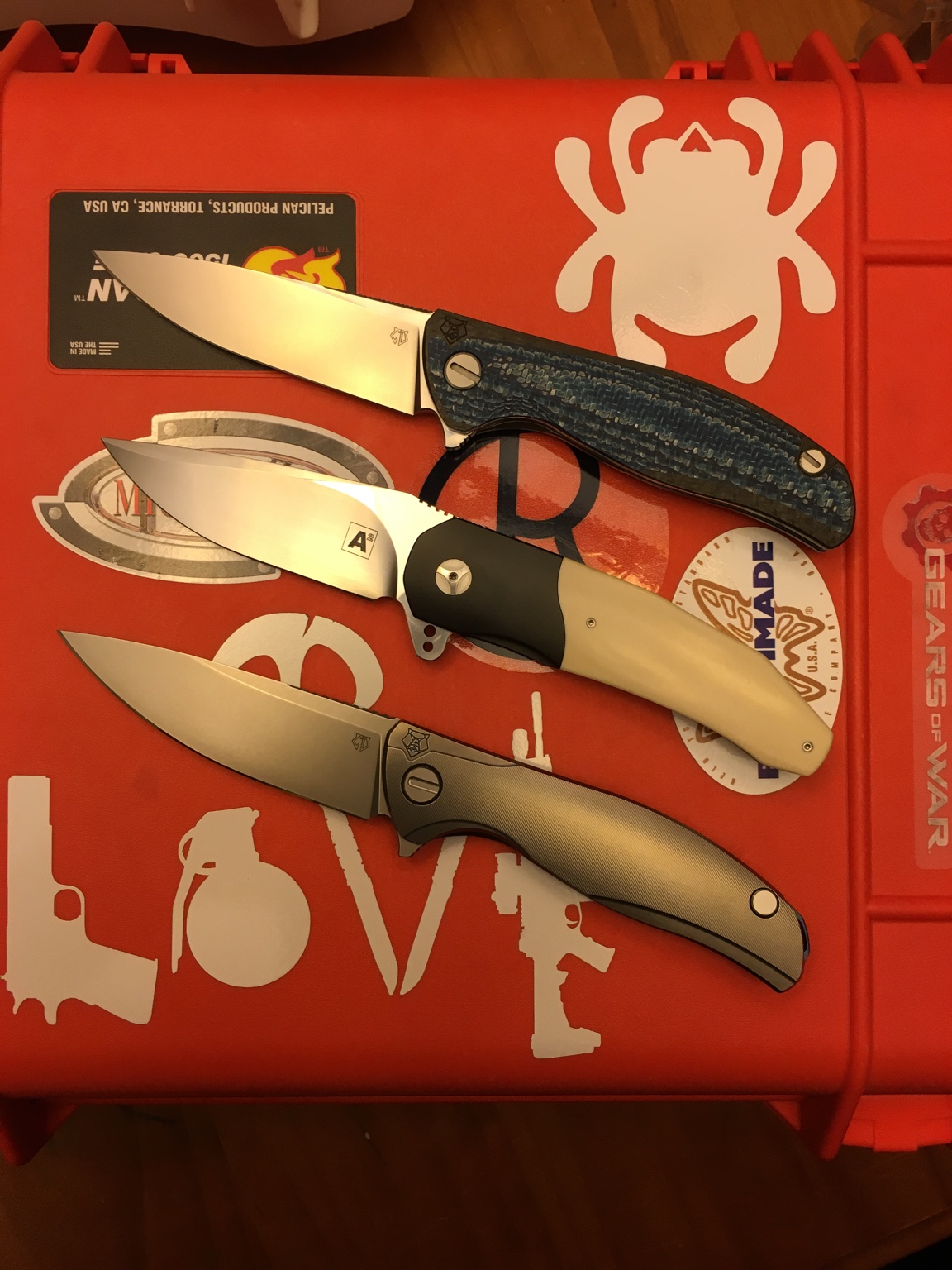

There was some discussion of mirror polished blades on another Shiro board, so I added this one and thought I'd show it off here. It is a pretty standard F3 in Carbon Fiber. But what makes it special is the mirror polished ZDP 189 blade.

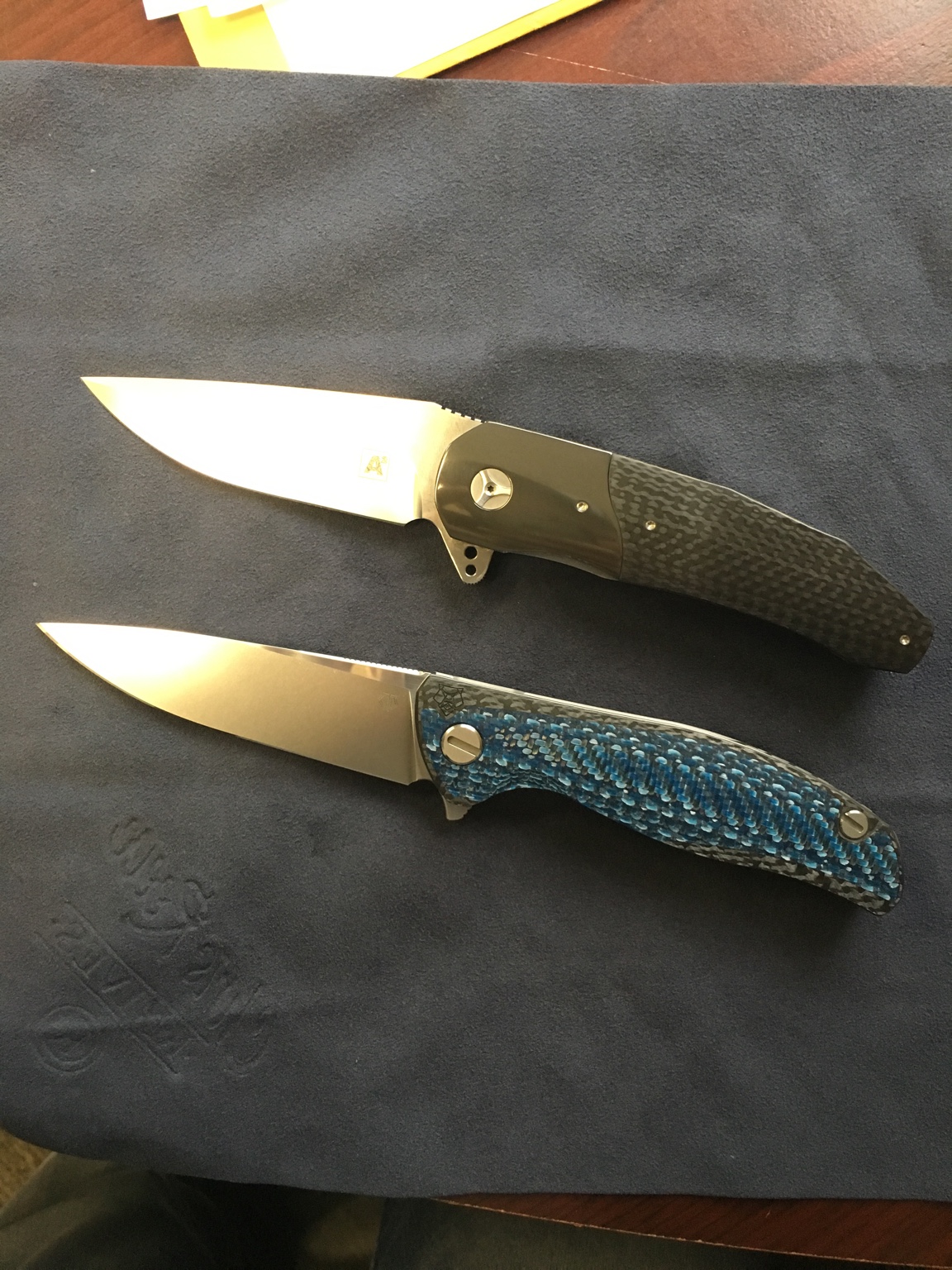

You asked, so I just shot these, CJW. I posted a couple a few pages back when I first got this baby, but these are a little sharper. All that clutter on the board is the schedule for the youth basketball league I run. That's where I've been for the last couple weeks--buried in this thing for 693 games, for 99 teams, from 18 clubs. Got about 1200 kids playing for us. Schedule's almost done, but is enough to make me wary of having sharp objects around for fear of opening a vein in desperation.
Anyway, I know what you mean about the backstrap, but I really love the open construction of the knife and wouldn't want to give that up. The lanyard's a little funny coming off the side like it does, but it's a small thing to live with for such an incredible knife. Only thing I've carried since I got it was my Sebenza 25 yesterday.
BTW, I cut a ton of cardboard with it a week or so ago and touched it up on the SharpMaker. The factory angle was just perfect for it and it's even sharper now than when I got it. Like a lazuh....
