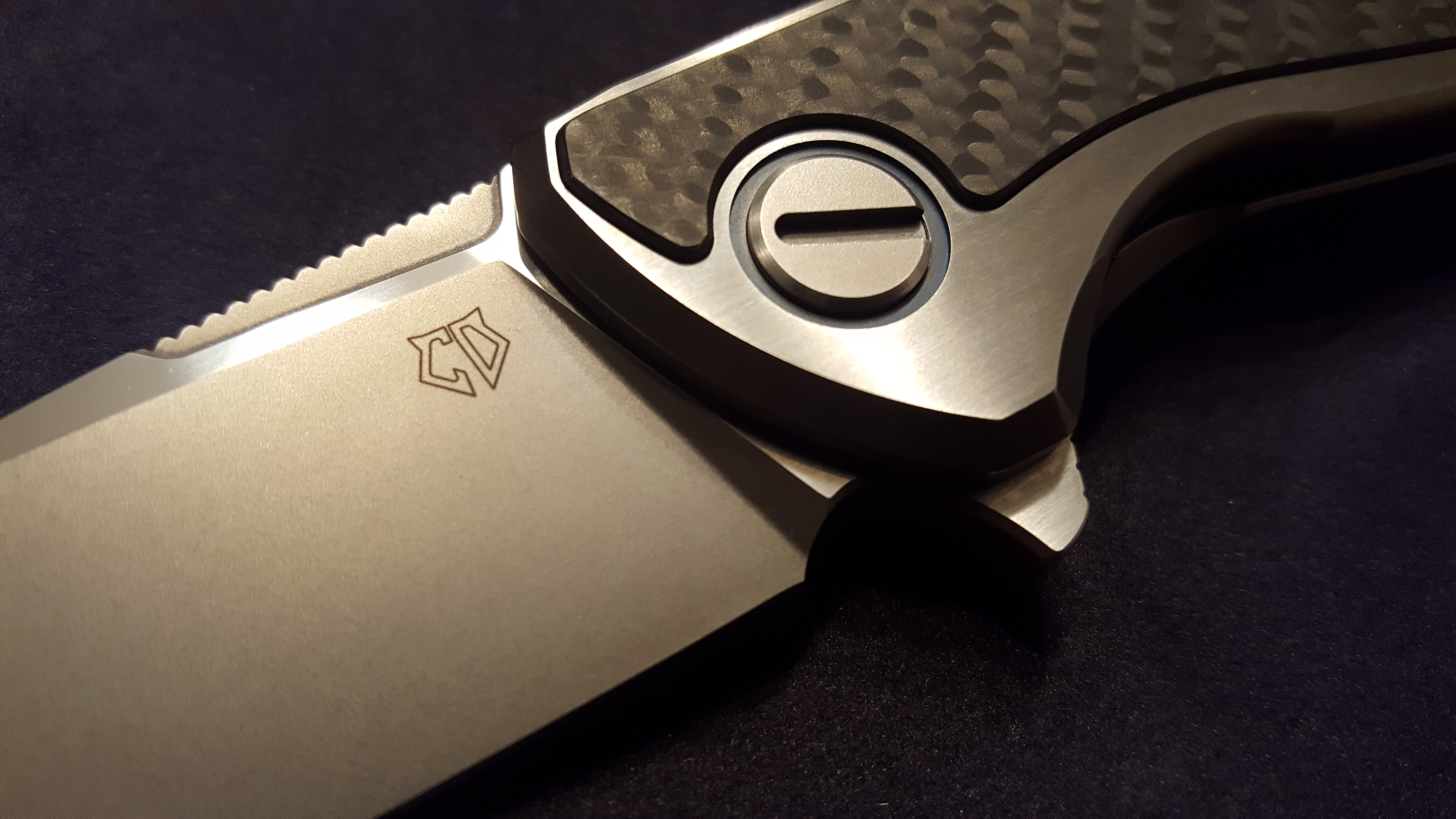

These two have appeared here in the Den before, but the light was nice today for what seems the first time this year, so I took a couple more pics 'cause I could. :cool:
Nice 95, a_d, and good post for sure. What vintage is that knife?
The only Shiro I've picked up that was wicked sharp when I got it is my Tabargan and I just stropped that one some.
Paper it came with said 2012. ... when I consider the tang shape, it's a transitional... like many earlier Shiros it has a round tang. Hence the pivot area is slightly smaller and has the characteristic slightly stiffer detent like those earlier knives too. I saw your Tarbargan and thought it look familiar ;) nice CF scales... almost got it for myself.

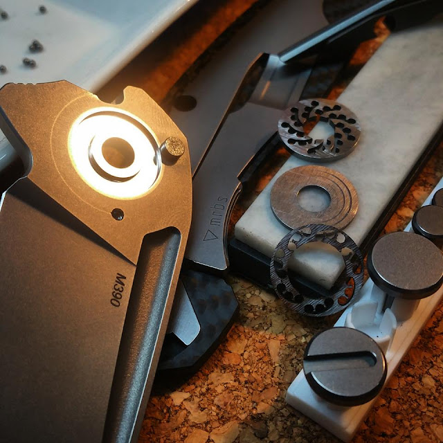

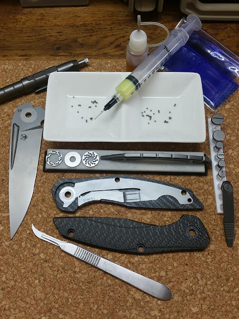

This Den is really feeling like a cozy corner to me now.. Ok see some "insides", I'll start... ;)

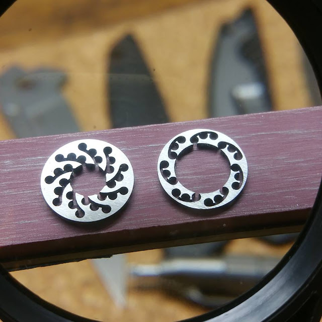

Haven't done much with my 111MRBS. Did a tune up back then but wasn't satisfied. Recently look under a digital scope and stropped it a little.. Edge wise I am happy with the way it cuts and not gonna touch it too much. But last night I finally stripped it down again and worked on it. Just finished up an hr ago tuning to the way I want. Gotta say getting that 4" blade to drop slow like the rest of my Shiro this time took a lot more than usual for this one.
Clean up everything and started on polishing up the race track...
...almost there. Checking against some lighting
Clean, deburr and polishing on bearing cages...
Debated with myself on doing more on the lock side track and detent track after repacking the bearings.
Left those alone in the end for now.. Another round to tinker if still not satisfied after today.

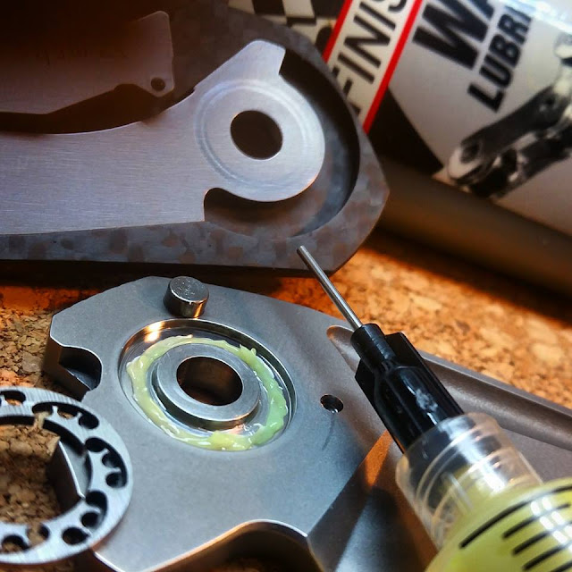

While lubing up with my "secret formula" :) :) . The internal stop pin and track caught my attention this time... Pulled a "new" lube trick out of the bag and hoping things will go as anticipated. Chain wax rather than messy grease and oil on carbon fiber with the stop pin.. smooth the x-section of stop pin as well...
Ok... all in not too bad.. Will leave it alone for now...

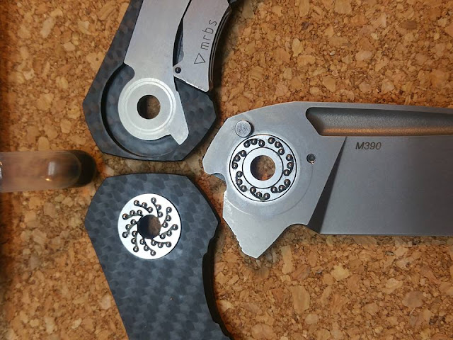

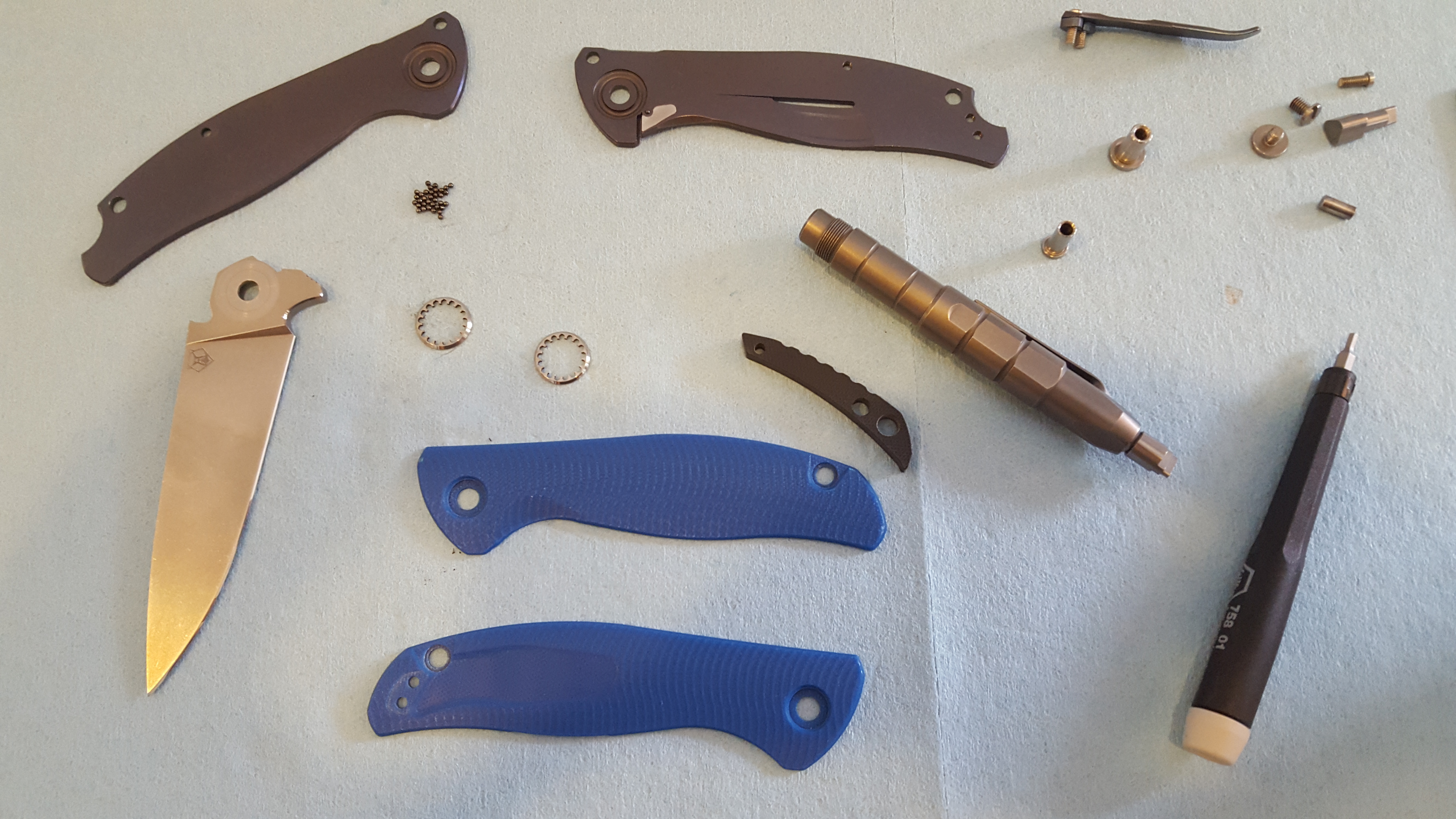

Thank you for posting those photos, commentary, and video. I enjoy coming across this kind of material. The other day I had my F3 apart for a tuneup. I stopped when i had it fully apart and took a photo. Not sure why I did, but it looks like a relevant place to share it.
And since it's the bears den, there should be at least 1 more photo.
Curious what ur secret lube is

Thin-Slice .. no secret actually but I mix it up accordingly when needed. Used to prep tune race bikes so specific greasing and lubing was somewhat of a "hobby" in itself for me.. I start with a base of that DuraAce Shimano luminous green bearing grease. The white bottle probably is a lithium based suspension which you can substitute with something else if you can't find.
Some knives I want a slower action and the concoction would be more viscous... so less of the micro zx1/ Eezox

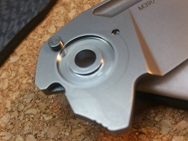

Hey anvil_den--Here's a pic of the lock-up on my F3 Python. You can see how early it is. I can't move it further either forcibly or by flipping it extra hard. As early as it is it locks up really solidly, but I am not a big fan of this early lock-up mania and would rather it was substantially later. When I first got the knife it released almost effortlessly but after a few months of openings, it now makes quite the loud "crick" and takes a bit of force to release. My 111 and F95T release completely effortlessly and silently.
I'm half-tempted to take a diamond stone to the lock-bar but am leery of screwing it up. At this point I'm hoping that another thousand or so releases will wear it in further and the problem will go away.

I saw your post awhile back. It sounded like a mystery why the lock stick started out of the blue.
I don't think I can add anything past what advise Anvil offered. I'm just not sure it's a good idea to touch the lock face with any stones. Did the lock-stick change any after to put it back together again? I know you said it was still there, just wanted to know if it changed any. If it were me, I'd try taking it apart again before doing anything permanent.
The picture of your lock up isn't too bad. I've seen a shiro lock so early, you couldn't tell if touching the lock face.

The sticking issue did not change at all after re-assembly. Looking at the lock-ramp again, I can see a clear demarcation where the lock-bar insert hits the ramp. I'm surprised to get stick as it's steel-on-steel. My Python is S30V and perhaps the insert is harder and is digging in a bit.
I think what I'll do is dis-assemble again, polish both surfaces, and de-burr where I can. I'll let y'all know how that works out.
