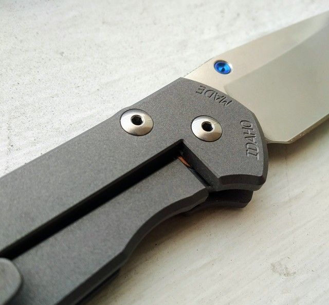

My first Insingo and first with Micarta inlays, bought as a user to be a user. Fell in love with both the blade shape and the inlays.

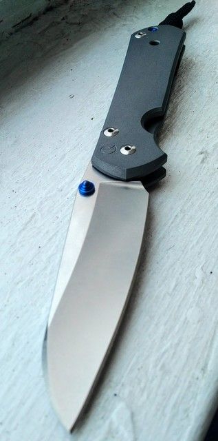

Just got this small as a user off the forum here last week. Into the rotation it goes. Has some great pocket-wear patinia, some shine on the edges which I think make it look great. And the stop pin has the grooves in it. Kinda like that.
