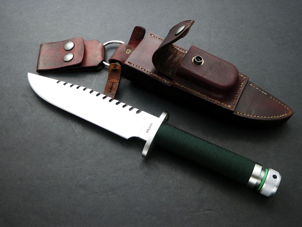

I just got my Wall Jimmy Lile style knife:
The first impressions were excellent, yet really peculiar: From pictures you would assume the handle is very long. It isn't: Barely 1/2" longer than the normal-looking handle of a Model 18...: The reason it looks so long is that this handle is so thin...: The difference in handle diameter with a Model 18 is again deceptively small: Around 1/16", but such a small difference in diameter has a huge effect on the circumference: The Wall has the thinnest hollow handle diameter I have ever held, and I have to say it offers the best grip of all the cord-wrapped versions despite my large hands: This is accentuated by the quality of the cord, which is even better than than the very thin stuff on the Vaugh Neeley SA9: The SA9 feels nice but verges on the slippery: The Wall cord is really outstanding stuff, and noticeably grippier...
The diameter difference with the Model 18 is accentuated by the 18 encouraging you to wrap 440 cord (I use 330) because of the hugely oversized buttcap, which just makes the 18's handle too big, if quite manageable...
On the Wall, not just the buttcap is aluminium, but so is the entire handle, and this weight effect, combined with the small handle diameter and the resonably thin tube walls (made even thinner to counter-sink the cord), has an effect on the knife's balance that litterally defies belief...: The balance point is a full inch in front of the guard, even with survival gear in the handle... The rubber-handled CS Trailmaster, with 9.5" and 5/16" stock, only manages 3/4", and even that was commendable... Two other design factors help this achievement: The Wall blade is not fully distal tapered due to the sawback portion (it even has a slight saber grind just below the saw), and, perhaps more importantly, the very shallow ricasso robs large amounts of dead mass nearer the handle, which also has a positive weight-forward effect (something the Chris Reeves Jereboam could have used to advantage, but didn't)...
Of all the 8-10" hollow handle knives I know of, this balance achievement must be absolutely unique: The First Bloods/Missions must be quite heavily rear balanced in comparison, because of their extra-thin points. Virtually all other such hollow handled knives don't have much blade-heavy balance, most often just because their handles are so heavy... My 9.5" Timberline SA9 stunned me with its neutral guard balance, this occurring because of its steel handle and non-hollowed mirror buttcap, made of a huge chunk of solid steel... Greg Wall's interpretation of how "petite" and lightweight a hollow handle can be is a true revelation: It handles beautifully, and is more compact and lighter than even regular non-hollow handles... It almost feels a bit effeminate...
On the downside: Capacity suffers of course, and is on par or less than the dreaded Chris Reeves compartment... The compartment is also only around half the length of the handle, barely over 2" deep, so I had to trim my Neeley-supplied ferro rod 1/8" to ensure the buttcap would close... The seal for the buttcap is a sub-par flat rubber piece, so it doesn't work at all, but, surprisingly enough, the machining tolerances are so tight that the buttcap is likely fully waterproof just metal to metal... My matches are plastic sealed anyway...
Some grinding tool marks are visible on the brass guard, but are well washed-out by polishing, and so they don't bother me... The blade finish is good and most of all symmetrical. The O-1 shows no real tendency to stain compared to Randall's (I think the higher polish may help), but being wary I didn't really try to test it...
From the blade surface finish point of view, the Wall cannot compare to the flawlessness of the Neeley SA9, but it is better than what is usually seen on Randalls. It does beat the Neeley in one surprising aspect, that is tough for any maker to get right: Even the best from Seki Japan, working on Al Mar knives, flub this badly for instance....: As the blade starts its taper, ahead of the full width double wood teeths, the symmetry of the point taper on mine is absolutely perfect: Even the inhumanly precise Neeley hesitates just a tiny bit on the symmetry of the "swelled" clip taper... What's more, the Wall's taper is not nearly "flat", as what I observed on "First Bloods" or "Missions" by Neeley or Lile, which makes the points needle-like and way too fragile, but the taper is "swelled" which results in a very strong point (further enhanced by a slightly excessive "rounded" point on mine).
The sheath finish is kind of matte-looking, but a good surprise in quality, and better finished and stitched in my view than those of Savage. And the snap is strong and way, way better than the weak nearly useless snaps Randalls and Savage will give you (you can squeeze the steel Randall snaps for more strenght, but it is dicey)... Also the broad snap strap is tight and not wrinkling at all under use, which is way better than the typical Randall strap again... I for one applaud the lack of stone pouch, as it just solves a lot of my inside the pants carry problems...: I can understand for open carriers how this is a negative...
Now for two things that don't work for me: The convex edge is as thin as a Randall V-edge, which is great, but on this Wall knife it was butter dull, and took me 3 solid hours on a coarse diamond hone to bring back to a useable V-edge... I don't hate convex edges, when sharp, but I just don't get convex edges, and probably never will... This thin edge makes this knife absolutely superior in practical terms to my Neeley SA9... I did get an amazing edge on my SA9, after multiple sessions over 3 months, but it will be a great edge once. That is, until it needs serious re-sharpening...
Which leads me to the one thing where the SA9 definitely wins on the "engineering" side over the Wall knife...: The saw on the Wall is equivalent to what Lile did on the First Bloods, and I can just tell by looking at it that it would be barely half as effective as the Neeley's intricate high-tech design (which is probably the best sawback ever, barring a comparison to the Parrish or Martin designs)...: Part of that difference is that the corners are not as crisply ground, but there are also things inherent to the Lile design that Neeley simply did better... Also the clip's "barbs" are sharp on the Wall (Liles have small flat tops, Martin big ones), but I don't think they are of any real use, even on small prey... I usually frown on non-functional features...
I also like for a knife to be made with inhuman precision, so the SA9 will remain my sentimental favourite (since I had been dreaming of the shorter 7.5" SA for 30 plus years...). But as a knife, the Wall is definitely the better knife over the long term, simply because of its edge thinness, and more efficient blade-heavy balance. It is a superior interpretation of the Lile design, with a far stronger point and a better balance for chopping.
Gaston

I have just tested the sawbacks on 3 of my knives on a 3" branch: Randall Model 18, TOPS Hawke Hellion, and my new Wall... I was prompted to do this when I noticed the Wall sawback had only a single flat surface for the top of its saw, so that the individual teeths were not raised at the back individually, which raised big warning flag in my mind... Uh oh...
On a 3" diameter maple branch, the Randall saw is good up to only 1/8", but quite aggressive in getting there. Unfortunately, it produces dust so fine it instantly blows away in the wind: It is therefore totally useless even for wood dust making, because the wood dust is typically way too fine to be gathered in any quantity... Avoid this feature on a Randall.
On the same branch, the TOPS Hellion saw exhibited very good performance up to a depth of slightly over 1/2": Four times the Randall... The wood "dust" is much heavier and doesn't blow away in the wind, making it very useable for firemaking... This performance allowed going all the way around the branch, creating a weak spot down to 2" in diameter, and then breaking it with little effort: So up to 3" harvesting in a few seconds, with no noise, no edge wear and little effort: This saw design in my opinion fully justifies its existence, even though it probably is well below the Neeley sawback in performance...
If the Hellion was to be used defensively, I imagine it would be used more in a hacking motion, where its sawback would present no problem...
The Wall Lile-style sawback... Oh my God...: Entirely because of the lack of "rear rise" to each tooth (be assured all the Lile knives have this rise), it cannot even strip the thin bark off the branch... Strangely enough, it does tear quite a bit at the sheath's edge, and slows down a draw considerably, which my Neeley SA9 sawback doesn't do...
Total absolute crap: This will be a beat user for sure... Try very hard to get this knife without the sawback (I might contact him to ask), as this is worst than just a marginal feature: It is truly unacceptable.

Just saw a Wall knife on a rather famous auction site for a buy-it-now price of $299.95. Nice deal for a nice knife. The interesting difference between my Wall and the one up for auction is the handle is threaded on the outside rather than the inside on the auction one. Would give it a bit more space inside the handle.

Sam, I pointed out I was very happy with the rest of the knife, and his workmanship. I even called it a "superior interpretation of the Lile design"... But he didn't raise the rear of each sawtooth, and as a knifemaker of sawback knives he should have known better... The entire sawback feature is completely useless: It is not nice to have large features on a knife that turn out to be purely decorative, when they are obviously presented as a working feature: It is not that the saw works poorly, it does not work at all, yet each teeth is split in the middle, suggesting this is not a decorative feature...
Mind you, I should have looked closer at the pictures, and I could then have seen for myself that they don't rise much, but you have to have the knife in your hand to really see that the teeth tops are all on the exact same same plane, which completely destroys their usefulness... I just assumed that the feature was intended to be functional... The knife is not presented as a decorative piece, and is otherwise very functional.
Get a no teeth version and I won't quibble with the knife's quality... And I don't owe Greg Wall an easy review, since he did get my money... I don't feel robbed anyway, if that makes you feel better: The knife is dead straight and symmetrical, and that is a lot better than the Randall Model 18 I got...
