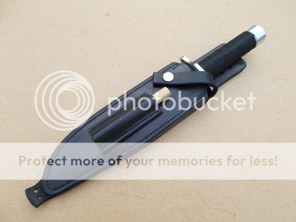

THE Hollow Handle Knife Thread
For a pure fighter, I would put in the following proposition: You want the longest blade, with the straightest edge, for the least weight to carry, and one of the most overlooked advantages of daggers, in my experience, is that there is no lighter blade design, no grind that removes more weight in the blade, than the dagger:
Do you have much experience in knife fighting?
I have more than I would like, and I am certain that my choices and preferences do not match yours.
A belly-less, or shallow belly edge, is very important too, because defending is maximum extended arm reach mostly (offensive stabbing is much shorter range than tip slicing, since you have to extend the arm to drive the tip: Elbow reach at best...), and bellied edges push flesh, they don't grab it, so a straight edge is also a better tip slicer, since it is mid-way to a hook in shape... Not well understood is that many daggers are thus much better tip slicers, from perpendicular to skin, than skinners, for that reason...
Again, I'm not sure of your background, but my experience does not match these observations. Not to mention many generations of skilled kukri and filipino knife fighters, who do pretty well with a curved blade.
Total absolute crap: This will be a beat user for sure
Let me know if you would like to sell it.

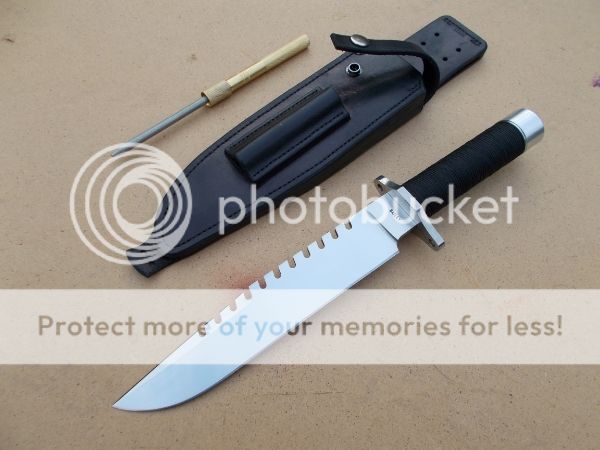

On a 3" diameter maple branch, the Randall saw is good up to only 1/8", but quite aggressive in getting there. Unfortunately, it produces dust so fine it instantly blows away in the wind: It is therefore totally useless even for wood dust making, because the wood dust is typically way too fine to be gathered in any quantity... Avoid this feature on a Randall.
The Randall saw is NOT designed for wood! Why test or compare it? :confused:

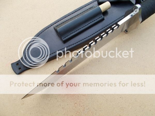

The Wall Lile-style sawback... Oh my God...: Entirely because of the lack of "rear rise" to each tooth (be assured all the Lile knives have this rise), it cannot even strip the thin bark off the branch...Total absolute crap: This will be a beat user for sure... Try very hard to get this knife without the sawback (I might contact him to ask), as this is worst than just a marginal feature: It is truly unacceptable.
he didn't raise the rear of each sawtooth, and as a knifemaker of sawback knives he should have known better... The entire sawback feature is completely useless: It is not nice to have large features on a knife that turn out to be purely decorative, when they are obviously presented as a working feature: It is not that the saw works poorly, it does not work at all...
Yet, the Wall is a "superior interpretation of the Lile design". :rolleyes:

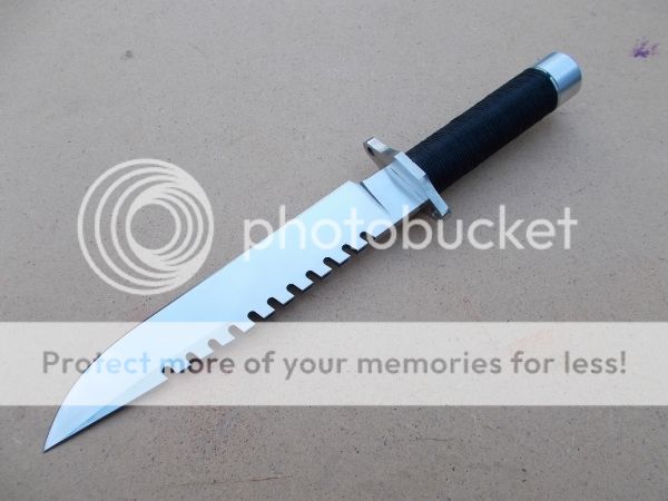

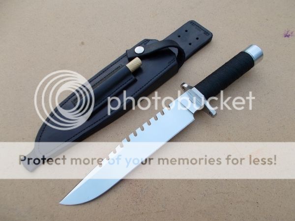

My own mismatch of Lile's First Blood and Mission knives.
Here's where it doesn't fit though. This knife has a full, narrow tang with a solid Tufnol handle!
Hope you like it.
Great thread by the way...as a long time admirer of the Lile knives since I was about 10 years old, I've been looking at this for a long while.
Great stuff.
Thanks for looking.
Ian.
Ian, I think it looks great. You did an excellent job on the sawteeth, and I agree with Dave, the guard is a really nice size. Also, excellent job on the grind on the clip. That isn't easy to do, and you did quite nice on the leather, as well. Great blend of the two knives. If you've got more, please post them up.

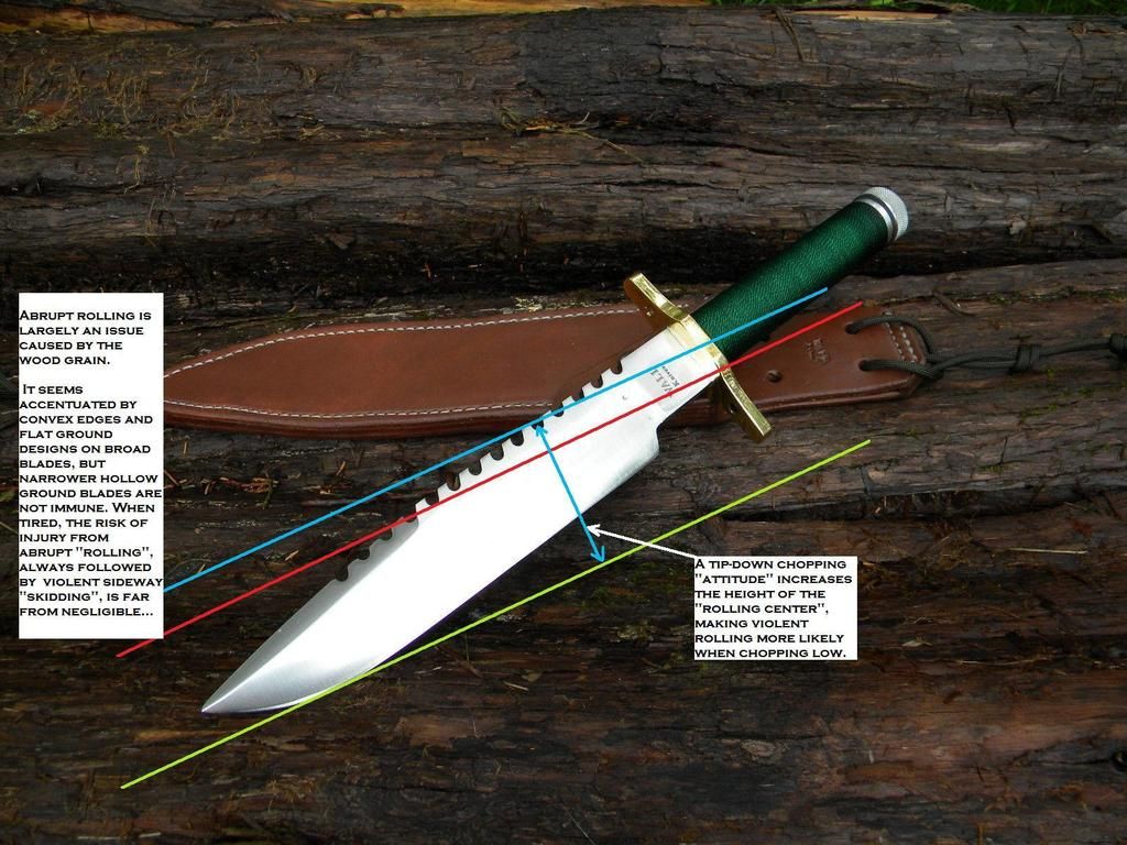

I have since tested this knife in the field, and generally it came out well against the Randall Model 18, although I noticed a lot of strange unexpected results and behaviour that are both specific to the design, but also apply to all hollow handle knives generally. Because I had chopped in a different way before, I never noticed these issues to the extent I did this time.
Unfortunately I still cannot load up the "in action" photos, as the "F" inlet still does not appear in my view box, for some reason. So I'll just try to be brief using generic photos... I will post pictures when the computer problem is finally fixed...
Chopping performance: 9" Wall, 1/4" stock, versus 7.4", 3/16" thick Randall Model 18 (with ground down guard, so lighter than stock): Incredibly, about the same(!!), despite the Model 18 balancing just behind the guard, which I consider very poor balance (versus 1" in front of the guard on the Wall, which I consider incredibly good chopping balance for a hollow handle, this due to the aluminium and small diameter). This is quite a surprise to me, especially since the knives are similar in edge thickness, and the Randall is much thinner in stock than the Wall...
My theory is as follows: The Wall originally sported a fairly broadly radiused convex edge (though similarly thin to the Randall overall): By converting it to a V-edge, I could not go all the way up the side to elliminate completely the radius of the convexing (this would have required scratching up the side into a huge 1/8" bevel, which would not only have looked bad, but would also have been enormously time-consuming, as it was on the Neeley SA9) , so that above the V-edge bevel the blade still immediately "thickens" in a convex curve: I much improved the original sharpness, but this "thickening" action just behind the edge is a sharp contrast to the slight hollow on the Randall's cross-section: The V-edges are both similar in thickness, but where the Wall swells rapidly fatter after the edge bevel, the Randall basically goes straight up into sides that do not widen at all... This alone expains the mismatched smaller blade equalled the much larger blade: When chopping, I could "feel" the remaining convexing inhibited the Wall's "bite". It still performed decently, though I would guess the heavier-feeling Chris Reeves Jereboam would out-chop it by about 20-30% (it is being refinished in a green Cerakoating, so I didn't have it available).

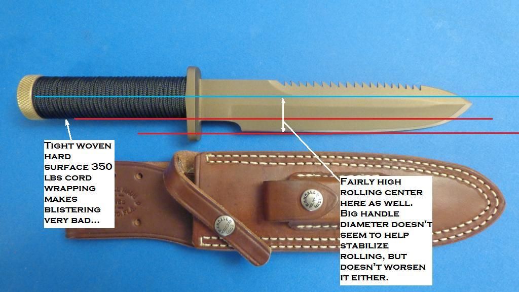

Despite this surprising result, the Randall came out very badly in handle confort: I had used for wrapping a very tough-surfaced, tightly woven 350 lbs rope (harder-surfaced than regular 440), and this still made the handle too large in diameter, but it also was way too aggressive for chopping: The issue is not easily fixable in my opinion, because chopping makes you want to grip rearward, and the blister may have been caused by the oversized buttcap knurling itself, not just the rope... The Wall's very thin diameter handle was superbly confortable in comparison. The only downside of its excellent handle is the wrapping cord moved around a little, revealing a slight gap in the rope: No real adverse effect...

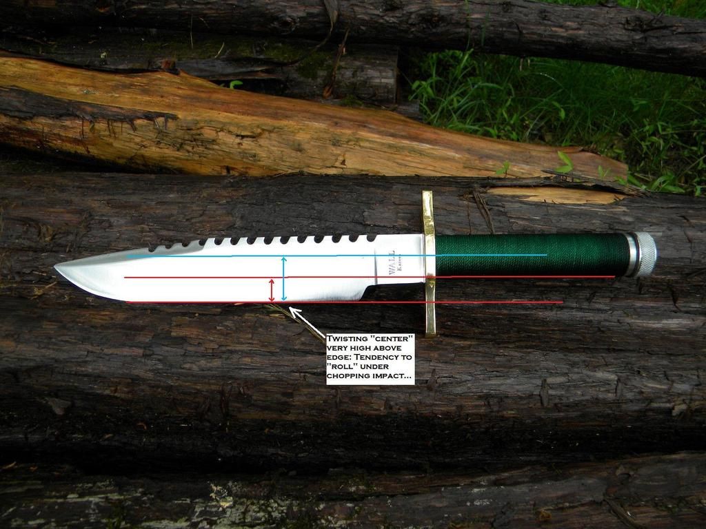

The most interesting thing I found in both knives is the serious tendency to roll "into" the wood grain when chopping low to the ground. It was slightly worse on the Wall than on the Randall, despite the much better grip, but very bad on both compared to the Chris Reeves. The convexing of the Wall edge may have played a role, but what was interesting to me was that it was so much more severe and less controllable than when doing shoulder-height chopping with the Chris Reeves Jereboam. This below illustrates what I think was the two-pronged difference: 1-The handle-edge relationship, 2-Chopping with the blade in a tip-down attitude:

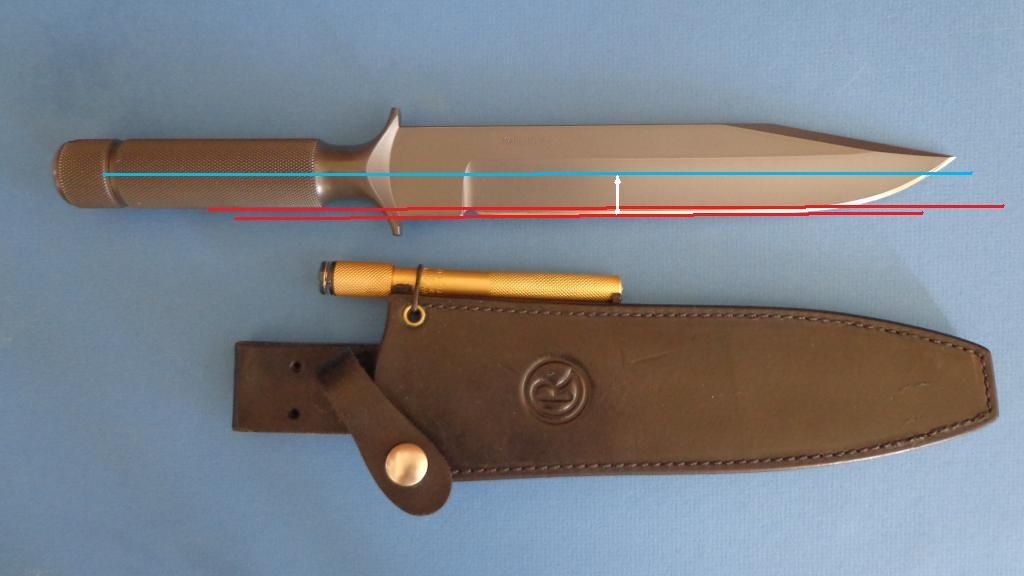

Now compare the above edge-handle/handle center relationship to that of the Randall below: The greater height means the Randall is more "tipsy" at the moment its blade hits the wood to chop, which means the slightest off-square centering will have a greater chance of leaning the blade and suddenly making it "follow the grain" paralell to the wood grain, rather than cutting perpendicular to it:
Now here you can see how the Wall's edge-down design might also have caused trouble:
But the rolling effect was so marked and dangerous this time (it litterally whipped both blades sideways with great violence, very near my leg and foot) compared to the comparatively mild effect on the Chris Reeves Jereboam (still a bit scary the first time around), that I felt sure such design differences could not have been the whole story: Another difference with my older testing was that the Chris Reeves was used to trim limbs at shoulder height, which made the blade hit point up, while this time I tested the Wall and Randall on limbs resting close to the ground, in a point-down attitude: I think this might have had this effect:
In any case I think it definitely is an issue worth keeping an eye out for...
And yes I am keeping the Wall...: Who knows, if he fixes the teeths, then mine will become a collector's item...
As to determine if it is still an improvement over the Lile design, the weight-forward balance is definitely better, and the thinner diameter handle is also superior in my view, even for big hands. The lower edge position on the Wall does prove to not combine very well with a round handle... The Liles however have another problem which the Wall avoids completely: Way too thin point geometry that is just far beyond what it should have been: When I found this out, I lost forever my interest in the Liles. Do note however that the Andy Wood copies appear to have a noticeably sturdier point design: This is a pre-dot Lile Mission, but I have confirmed that current Neeley production First Bloods are similar in point thinness:

Thanks for your comments. :thumbup:
The steel is 01. Not the ideal choice for this sort of blade admittedly, but it's what I normally use.
I made this for myself for my own amusement, so it doesn't matter. I've had my fun with it.
Sam, this is my first attempt at a Lile style, but there's a few of my others here if you're interested.....http://http://s524.photobucket.com/user/irbailey/library/?sort=3&page=1
Cheers,
Ian.
