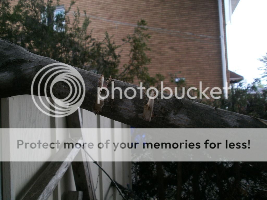

Over the week-end I did another test, this time to get an "initial" feel of how a well-designed convex edged knife will perform when compared to thin edged/deeply hollow ground knives: I purchased the San-Mai III Trailmaster precisely for this purpose... I used to own a Fallkniven Odin and, if anything, the Trailmaster is actually equally if not more finely made (edge grind geometry included), but with a cheaper-feeling sheath and handle materials...: The thin nylon sheath does not scratch the blade at all, which is a big surprise, as the Odin was a nightmare beyond all description on this point... It feels adequate to its purpose in my opinion... Not a bad deal.
This was the result of a brief test of about 17-20 chops (the number being adjusted when I felt I did some poor blows, to try to even things out objectively: This was in favour of the Trailmaster and Model 18, just so you know):
The Randall is around 12 ounces, 7.4" blade, balance 1/4" behind guard, the Al Mar Special Warfare is about 10-11 ounces, 7.75" blade, on-guard balance point, the Trailmaster is around 17 ounces, 9.5" blade, balance point 3/4" in front of guard...
Edge thinness is not spectacular on the Trailmaster, but hard to measure: 1 mm at 2.5/3 mm from the edge, peaking at around 1.3-1.4 mm later on... As usual on convex edges, the final edge angle is quite open if you sharpen on a flat hone, at or even over 20°, and the price in performance is there to show it (my Fallkniven Odin's edge was the same or worse)... The Randall is 0.65 mm at the shoulder, and the Al Mar is 0.5 mm, the sharpest of the 3, and with by far the deepest hollow grind, from a full 1/4" stock(!). The Randall is 3/16", the Trailmaster 5/16", all the way to the start of the clip.
The Al Mar had the advantage of the longest handle, which was used in a full rear hold: Its chopping performance was incredible for its weight: The bites were astoundingly deep and effortless, owing almost entirely to the hollow grind I felt, not the longer handle: It easily matched the much heavier Trailmaster blow for blow, even though I tried to put a lot of extra wallop behind the bigger knife... You could just feel the convex edge "blunting" your effort...
The Model 18 was its usual "what am I doing here?" self: Despite this, its edge allowed deep bites, but for the first time I noticed the huge round hollow handle made accuracy more difficult compared to the other two knives: You can see that in the wider less efficient cutting pattern... The thick cord wrap is probably an additional hindrance here... The edge was perhaps not completely at a phonebook paper "straight" push-cutting level, so I re-sharpened it later on.
The Trailmaster handle felt strange, and the new moulded "pinhead" checkering is definitely very aggressive to a bare hand: It does feel much more secure than the Fallkniven Odin's slick nightmare (quite frankly, the Odin feels like an accident waiting to happen in comparison, and I can't even imagine what the Thor is like: Here on Bladeforums, one Thor owner recounted a self-inflicted wound, after loosing his grip, that would not be out of place in a Stephen King novel: Brrr!). The Trailmaster handle feels too thin, and over the long run it seems like that concentrated narrowness would be hurtful to a bare hand: It makes full power chops a bit worrysome: I used it too little to really say what it would be like in the long run, but I will find out...
The Al Mar's handle did not draw any attention to itself, which must be a good thing...
Anyway this is quite surprising to me. In general I would say the Bk-9 and Chris Reeves Jereboam were equal to each other, and slightly above these 3, but not by a huge amount. 10-20% maybe. As they say, stay tuned!

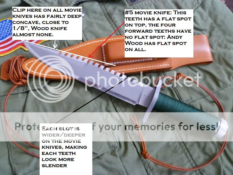

The white line I put in the image above is to show the fact that the real movie knife has a slightly concave clip: This is missing from my Farid and is almost missing from the Andy Wood version... The concave clip is an obvious difference that is immediately apparent when you see the video of the #5 movie knife... I actually prefer a fully straight clip.
On closer inspection I noticed a few errors in the Andy Wood version, a fairly prominent one being actually done more accurately on the Farid Prototype...: The wood teeth on the Andy Wood have noticeably smaller gaps between them, and this makes each teeth quite different. In fact in slightly changes the "character" of the whole knife, making it fairly easily distinguishable from much of the Lile production:
The teeths actually looks more refined and subtle to me when done the Andy Wood way, but it does mean that those hoping for an entirely accurate replica would notice right away the differences, if they were to see a movie knife "in the flesh"...
One "error" I really like on the Farid, which actually changes the character of the knife less than the above, is that its raker teeth are noticeably shallower. I'm really crossing my fingers that the re-ground tip he copied was stronger in geometry, and that he copied that tip's thickness as well (though I wonder if that means the blade is now shorter than 9": That would be strange)... Shallower raker teeth and a stronger tip would really fix a lot of my objections with the design... The deeper Farid belly is actually slightly more elegant than the needle-like tip of the original I think...
