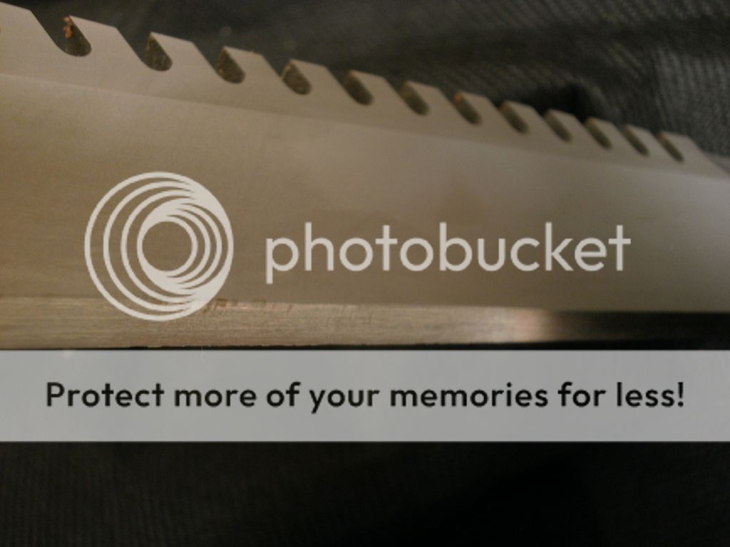

Here is my brand new handmade high end survival knife. I have named it Leviathon!!
11.5" D2 Steel with 57°-59° hrc
Full Round Tang which makes this knife One Strong Beast (Hence the name Leviathon)
20 Deep Serrations!!
This is by far the Knife Of Knives!!

As for your question about my Leviathon: the blade is D2 steel and is about 11.5" long and just under 1/4" thick at the spine!! I got itcwirh barely an edge on it. It was really hard to edge and sharpen, but now that it is sharp as hell, D2 steel claims it will Stay that way for a long time.
By full round tang, it is a full tang knife but the handle part has been shaped round. This gives people that love round handles and full tang knives the awesomness of Both Worlds!!

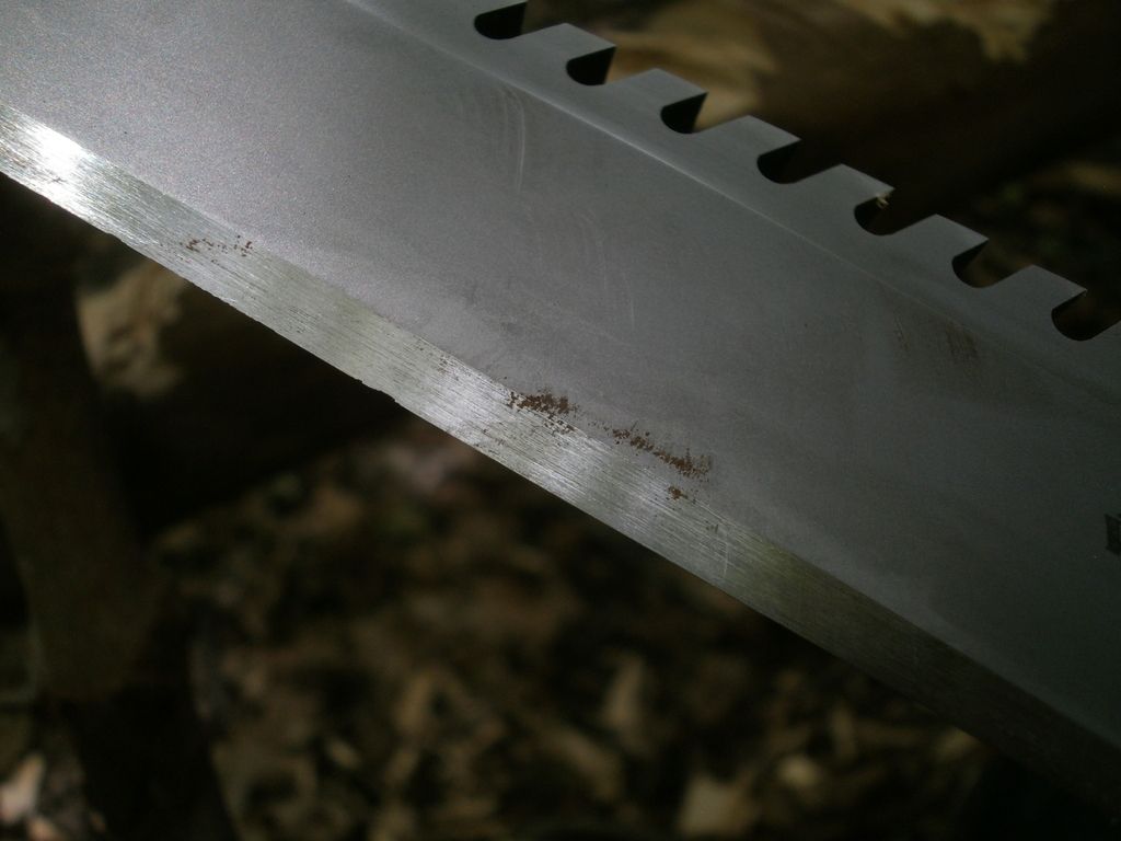

The SA9 was a shocker... And I gave it two chances: This is what it looked like the first time around, it kind of looked like a wire edge crumbling, so I gave it the benefit of the doubt, even though I never allow any wire edges on my work...:
This is what it looked like the second time around, on another testing day, after full re-sharpening and only around 50-60 strokes: Even worse!
Let me remind you this is solely on wood and clean wood without bark on it, as you can see in the previous pictures...
This is a rotten shame, as it out-chopped everything, to my complete surprise... And the small diameter smooth cord wrap was the most correct for confort while chopping... The sheath was the best, the handle was the best, the sawback was the best, the blade was the strongest, the design was the best chopper, if the edge was made thinner... You can't argue it didn't try and deserve to be the best... Just sad...
I will try salvage something from this disaster (no question of me selling it): I'm thinking it that despite the missed steel heat-treat, it will make a sound demonstration of the strength of hollow handles in a Noss-type destruction test...
Still shaking my head over this one...

At this point, I truly believe you’re beyond help. And ridiculous.
Also, deluded beyond belief about your skill and ability with knives. How in the world can you have the nerve to complain about the “heat treat” on Vaughn Neeley’s knife? Have you tested it for hardness? If so, you may have a good point. Let’s discuss that. If not…
Surely you haven’t based all your ludicrous statements about the heat treat on that knife on the apparent edge damage the knife suffered after it looks like you have sharpened it into a straight razor? Have you? Part of me wants you to say yes, so I can laugh even more. But part of me is hoping there is yet another bizarre twist to this insane saga of yours.
I know already that you will have a long, looonnng nonsensical rebuttal to this post, just like the gibberish in THIS thread here, which was quite entertaining. But I had to say something about the lunacy of your attacks on Neeley’s knife. You very clearly stated in this thread multiple times that you modified and thinned the edge drastically on that knife. Neeley very clearly designed the steel, heat treat, thickness and edge geometry to work as HE provided them. Start changing those factors around, and it’s on you.
Barring the possibility that the heat treat is off on that knife, (which I’m not inclined to go with, given Neeley’s experience and skill, although anything is certainly possible) the much more logical explanation is that you sharpened it too thin and beat the crap out of it.
How do you even know what all those factors need to be for optimal performance? You’ve “sharpened a bunch of your own knives”? How many have you designed and made? You modified that knife (based on what I’ve read in this thread) to suit your own liking. Fine. But you didn’t design and make that knife, nor do you know it’s parameters and limitations. Well, at least now you presumably know the limitations of the edge.

Obviously it took a terrible beating to get the edge to crumble...
I really do think you thinned out the edge too much on the Neely Gaston. I'd been looking at the pics and had forgotten you had taken it down a lot, Neely did run his edges pretty wide if memory serves. Not that you can't get a sharp edge on a wide angled blade.
It's no better than 15° per side Dave, which is 30° inclusive, and all the others were way sharper than that, especially the Al Mar, which has to be around 10° on Aus-6, and none of them showed any sign of crumbling... It was by far the the most open-angle edge tested, and it was there only two of the three days of testing, so all the others had more chopping in them... It was so dull in fact, that was one of the reasons I did not bring it the first day, as I thought it could not compete... Then it beat all the others... With a crumbing edge...
Gaston
There is a huge difference between a 30 degree edge and 40 which is what most of mine are. If the heat treat was bad you would have half moon chunks out of the blade or it would have just snapped in half, in the pic it looks like you took it just way too thin and removed too much metal.
