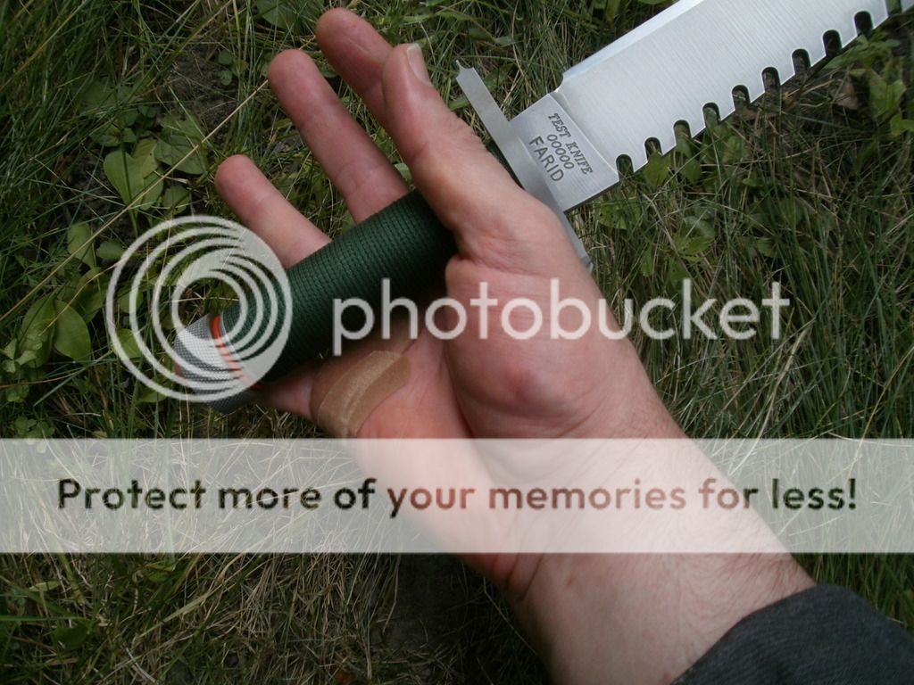

I've just got my Farid First Blood, and compared its saw in wood to the others, but I'll get to that later.
Farid First Blood Prototype, first impressions:
-Point thickness is stronger than a Lile, as I hoped from this being based on a re-ground FB point: Blade length is 8.9", so not a big loss in length.
-Blade thickness is only 0.23", not the usually claimed 0.25": This is bad as it emphasizes the blade-light feel (but it still doesn't feel as bad as the Randall Model 18, for some reason).
-The pommel is superb but enormously heavy, by far the heaviest pommel of any Survival Knife I have ever seen: It is at least twice as heavy as the aluminium pommel of the giant 10.5" RJ Martin Blackbird...
-The dry compass is superb, better-looking than any of the other liquid compasses I have.
-The edge is the usual awful 20° per side or so, so for tests that figure will have to be halved... Fortunately the steel is 440C.
-Sheath is superb, almost oversized: Unfortunately it has about 0.25" of dead space at the tip, which always annoys me...
As a result of all this, the balance point is a full 1/2" behind the guard, largely due to the monstrously heavy Farid pommel (Lile's pommel was aluminium, so maybe quite different: I would prefer a small diameter hollowed-out pommel in steel). Handle compartment size is about the same size as the RJ Martin, but quite inferior to the Neeley SA9's huge capacity: 2.7" Farid and RJ Martin, compared to 4" length, on a larger diameter, for the Neeley SA9!!! The Randall 18 is around the same as the RJ and Farid in length, but larger in diameter (even 1 mm can make a big difference).
In comparison: Farid edge thickness is 1.2 mm at the top of the bevel (about 0.047" at around 20° per side) so potential sharpness is definitely higher than on the Neeley SA9 which is at 1.59 mm (0.062"), even if with enormous re-profiling the Neeley can still be "saved": The RJ Martin Blackbird and Chris Reeves Jereboam Mk II are both similar at 1 mm or 0.040", so have a higher sharpness potential, but not by much, compared to the Farid. Of note is the Chris Reeves grows considerably duller and thicker in the forward quarter of the edge, severely reducing its useability performance, so generally I would rate the Farid higher than the Chris Reeves, and the RJ Martin just slightly better than the Farid.
Handle confort: CR highest, Neeley SA9 almost as good, Farid excellent as well, RJ martin slightly behind. Coarser cord doesn't seem to help, but knurling does.
The quick saw test of the Farid yielded the following overall ranking results for these four knives: 1-TOPS Hellion, 2-Neeley SA9 3-Farid First Blood 4-RJ Martin Blackbird

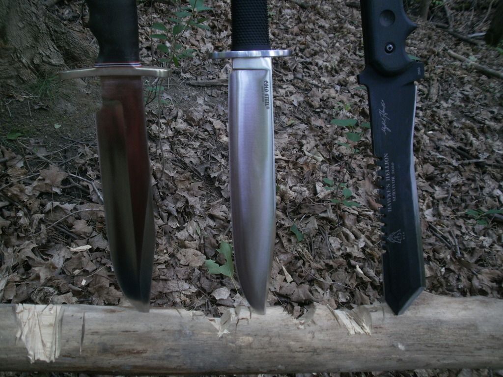

Below are the knives I will compare soon in a chopping contest, with a bit of whittling and maybe batoning: I've never seen any serious comparisons of these knives anywhere: My main goal is to compare various geometries and handle shapes, and I will try to estimate how well the edge holds (though I have no confidence in a precise determination of this, accross different knives sharpened differently). If cosmetic damage is incurred, I now know I can trust Josh to re-finish them nicely, which is why some of them are included here (The Neeley's handle is straight, it's just the lens here...):
The curious thing I have observed with 7.4-9.5" knives so far is that they all chop roughly the same: Rather on the poor side, unfortunately... The big difference is actually in handle confort: A 9.5" Trailmaster will not chop significantly better than a 7.5" Recon Scout of the same edge geometry (I've heard claims of a 30% or 50% difference, which I am sure is completely false): The real difference is the 9.5" knife will "buck" tip up less, vibrate less, and generally "bite" your hand much less: That is where most of the "real" performance difference lies...
In the photo I have ordered the the ranking, top to bottom, in how I think they will perform in actual wood chopping performance, but the differences in chopping are likely so small that the ranking by handle confort will probably be quite different, and far more significant... I actually think this is where hollow handles will score...
Gaston

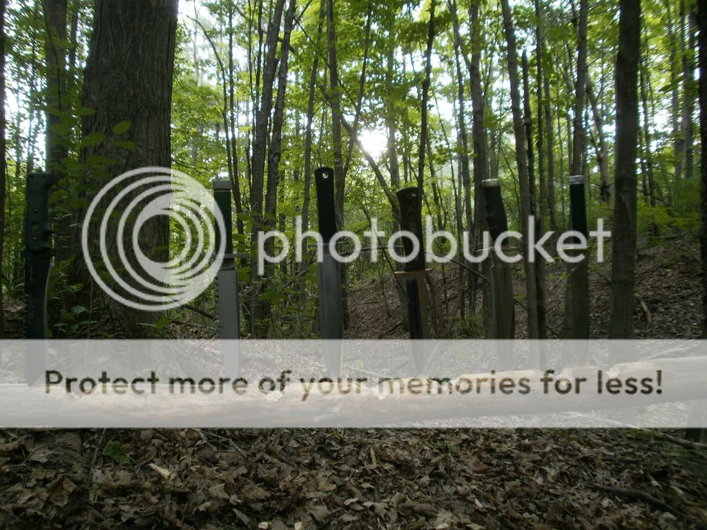

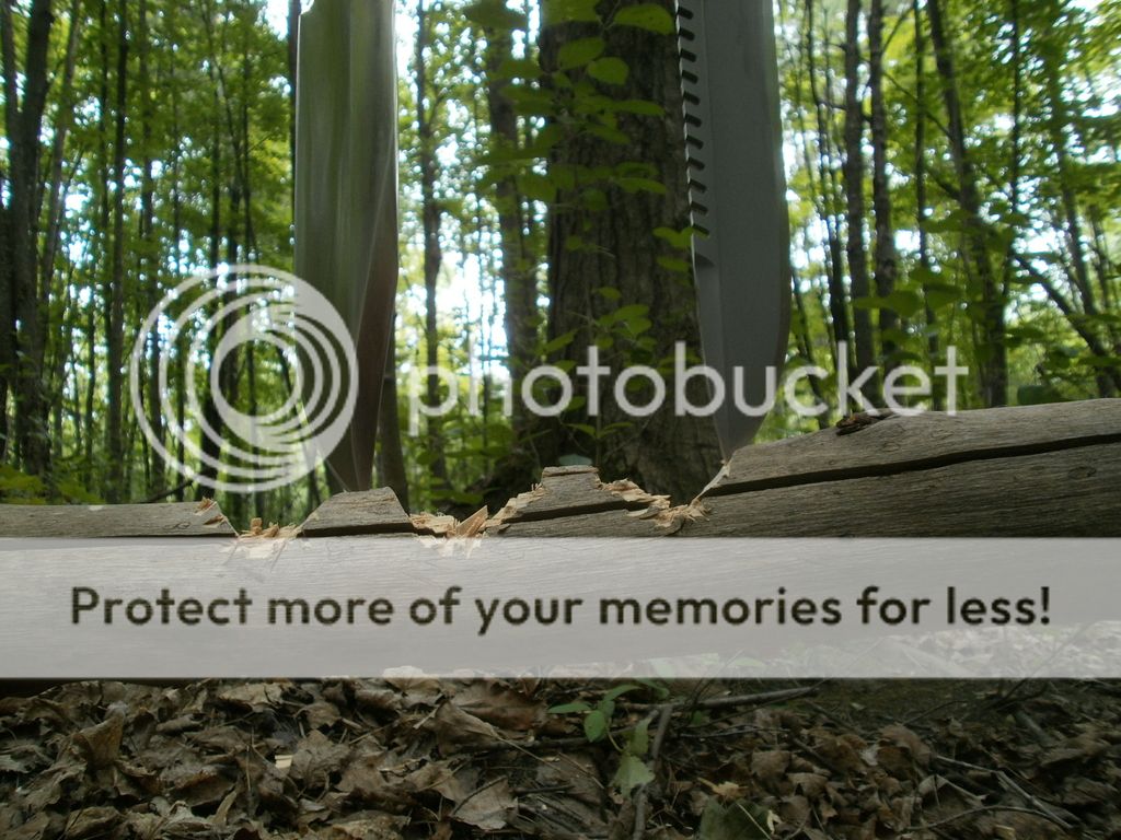

So I finally did my "Survival Chopping" contest, over two days with more to come, with some very surprising results... There is still more testing to be done, but two knives are incoming from re-profiling, and I intend to send two or 3 more on a round trip, so a postscript to this will be done. I will also start a dedicated thread as I don't want to "hog" too much space here... I'll try to offer a simpler condensed account.
So here is an updated line-up, unfortunately not accurate, as I did not test the Model 18, and chose instead to add the Neeley SA9 which I expected would perform poorly, but whose smaller diameter handle with much smoother cord I knew would prove less awesomely destructive to my hand... I cannot take the 350 cord off the 18, as it is glued in several places, and it "pommel down" bite is just too destructive to my hand considering the large number of knives I wanted to test...: It would instantly ruin my hand for all the others, and there was a lot of chopping to do...
(I did not include the RJ Martin Blackbird because I managed to remove the horrible scratches the Kydex sheath did to its blade, and this to perfection even under a strong light...: It turns out the way the knife is hollow ground, with a satin finish with very deep, yet very regular and pleasing vertical striations, is ideal to use sandpaper in a vertical motion: Because the "base" vertical grind lines are so deep, they will not allow your vertical sandpaper marks to come through, but by using vertical swipes the sandpaper will elliminate completely the horizontal scratches from the foreign particles in the Kydex...
After washing the sheath from any errant hard particle, I would rather simply leave it alone in its perfection now... Ideally a leather sheath would solve these horrible Kydex issues, but the knife is actually confortable inside the pants now because of its slimmer Kydex sheath wrapped in nylon, and I know a leather sheath for this thing would simply be a monstrous item... I was also not impressed in the field by the sponge-like shape-loosening nature of leather that is not truly huge in thickness -the thick Farid leather sheath really scored there-... Furthermore, when comparing leather to Kydex for inside the pant carry, it is evident it takes at least a double layer of leather to fully prevent sweat from getting to the blade...)
The most important thing I found out is really rather weird: It has to do with a phenomenon that is more pronounced on hollow handles, but is to my mind somewhat universal, in different ways, to all 9" class knives (or less) used as chopping implements: The violence to the hand takes an unexpected form I have never heard described: I call it the "Pommel Down Bite", and the fact hollow handles don't taper may make this more pronounced.
Curiously, now that I am aware of the the "hollow Handle Roll", that phenomenon never occurred once...
Basically the "Pommel Down Bite" is the reaction any knife has when the blade is abruptly stopped by wood forward of the guard: Within the hand, the pommel is what snaps down with the most violence, no matter how the knife is held... The result is the most affected area is shown where the band aid is on my hand, the knife being in a position to illustrate (and exaggerate) its reaction to hitting the wood...:
This reaction it turns out is crucial to how the knife will perform: It is not the performance itself however: The Randall Model 18 has absolutely terrible "Pommel Down Bite", at least with big cord around it, yet its chopping performance is surprisingly good, thanks to the thin edge and hollow grind...: If you make the mistake of putting any "largeish" cord around its handle, it will injure your hand in seconds, depending on how tightly it is wrapped, and how "hard" the cord surface is...
This is why, although the Neeley SA9's handle appears to have cord that is too smooth, ultra-fine cord is in fact the way to go for these knives... Rougher cord does feel better for "normal" whittling and general use. It also conveys an impression of greater security and quality. But at the real "emergency" chopping use that the larger size implies, the actual cost of this rougher cord is far, far too great in my opinion... I think even callused hands would get chewed up in the area of my band-aid, because the cylindrical shape simply does not conform to the hand there: "Normal" non-cylindrical knife handles do not bite in the same way, but they are equally deterrent to hard use by imparting shock in that area: This means you don't get blisters, but the chopping performance is actually lower than a hollow handle, because the impact has a reverberation in the hand that is a deterrent to hitting or gripping hard enough...
Because of its very poor edge geometry (15° per side on a monstrous 1.6 mm edge base), I almost did not include the Neeley SA9, because I felt it would have no chance at all against the thin edge of a Randall Model 12, or the blade-heavy heft of a "Battle-Mistress defeating" San Mai III Trailmaster -see various eye-opening videos-... (In the previous post you see the knives ranked as I imagined they would rank chopping). Imagine my utter astonishment to find, on the second day, that the Neeley SA9 was not only the most confortable chopper by far, but that despite its pathetic thick edge that I had applied poorly (the edge had an undetected wire edge that bent over heavily during the test), it outperformed everything by a large margin... Narrow non-chopping-looking blade and all...
As I expected the Model 12 proved better than the San Mai III Trailmaster, but not by much... I attribute this to 3 factors: 1-The stock is 0.22" (all Randalls are always way under the claimed stock thickness -except maybe for the Clinton dagger!-), while the Trailmaster is a true 5/16". 2-The Model 12's point taper is very long, not carrying full thickness anywhere near the point. 3-The edge is 0.020" thin (wonderful), but has a slight "convexing" that swells just above the V-edge bevel, maybe after some customers complained they couldn't "twist" the blade sideways out of the wood, like every incompetent user has right to do, without "rippling" the edge... Fortunately the Model 14 and 18 don't display this nonsense, but they are not as great choppers. One of the reasons the Al Mar "Special Warfare" chops so far above its size and weight range is it doesn't have this nonsense either... (One thing I noted though, is that the deeper "blade trapping" bites sure scratched up the Aus-6 finish more, despite the edge-holding being quite good)
So the Neeley SA9 was by some margin the best chopper, and yet narrow-bladed so not tall above the edge: No rolling tendency either (maybe the wood used just didn't have the coarse grain to cause this)... The performance of the smooth smaller diameter handle was key to this I think, combined with the full 1/4" blade thickness being carried quite close to the massively strong point. Other than that, considering the crap wire edge that became instantly dull, I'm quite stumped... With handle heavy balance, due to the undrilled solid steel pommel, and pathetic thick edge in very bad condition, it really defied comprehension, even after a few match-ups...: What will it do with a better more closed-angle edge that is not completely broken off as it folded?!?:
The 3 tops ones, aside from the SA9, were the Randall Model 12, the CS Trailmaster and maybe the TOPS Hellion 3rd, but that seemed to do poorly in a later rematch... The hooked handle end was a bit unconfortable, if not terrible. Where the Hellion scored was in a separate test in which I deliberately used lazy low energy swings: It beat out the two others by quite a lot after 20 strokes:
Lazy strokes are less risky, but definitely seem too unproductive for me...
One thing I noticed is that all knives struggled to make headway after 20-25 strokes, hitting a flat expanse of wood, because I did not go "around" the log to get at a "peak". This was an attempt to insure consistency, but it may have instead "flattened" the differences...: Any slight difference should be considered larger than it looks I would think... I went per count, mostly 35, and did not count obvious misses... All knives were phonebook paper push-cutting sharp, including the wire-edged SA9... Not much edge loss was noted, except on the much lighter use the first day on the Hellion (no loss on the heavier second day!), and the SA9's crumbling wire edge of course...
The First Blood did poorly, as I expected, given the long thinned-out point and 0.22" blade stock. Its "pommel-down bite" was the most vicious outside the Model 18, but all knives (except the SA9!) felt like they were tackling too much on this fallen wood: I chose it for its rigidity and straightness...
It seems blade stock thickness, and how far that carries out to the point, are far more important than I had assumed, especially compared to the blade's depth profile, which seems to have little effect if the SA9's narrow profile is any guide... The Hellion is not helped that much by its Tanto point because it is even thinner than the Randall at 0.19-0.20"... Note how heavy-hitting the Al Mar is, for its size, being a full true 0.25" stock...
A final point I'll quickly make is that the "pommel down Bite" really changed my perception of how chopping worked: To minimize the pain over long stretches of chopping, there was no way to use the "sweet spot" often described as beyond halfway down the blade... This was simply impossible: To minimize "Pommel Down Bite", only the portion of the blade closest to the handle could be used... The only mild exception to that was the Cold Steel Trailmaster, which could be used to hit at mid-blade, because its handle was so different it didn't behave like the others. I found the handle unpleasant in a very different, "surface spiky" if unfocussed way, compared to most of the others. The handle shape seemed to "hide" any "Pommel Down Bite", so the blade could be used to hit further out in front of the guard, but the handle's thinness was so unsecure the blade still "reared up" quite a bit, reducing efficiency...
I had never heard before that hitting close to the guard was a help to chopping confort, but for me it proved emphatically true for a wide range of 9" sized knives... I suppose the hugely increasing mid-handle "swell" of Busse knives allows moving out the hits away from the handle, somehow, but, on these much lighter 9" knives, I could not imagine the extra pain of the ever increasing "Pommel Down" impact that would happen if you did that... This was by far the most surprising finding for me...
Come to think of it, how many times have you seen any of these knives, besides the apparently unusual Trailmaster (and similarly blade-heavy BK-9), tested in prolonged chopping cessions? Not often...
Gaston
