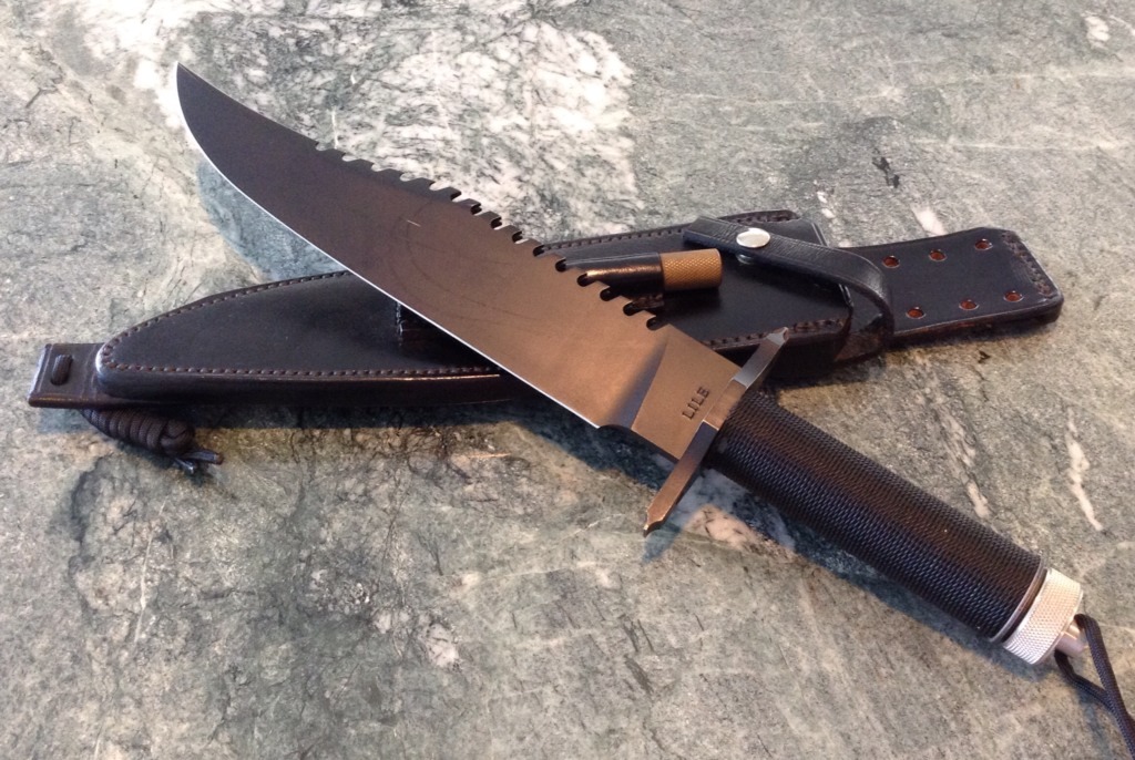

In the meantime I found and lowered the price on a Pre-dot Lile Mission(!): $1770 I felt was a very good deal for a near-mint pre-dot Lile of around 30 year of age...: The black paint was of poor quality but protected the blade. Also the point was ground a little thicker than what I have seen on others, so I took a gamble on my biggest worry about it and it turned out OK!:
First impressions: Condition is better than even the pic suggests... I've seen much worse Liles go for much higher... Black paint is cheap and was stripped off easily (I did not strip the guard), revealing a rather rough underlying sand-blasted finish, which now looks like stonewashed with polishing paste... I will have it Cerakoated after testing, so it will still look new even after I put it through its paces...
The blade finish is rather industrial-grade, apparently the blade was mass-produced on a dual grinder, which shows near the plunge line, but not bothersome to me: The clip bevel symmetry is excellent, and that really counts for me, so I don't complain... The Farid felt much more refined in most if not all respects, but the clip grind symmetry was off in the bevel lines (perfect in plan view though): Hard to say which I like best, I'll give the Lile a pass for its age but not its price... The better feeling of quality of the Farid can be gauged by the compass: Very refined top-quality dry compass in the Farid, liquid compass with a huge bubble (making it useless) rattling loose in the handle for the Lile... Hohum...
The old Lile leather was pristine and is exquisite, and much better than some of the more recent sheaths for this knife. To give an idea of the knife's age, the brass rod sharpener was completely greened over from age...
Comparing the balance to the Farid is pointless, because the Farid's all-steel pommel is so heavy it skewers any comparison: The Lile Mission balances 3/4" into the blade, which is good, but it still feels very blade light because of the oversized clip: The oversized clip takes some getting used to: It looks nice in pictures, but at around 5" it feels lightweight and a bit like a movie prop in person...: If you look at it in the movie, it is often framed in close-up and cut-off at the clip, making the knife look much bigger than it is, because the eye assumes this is 1/3rd of the knife not 1/2...
The edge was a mere non-existent grind line, around 40° per side, but much more important the edge base thickness is an excellent 0.028", so it is close to ideal once the edge bevel is entirely re-done... Again rather dubious edge work for the price, but the basic geometry is good, and I've seen some close-ups of more recent production which make me suspect the post-dots are much thicker at the edge base... That was one of the reasons I wanted an original Lile, as I had heard they were thinner at the edge...
Overall I am reasonably happy with it, the symmetry being a big deal to me. It is much rougher in finish than a two-tone finish version I suppose, but with a Cerakoat it will look fine. An amusing tidbit is the pommel is interchangeable with the RJ Martin, and the Lile's was even by some margin less rough-looking(!): I swapped them...: Must be a unique case among hollow handles from different makers! I heard the handle cord was from the Lile shop, even the handles, but I can only confirm the buttcap, as the handle diameter seems a bit different, despite the near-identical buttcaps...
Gaston

Also, congrats on the Lile and thanks for your detailed first impressions. That's just a good looking knife. It is interesting to hear from someone who owns other HH knives for comparison. Any small shortcoming it has really doesn't matter at this point. It is an iconic knife and will always have a special place in the hearts of HH enthusiasts. :thumbup:
