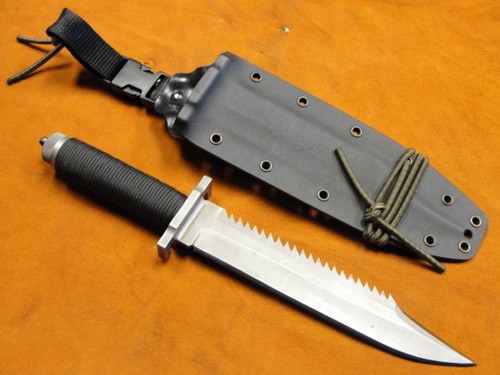

Another great knife from the Wilson Custom Knives shop. Your sheaths are getting better and better. I like how you angled the corners of the sheath to meet the guard. It's all in the details! :thumbup:

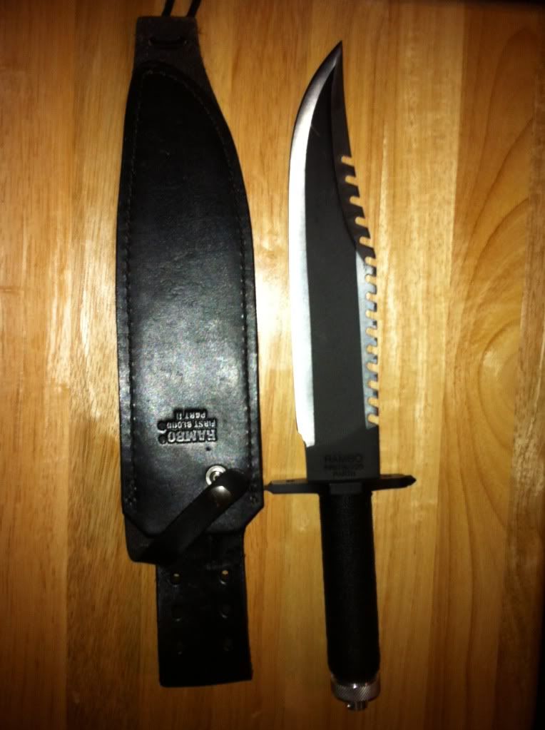

Here is the screen used, First Blood knife (5 of 13) that was auctioned off a years ago. As we can see, Lile was using the forward slant teeth in his original design. Good catch on the Rambo II knife above.

Thank you sams. I get orders for the smaller knives at probably 3 to 1 over the bigger "Rambo" knives. I love them too, but the majority of people I have interacted with that are going to use their knives a lot go for a smaller lighter design. A lot of customers start out saying the same thing you did, "I want a size I will actually carry." Either way, I'm happy. :thumbup:

Thank you Tom. I've been trying to focus on doing what I like design-wise, and sometimes other people actually like it too, lol! Thank you again. :thumbup:

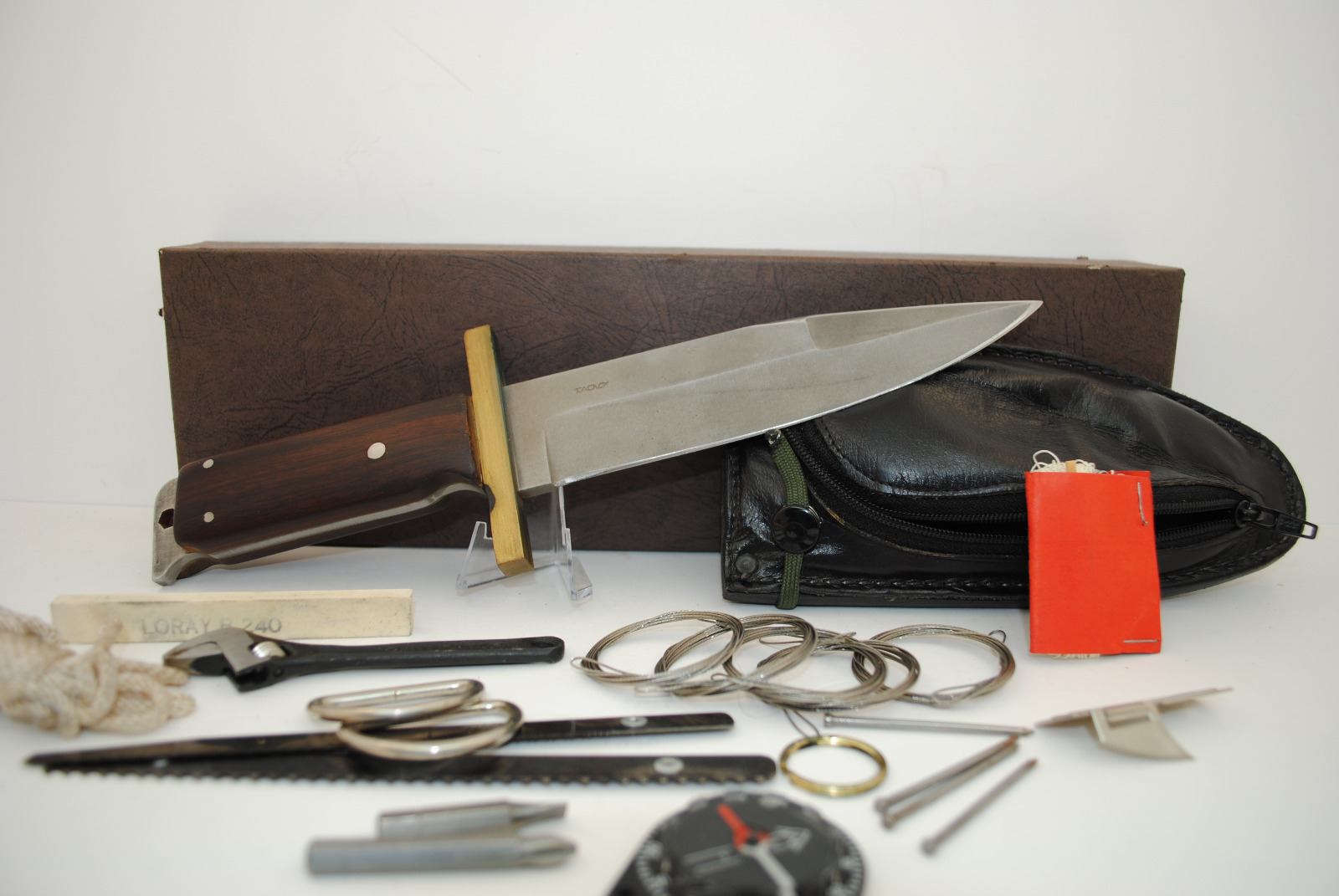

Some neat old survival knives on that famous website that accepts bids. Pretty neat to see these old knives re-surface.
Jack Crain
Webster Wood
Dan Valois
Thanks TAH! I'll check out those Jack Crain...

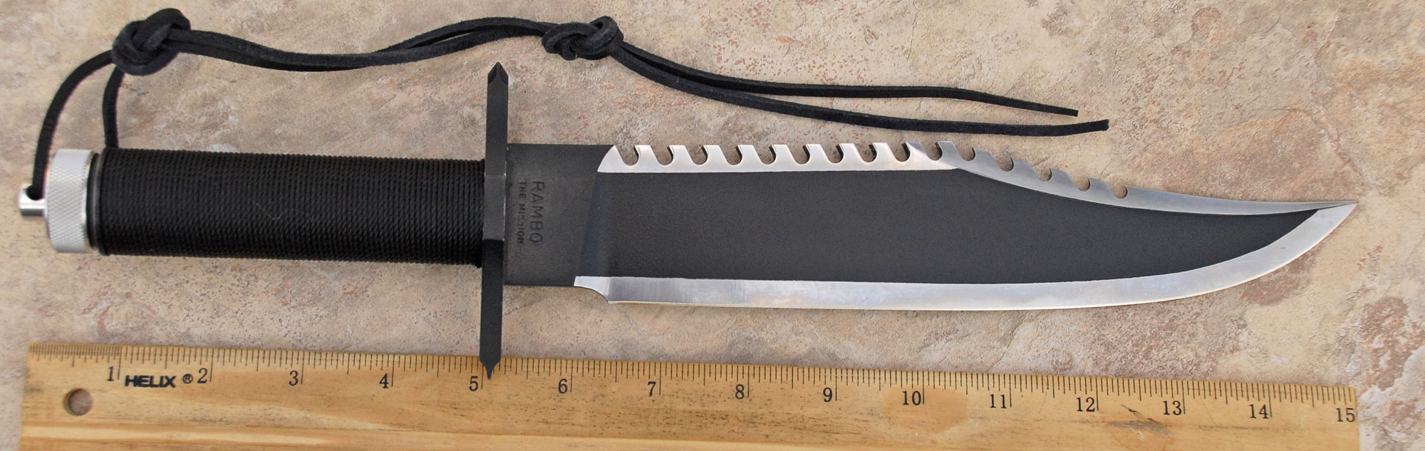

Here is the First Blood 091, functional dipped saw :):

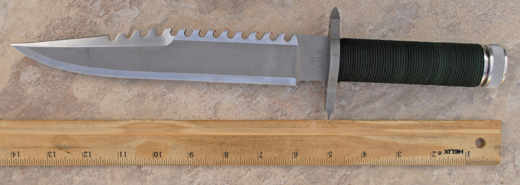

"Matching" Mission 091, no dip... :( :

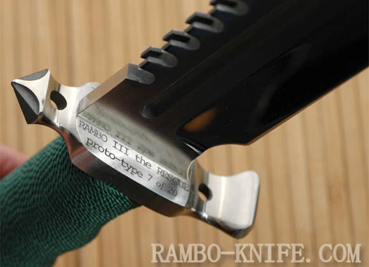

And here's another one I did not realize had no dip... (original in close-up, and 25th anniversary in the profile shot):
Jack Crain
I've been lusting over Jack Crain's Life support System since I was a youngin', back when I saw Arnold Unneccesarily resheath it when he geared up on the beach in "Commando"
Shame that he seems to have become seemingly unreliable, he made som cool knives in his day.
http://www.bladeforums.com/forums/showthread.php/626931-Problem-with-Jack-Crain-Knives
