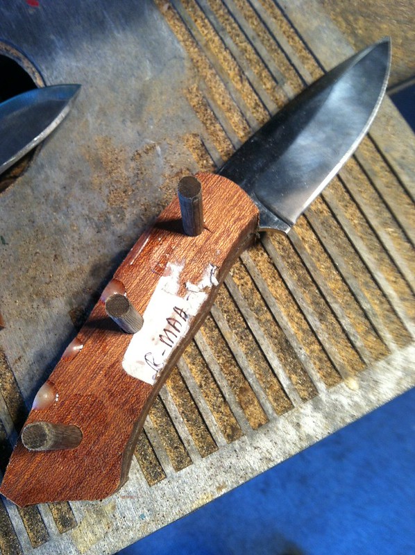

made a bit of progress today....or did i?...you'll see what i mean.

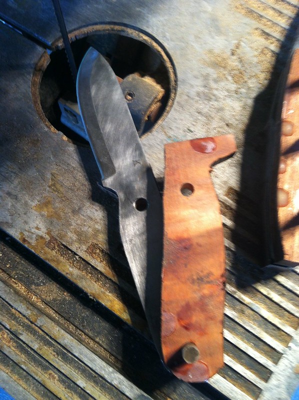

i have another WIP. a Bill Akers blade. did that one first as practice. went well. so, on to the LRK+.
Drilled out handle. sorry...no pics.
Pinned for alignment...
And saw away. I don't bother tracing and cutting. i just pin and cut.

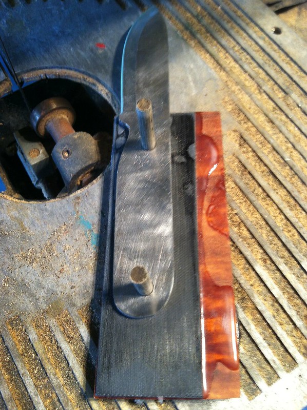

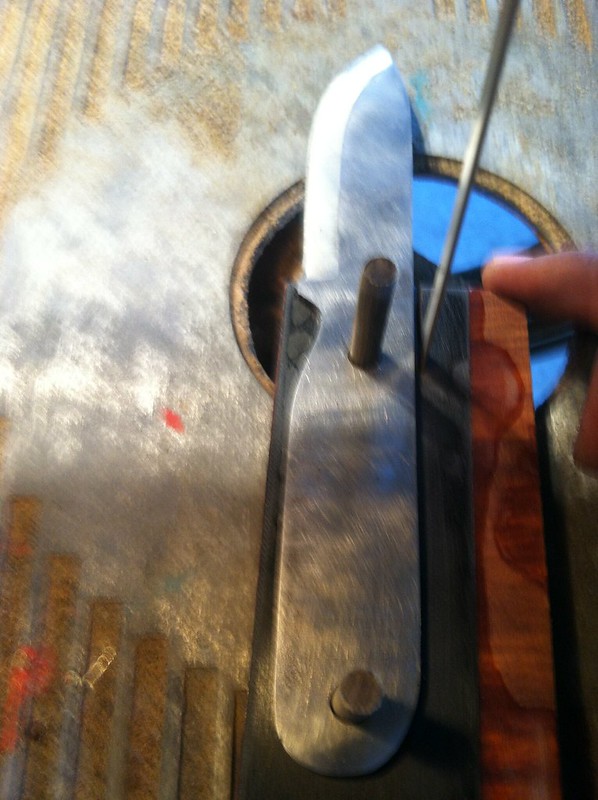

Hmmm. Something doesn't look right here.
Do you see what i mean?
Uhh...that's not going to work. Dammit. I was going faster on the LRK+. i thought i had it all figured out. don't get cocky kids. and, of course, i don't have any more liner material. really, it's ok though. it's a recoverable error. just gonna cost me some time. i'll order another set of thin liners and glue one up to the other side. no biggie. aaand, i'm guessing i won't do that again. lesson learned.

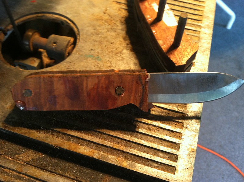

here is the rough result. KOA wood. Thin black liners. Black micarta pins.
the Backwoods blade ended up good. but, i will wait until i'm done with the LRK+ to glue them both up together.

thanks for the encouragement andy. i thought about just doing it as is. that would mean only one black liner and the other side of the spine would be just lying on wood. i shook off that idea. i would rather take the extra time to do it right.
Easy mistake ad well corrected, look at that we learned something! :p

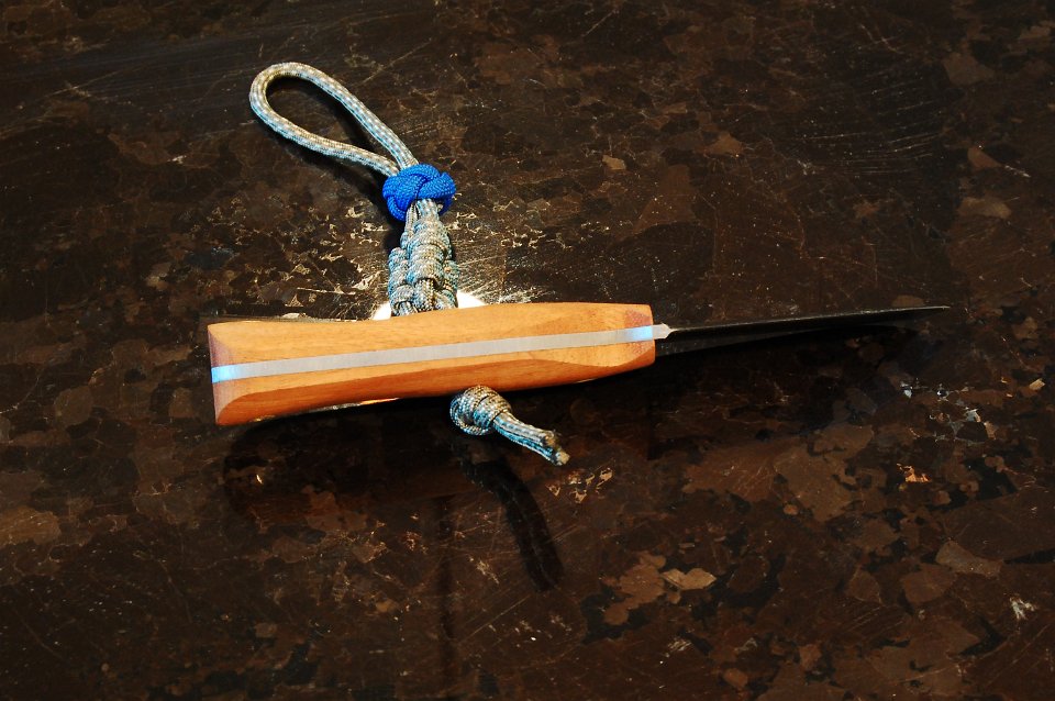

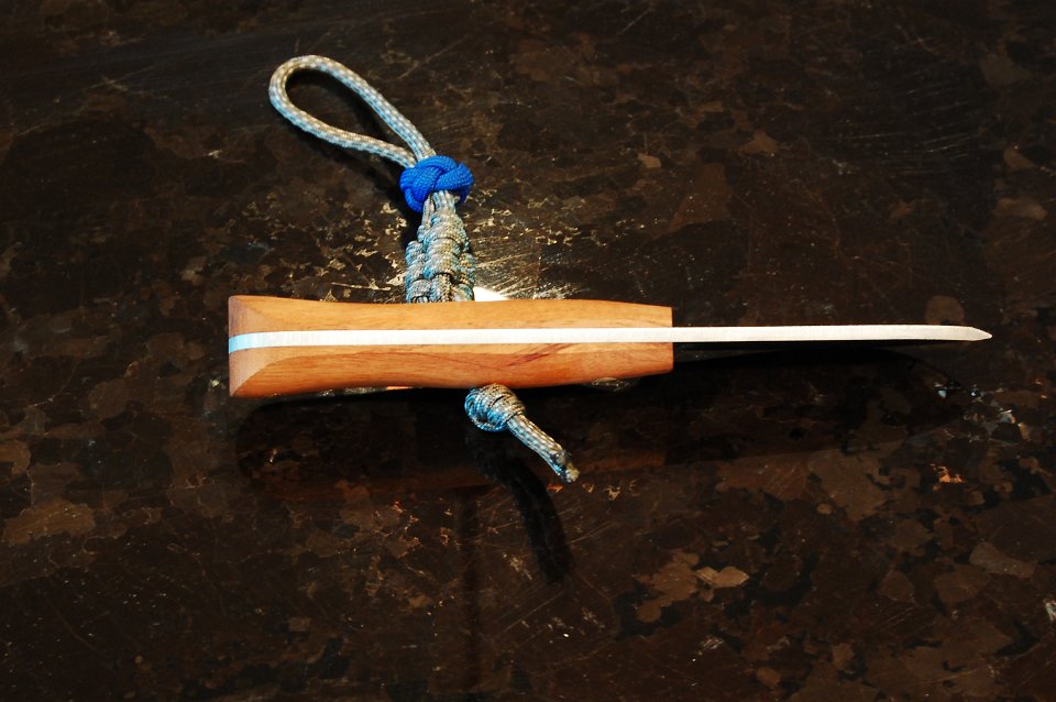

Woo hoo! I received my LRK+ handled with Amendoin wood today -
It is very nice! It is a nice, heavy duty mid to small sized knife and John contoured my version very nicely. The knife is just the right size to fill up my hand, but with nothing left over.
I opted for the version with heat-treat scaled left on - to match our new kitchen (the wood is what we used on our floor...)
I also was very pleasantly surprised when I found the KYenglish custom lanyard with the sliding knot in olive and blue - it is a great looking lanyard - thanks Peter!! That lanyard will stay with my LRK+ and I'll try to get it installed and some pictures asap.
Enough talk - PICTURES!!
You can see the contouring -

great looking knife, the wood looks nice and those contours look very comfy,
hope you like the lanyard, thanks for being so kind,

nice mqqn! great looking little knife. i like that wood. and great job on that lanyard KYe....looks great.

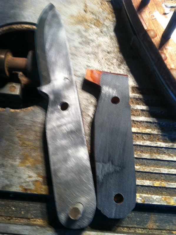

Haha,you forgot to turn it over for the other side,haha.:p
Sorry Todd,too much Simpsons watching,dang that Nelson.:o
The Mahogany is going to be killer dude.

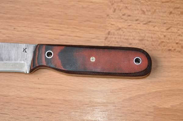

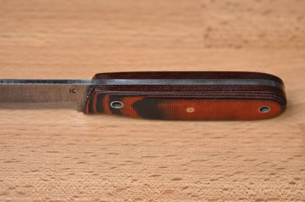

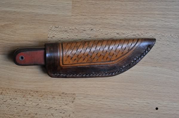

And now it is done. The heat treat finish was rubbing off in spots, so I decided to lightly sand it off. Sorry for all the photos, but I'm pretty proud of how it came out :D
That was really fun... so fun that I ordered another LRK+ :rolleyes:
Awesome package PG!
That turned out great & seeing that sheath makes me want to give leather a try.
Grats on a job well done.

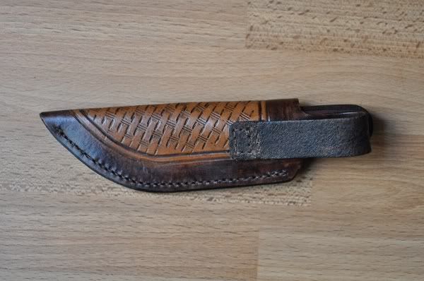

Wow - outstanding job on the sheath, making your own micarta and putting the scales on !!
Very sweet!! Thanks for detailing out the process - this is a really cool thread!

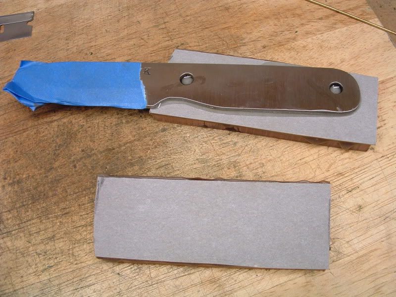

I have been dragging my feet on this project a bit, but managed to get a little work done on it.

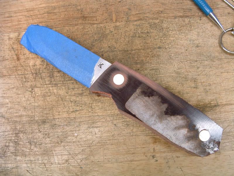

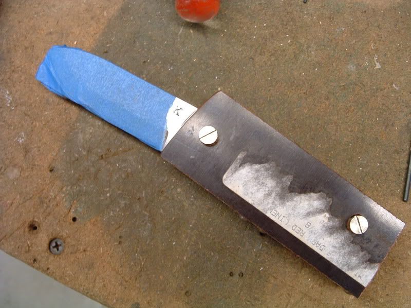

I had some red linen micarta that's been layin around for years. I decided to use that. I glued a gray fiber spacer on the micarta...then did an initial shaping on front area. Here's one side glued up, then I drilled some small holes and glued up the other side.
Here's with both sides glued up and the NS Corby rivets installed. The scales look funky the way I have them postitioned to the blade. I was just being lazy about sanding down the front area.
And, last for now, rough cut done.

that's gonna look good. i really like the look of the maroon micarta. thanks for the pics.
Hi Glenn -
I think Maroon with grey liners is going to be a nice looking combo!
Thanks for the work in progress pictures.
