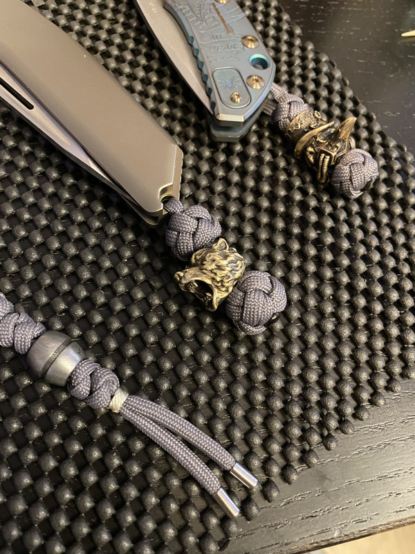

Do you want to see a big collection of beads or just finished functional beads and lanyards on knives?
This past year I went from thinking that they were a waste of time to really liking and even collecting them. In fact, I have started thinking about Making them of myself using molding silicone and modding them with glow pigment.
Last few times I sold a knife I've included one for free, everyone has seemed to really like getting a little surprise.
I'd be happy to take a few photos of my collection unless you are more interested in seeing them actually on knives being used.
This is a decent number of them that were at hand. I have been adding glow accents, so many colors out there now!
Nothing crazy here, I still can't bring myself to spend $100 on one. I would consider it if it was sterling silver, but otherwise they get banged up (and sometimes bang up) my knives. I have taken to adding one to all of my knives though, the lanyard is a lot more useful than I thought it would be.
I grouped them by theme like animal sci-fi/comic characters etc. 20210214_151533.jpg
