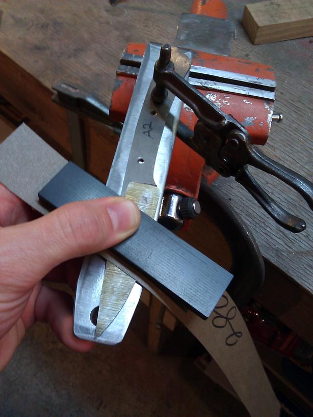

It's really about matching tools and technique. I'll see how well I can describe mine...
My sanding block is a piece of G10 about 3/4"x4"x1/4" - previously I used some scrap maple, which was a bit soft but worked mostly.
I cut my sandpaper into long strips maybe 1/8" wider than the width of the block, so about 7/8".
Then I simple hold the block on top of the long strip of paper. That gives me decent control of the edge of the paper. Sand a bit, then slide the strip along the block, sand a bit, etc.
Then toss the strip when the end is reached and grab another.
(and tape that sharp edge while you do this!!!)
In order for this to work well, you will need to clamp the knife to something by the handle so that the blade is horizontal.
It is easiest when there are no handle scales, but you can make do.
I use a piece of angle iron as a knife board.
My sanding block has to be wider than the blade for my favorite grip to work, but there are as many variations as hands.
This picture below shows my setup, more or less. It's a mock-up since I'm not sanding tonight.
Of course my right hand is holding the camera instead of the other side of the block.
I also usually slip a piece of craft foam between the blade and the knife board, but wanted to make sure the picture was clear.
The details of the setup can vary, but the central ideas are: immobilize the knife, use two hands on a flat block, with fitted paper.
Notice the knife is fully on the board even though it's mainly the handle that is providing support - this prevents you from accidentally impaling yourself. Kind of a good idea. Obvious in retrospect, but I had to be told...

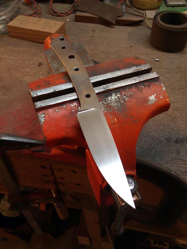

I hand-sand the whole bloody thing. It's the only way to get the lengthwise pattern.
Actually, the part that will be under the scales only gets modest attention - some texture helps hold the epoxy.
But the ricasso gets finished up the handle beyond where the scales will cover - about to the first pin - to make sure the finish is continuous up to the seam at the front of the scales. Having tried to finish that tight spot post-handles, you now know why it's done *past* the seam - just to make absolutely sure.
What you see there is a 60grit scratch pattern from the bevel grinding.
When I'm done it will look like this (360 grit):
Then it will go to heat-treat.
I can attest to his sanding work. My Hiker is SMOOOOOOTH! I added a patina to it, but that hi-gloss shows thru it....freaking beautiful. Smooth as silk is what it is.
