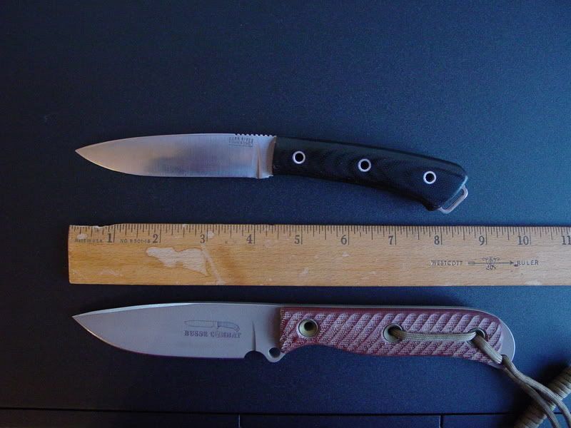

And this Bark River so far has been the best one for me.... but I don't like the way the handle drops off the plane of the spine. I understand that it cuts better because of that but I wish is was less pronounced.

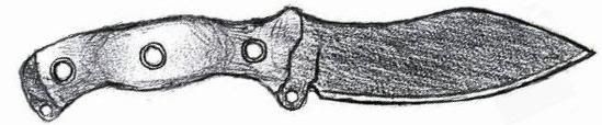

Crude drawing of a Nessmuk HRLM sans choil and thumb dent. Looks more Nessmuk than SRKW or Busse though.
I would be interested to hear from Nessmuk aficionados exactly what makes this design a "woodcraft" knife.

The Game Warden looks almost perfect. I would thin it out, somewhere over 1/8th" but under 3/16ths", stretch out the blade by an inch, make the spine nice and square so it could throw a spark. That would be awesome. Rat's design is about exactly it.
Nice Itchy. I like that this one has what some of the others don't, the pointier tip for detailed carving is good. Good job...I'd buy it.
That's it! Thin, like 1/8" with smooth contoured micarta or grooved G-10 handles, DC or Satin. 4 1/2" blade, MAX...

It's a neat looking design, but why the hump in the spine? If you drew a straight line basically from the bottom of the thumb ramp to the tip of the blade you could get rid of all that extra metal, making the knife that much more maneuverable.
