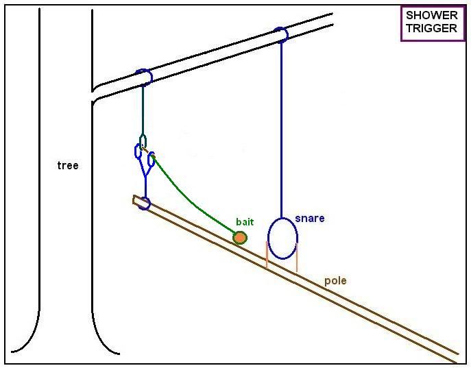

It can be used as a drop snare: (Coote's diagram) (this could also be adapted as a 'drowning trap'.)
Here, when the critter pulls on the bait, it releases the weight, tightening the snare around its neck and pulls the critter off the branch, where it hangs.

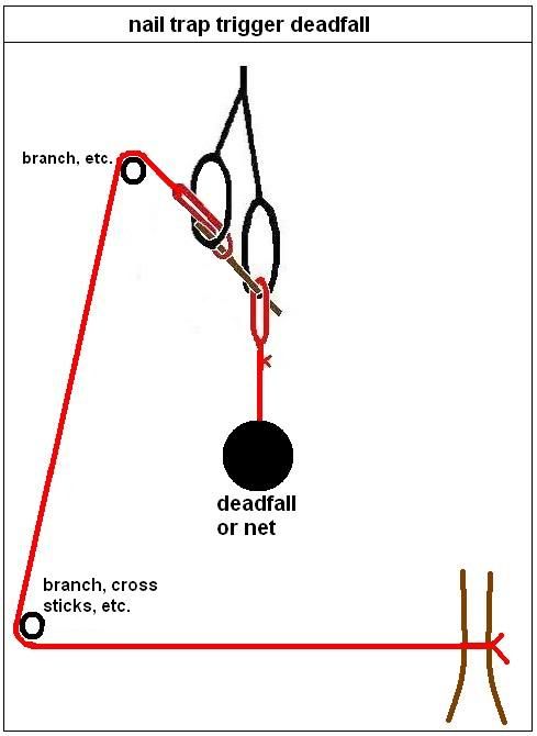

Here it is used as a deadfall or a drop net trigger with a trail set.

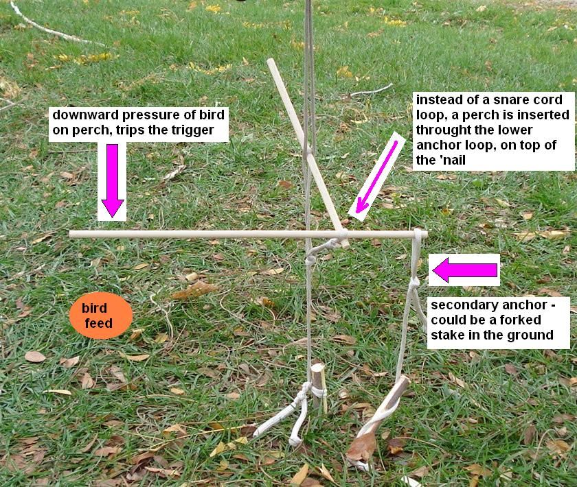

The one I was most pleased with, recently (you may remember seeing this from the "It was a BOO-tiful day" thread:
Trigger detail:
This one worked like a charm!

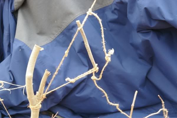

A few years ago, Slasher, Phil and I were camped out and decided to play with the nail trap trigger. Here's a picture of it made with Wood Nettle (Laportea canadensis) cordage and a stick. You might notice that this was the original method I used to locate the anchor loops. It was tied to an old cut off shrub shoot.

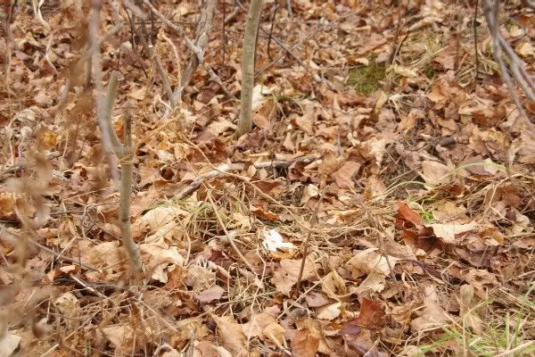

The reason I had the coat behind it was
tied with natural cordage, you can barely see it in front of the leaf litter.

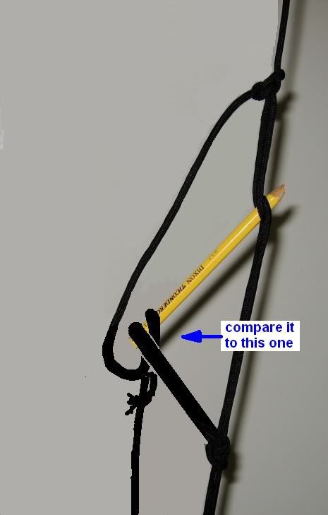

Finally got a bit of time to play with this a little more. Weather's not great here though, so I'm playing with it at home. Nothing crazy today, I just wanted to get the basic trap working. I did get it triggering this time.
Set-up:
Videos :) I wanted to include slow-motion playback of the trigger with the first two videos, but, apparently, my version of iMovie doesn't allow me to play with speeds.:rolleyes::mad:
Triggering:
[youtube]OtygTEerf98[/youtube]
Close-up of trigger:
[youtube]a9Oc2MWYFgk[/youtube]

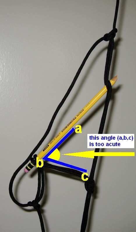

I still need to work on sensitivity. As demonstrated in this vid, sometimes it seems a bit of tension is required to tripper the trap. Actually, now that I'm thinking about it, the paracord could just be getting caught on the metal collar at the end of the pencil. I'll play around with it more.
[youtube]U2DMDVXRV38[/youtube]
Suggestions for improvement, Doc (or anyone else)?

The angle between the anchor loop and the pencil is too acute. It's the same problem you had with your first attempt. Compare the two pictures, below. Also, if you're going to use a pencil, have the rubber on the upper end - it provides more friction than the wood.
chopchop, depending on the type of cordage you're using, but normally there wouldn't be that much load to jam the Bowline in a Bight.

Yes, I was paying attention to the wrong angle. For some reason, I thought the angle centered on C had to be 90. I should have reviewed your earlier critique before trying again :o I understand why angle ABC has to be 90 or greater, and I'll fix it next time. :thumbup:
As for the pencil, it was just something at hand. I'll be using a found stick next time.

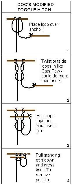

Ever see one of these, Doc?.... my own invention... probably done before but I figured it out when I was 9.
Ya... but have you used it as a trap trigger?
No I haven't. I didn't notice, at first, what was happening there - the pin is pulled releasing the lifting pole etc. Actually you didn't have it labeled when I first looked at it.
I think the nail trap trigger would be more sensitive, but not a bad idea, at all, especially when you're 9 years old.
Doc
Doc
I agree that the nail trigger would be more sensitive and versitile... but for spring snares and lift traps, its about as easy as it gets. No tuning required and you can even do without the little stick if you pass a loop from the snare lead through the hole, instead.
That's cool too. Thanks for the picture. I'd seen that before but for some reason couldn't get it. The picture clears it up.
