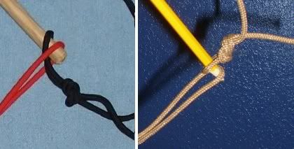

is there any reason you couldn't use the left orange end loop in a cow hitch attached to the "nail"? that way the nail just drops out and down, and doesn't go shooting into the next county.
You could, but the purpose of the loops set up the way they are (Bowline in a Bight) is to be able to instantly adjust the size, one relative to the other. With it cow-hitched, you'd have to mess around a bit more.

yeah, i was thinking it would be useful to not lose the "nail", assuming you knew your placement well enough. cow hitches slide somewhat okay...
the book is "decorative fusion knots", it's one of probably a few dozen i have on knots kicking around, but is mostly about the pretty stuff.
there's some great stuff online (www.animatedknots.com) and many other resources.
my favorite knot of late is the "zeppelin hitch"... it's strong, uniform, and easy to deal with. won't quite replace my half-hitch favorite, but close.
otherwise, the so called "alpine butterfly" (artillery hitch), is a superb way to make a loop mid-line (mid-bight) that has interesting properties (strong, in-line, can be pulled any direction, symmetrical as possible, multiple methods to tie, easy to untie...
yeah, i was thinking it would be useful to not lose the "nail", assuming you knew your placement well enough. cow hitches slide somewhat okay... actually, the hook stick takes care of that

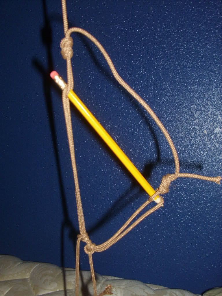

I got the "obtuse" angle we are looking for I believe. I whipped this thing off in like 5 minutes though, and I have never practiced any types of snares or traps. So any advice or tips would be cool. :D
I did the two loops on the anchor differently. The pic does not show it well, but each loop is a simple slip knot with a half hitch at the base to prevent the "slip". It serves the same function of an inline figure 8 on a bight, however it ties and unties in three second, and is adjustable. I set the load bearing loop to the desired length, and then using the smaller "trigger" loop as a slip knot to adjust my angle, after that throw a half hitch over it and bobs your uncle.
Wow is this thing hair trigger, the small loop does not even appear to be bearing any load at all! Hope I explained myself well, pretty tired.
XM
XM... looks good but I don't think you have the trigger loop set properly. Not that it wouldn't work but the trigger config Doc shows is more mechanically consistant.

Hey xtramile, good on you for trying it out. I'm interested in the way you made your loops with the slip knots. I'm going to have to try that later. I'm also going to think about the way you placed the trigger release knot (the one Rick pointed out). On the surface, it looks good.

Hey Rick, can you elaborate on "more mechanically consistant"?
With the way XM has it set, it is possible for the trigger to "bind/lock" long enough for there to be a risk of not being as effective. It is the same configuration as top portion of the trigger stick. It is possible for the animal to move in such a way that there is enough of a delay to "spook" them into leaving. I have watched squirrels and rabbits approach snares VERY cautiously and "feel" the trap before it is even triggered. Some folks seem to think game runs are places where animals let their guard down... not so. If someone set a human-sized snare in your backyard, you would most likely see it, no matter how comfortable you feel. It is even MORE important to have everything working right. XM's looks pretty good, with the knot well enough on the tapered end of the pencil to be sensitive but I can see more potential for failure than your "loop-under" set.
I see what you are saying, the direction of pull from the actual snare goes up which of course would be less efficient than pulling down.

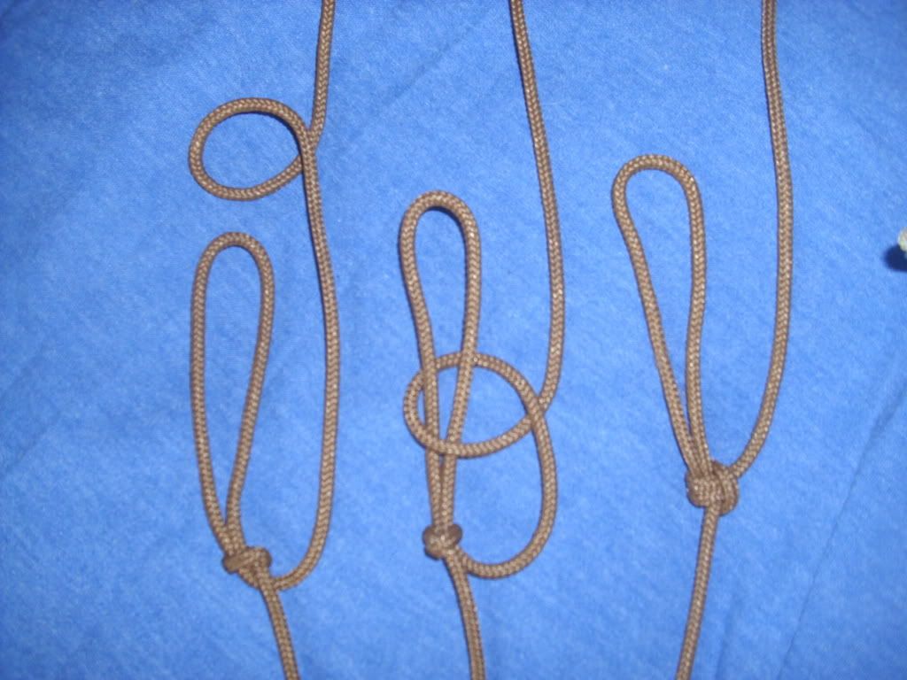

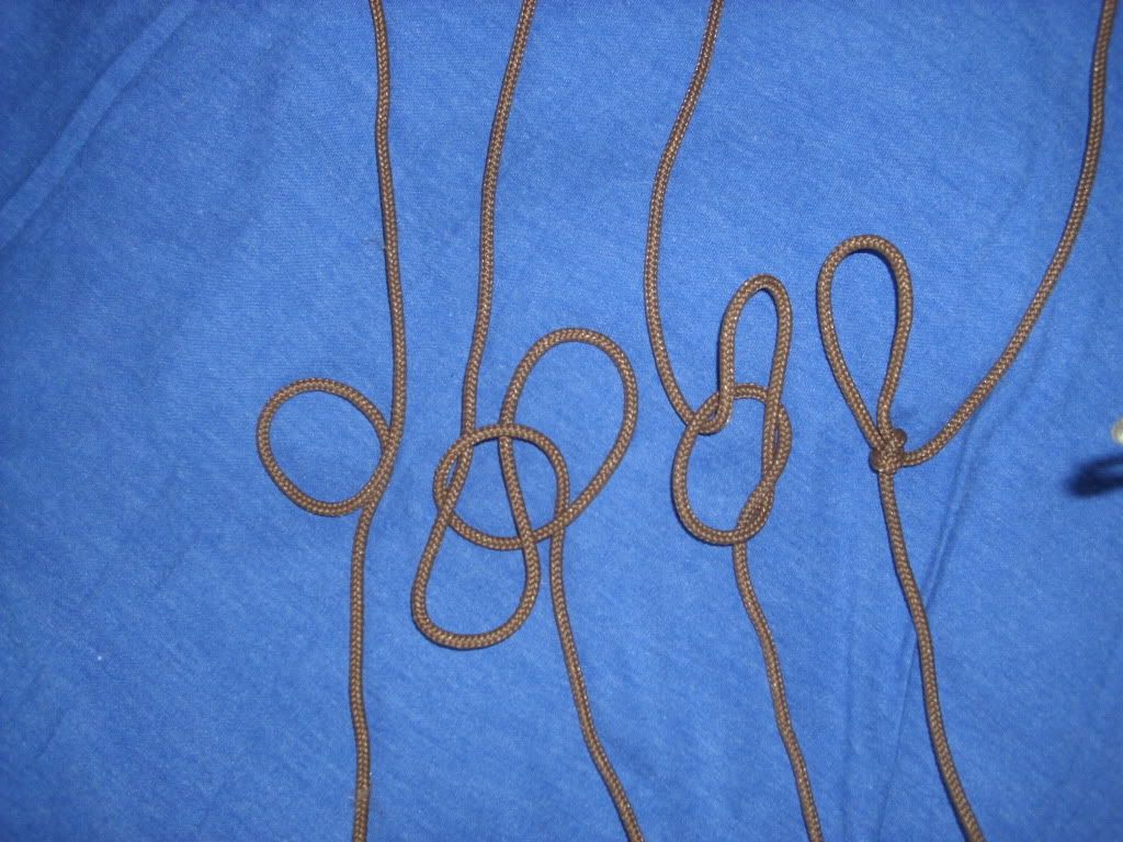

I will post pics of the slip knot with a half hitch in just a moment. I think it is a pretty cool knot seeings how I have never seen anyone else use it.
Not sure how familiar we all are with knot terminology, but I will explain as best I can.
The first picture is to tie a basic slip knot:
1. round turn
2.form a bight and place it through the round turn
3. pull bight in opposite direction of origin
4. dress

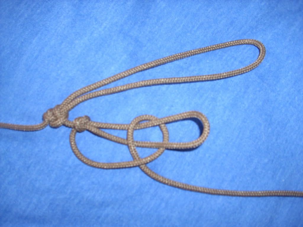

Now this will "slip" to adjust to whatever size you want to, and to lock it in at that size do a half turn at the base:
1. form a round turn on the latter side of the knot
2.snug it down to the base of the bight
3.dress
Now putting it together, the large "anchor" loop is what is pictured in the final step of the above photo. While the small "trigger" loop is in the second step of the above photo. At this point the small loop can be adjusted and locked in perfectly within a matter of seconds.
I left a quarter inch between the two loops to easily distinguish where one begins and ends. Hope this helps explain it better. Any thoughts?
