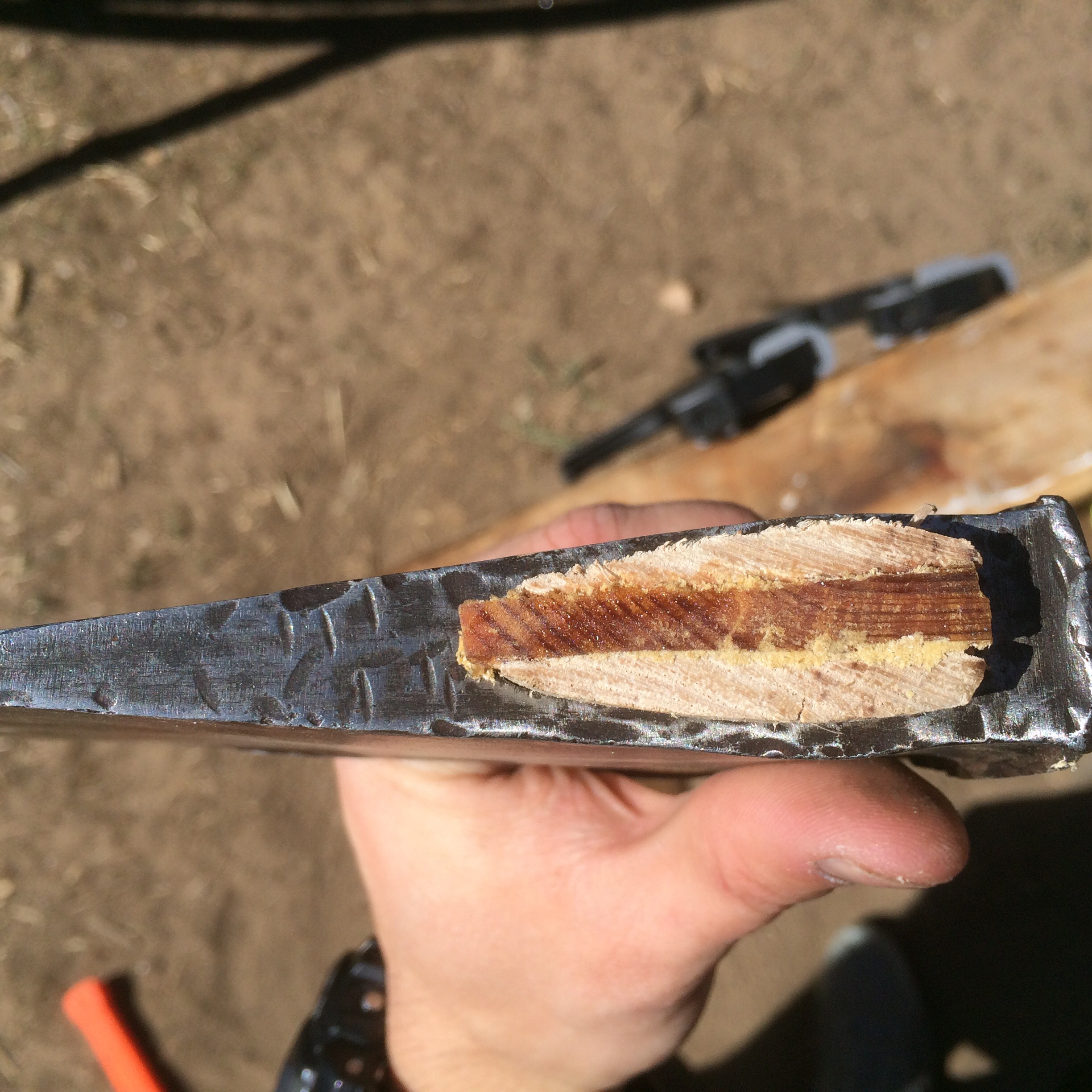

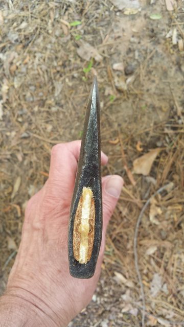

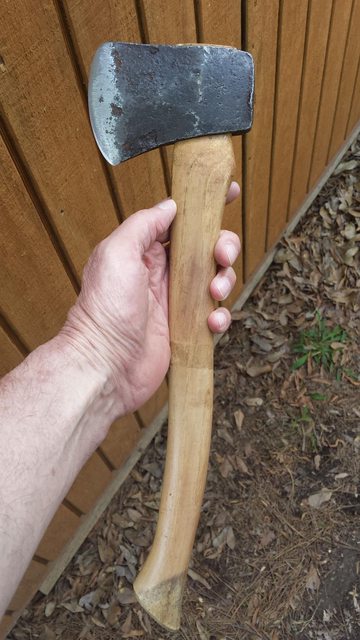

Why the upturn in the handle and why no swell?
My understanding is the reason you use a saw and cut the kerf is to prevent traveling of the split. Even if everything goes well with a split not sawed kerf, the moisture then dryness, shrink and swell, hot and cold will allow the split to travel. Unlike a cut, it has no bottom. Nice looking cross wedge though. I do not use them. But I find pleasing to the eye. And can see how they could be of use to fill a gap larger than the handle can.
Unless of course you mean you split the wedge with a chisel. In that case just ignore me.
I'm betting that is what he means. Drive the cross wedge, split it, then drive the main wedge through it. Kerf as normal.

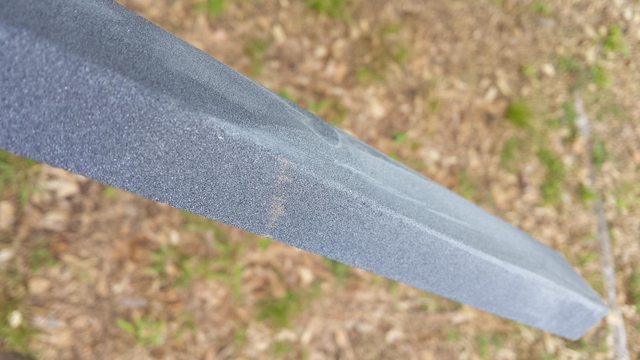

I love filing.
Very therapeutic, isn't it?

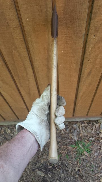

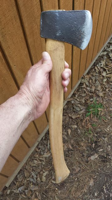

Almost done with this one. Just gotta' finish the last couple inches of fitting. The first offset handle I made for this head is fine, and I'll continue to use it as a beater handle, but it was a rough proof of concept and I had made the mistake of using the factory handle as the basis for the template when I was really able to put a slight bird's beak on the butt end. After I get it seated then I'll be cleaning up the lines and getting the shape of the gripped regions just right in the hands.
