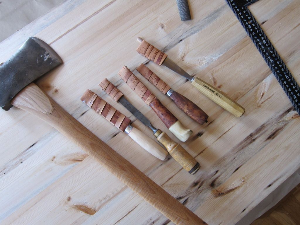

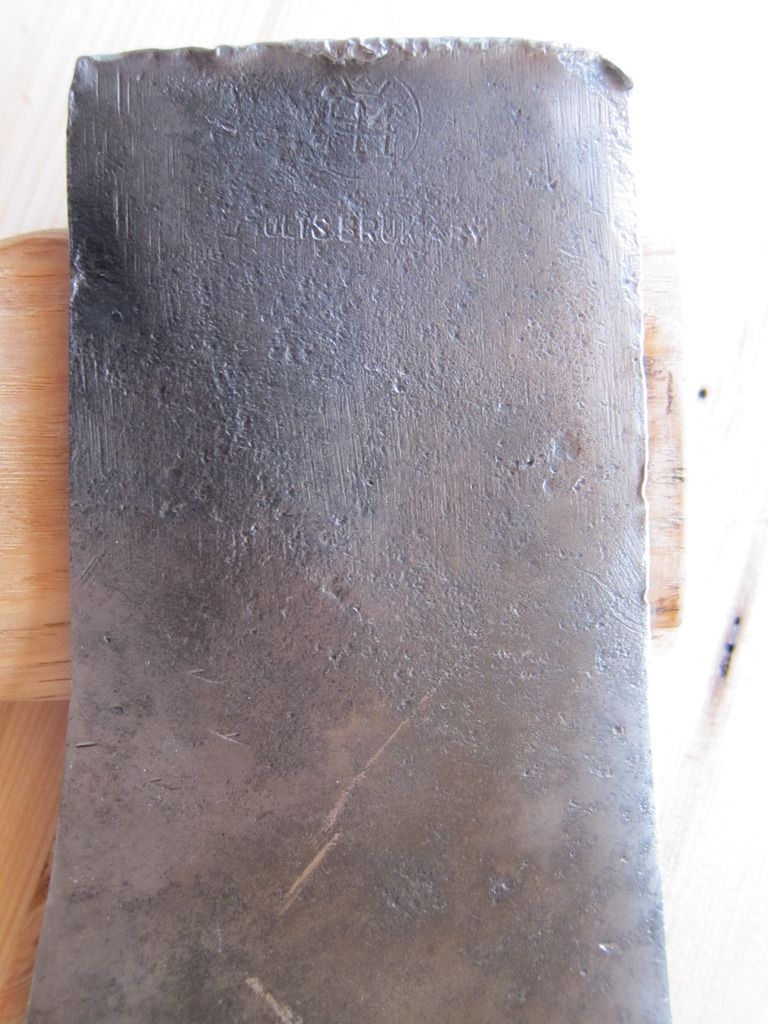

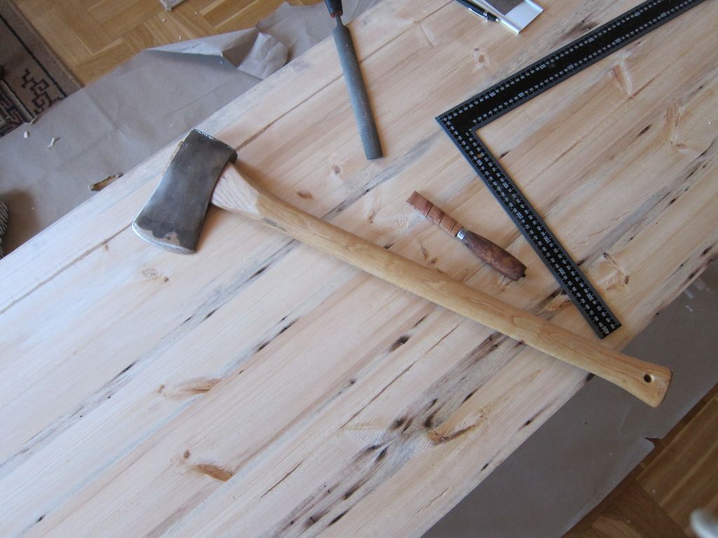

Aikonen, that is a fine looking set-up. The straight handle seems to fit the whole package. Any markings on the head itself?
I have to convert mm to inches either online or grab a tape measure to be sure every time - Standard system hold-out. So, about 29 inches?
Did you do the bark sheath there on your carving knife as well?
I think so too, it turned out really well. Here's a photo of the mark, I had it sent away to a friend who did the electrolysis thingy on it, he told me he believed it was about a hundred years old since the marking said HM, which he told me was Hults Manufakturi. Below the stamp it says Hults Bruk Åby.
Sorry about that, I was going to write the length in inches but then I remember that metric is superior, LOL, Jokes aside I didn't have my tape measure so couldn't remember how many inches it was.
Yes, I make a couple for my blades that does not have a sheath, it's a nice craft and fun to do. Once I tried to make a bark sheath for my axe, it did not turn out so well. :rolleyes:
