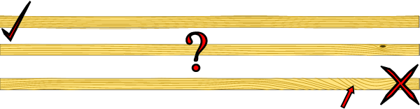

Grain orientation referred to growth rings running bit to poll if you are looking at the butt of the ax handle. The argument is that that is the best for strength. There is also an argument that running at something around 12° off is best. Yours is running side to side. The runout is when you follow the growth ring running down the handle and it literally "runs out" of the handle before the end. The Heartwood in your handle does/accentuates that this is happening in your handle. You want to be able to follow as many as you can from inside the eye all the way to through the handle.

Ideally you want the grain orientation to be running back to front, not side to side like yours.
So if you look at the bottom of your handle, see how the growth lines in the wood run side to side, not back to front?
Ideally the grain direction should run something like as in the image below (not my image)
Couple of reasons for that. Firstly, imagine over striking or missing the target and hitting the handle below the head. If the grain runs side to side as in your image, then "layers" could easily delaminate from each other. That cant happen if the grain is the other way around.
Also, the handle will be much stiffer with the grain running front to back, as it will help is resist bending in the forward/ back direction.

I didn't say anything about the grain orientation, only the runout. Orientation isn't as important on a straight haft as it is on a highly curved haft.

I've tried to "dissect" your handle as best as I could from the pictures. Two pictures of endgrain are overlaid on the first picture of the side view of the whole handle.
The bottom of the handle (lower left) is a view of the endgrain from picture #4, looking in the direction of the arrows.
The end grain at the top of the handle from picture #3 is shown at the lower right looking in the direction of the arrows. This image was flipped. It's meant to simulate what one would see if a slice was taken from the top and observed in the direction of the arrows.
What I see:
1. from the side view the grain appears to run straight.
2. the endgrain views show matching grain patterns on both ends.
IMHO, that is what I would call a straight grained handle. And good on you.:thumbup:
Here is another handle with the picture done in the same way. Not what I would refer to as "straight". YMMV:)
