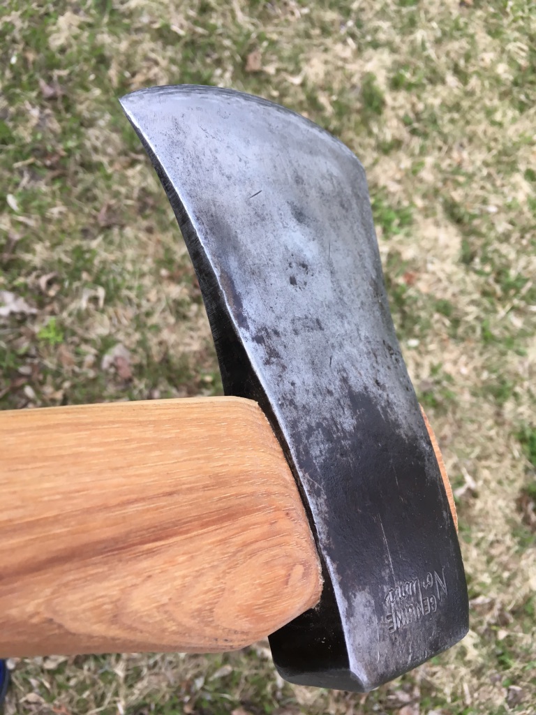

This is as far as the softwood wedge was going, you can feel and hear when it's done. Also it blew a chunk off to the side. That's a sign.
Seated head, before wedge.
After cutting it flush, sanding it, and more blo.
Pre wedge
Wedged, trimmed, blo.
Got a little gap up front. This ax has been abused!
Tomorrow I will try to "convince" the wedge to become recessed.

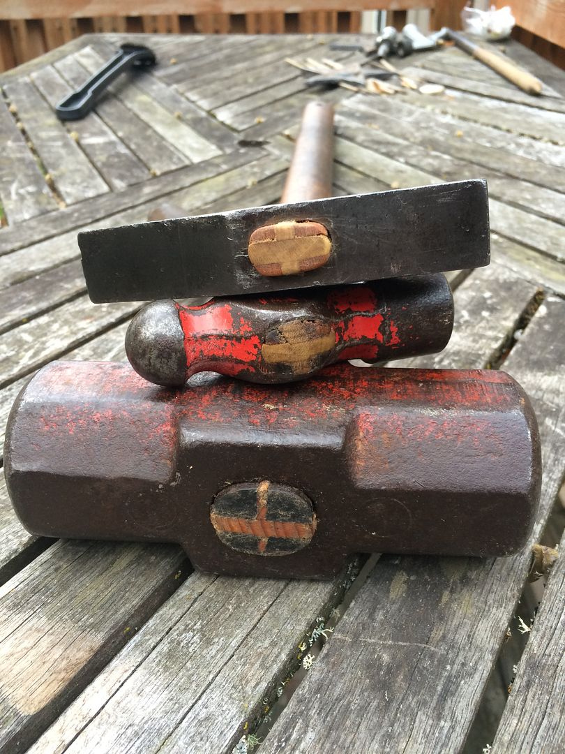

I have a quick question for y'all experts of tried rehanging this hammer twice and both times when I wedged it the handle split on the othe side down the middle am I doing something wrong ? Maybe too thick a wedge?
The wedge is designed to lock the handle on to the head via expansion, but only at the front on the eye and not the back. A saw kerf for a wedge rarely extends beyond 3/4 of the way through an eye. If the wedge is too thick (shouldn't be very much or any thicker than the saw kerf at the tip) and especially if the handle is too thin (ie overly loose) the expansion then exerts force on to that portion of the handle behind the eye. Aim for a relatively snug fit at the shoulder even before you start setting a wedge.
There are folks out there that swear by induced splits for wedging instead of sawed kerfs but that's an invitation to have whatever split you induced travel the full length of the handle.
Kk thx !
What kind of hammer is it?
The taper on them is different than an axe many times in that they can be kind of an hourglass shape. Too far and you kind of pass that point of spreading it halfway to make it hold the head on to below that midpoint to spreading it at the base too much.
I've split hammer handles when I've cut the kerf too deep, wedge was a little too big, or when the kerf was cut almost in line with the wood grain.
Recently I have taken to cross wedges on smaller hammers - don't know if it's necessary though.
