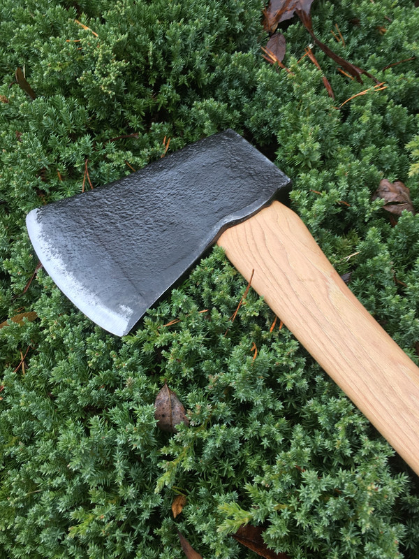

This is a cleaned and refinished army hatchet on original handle, I assume made by American Axe & Tool. The other is a 2.5lb Snow & Nealley on a 20" handle. Kind of a house axe in spirit. I'd prefer the handle to be thinner, but I left it. I'll let the future owner do it if they like. Both have locust wedges and standard BLO/turp treatment.

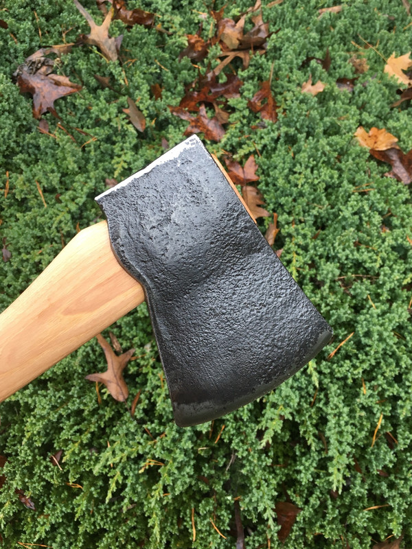

Thanks JB! It’s going to be a Christmas present for my dad along with a Plumb Boy Scout felling axe and a Plumb hatchet, IF I can get them done in time AND if I can let go of the felling axe. :)
It’s similar to S Square_peg Rockaway but admittedly rougher. My dad said he bought it at a yard sale many years ago.

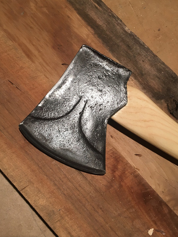

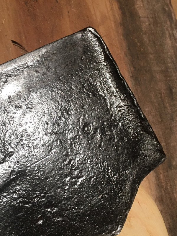

This is one, curious case: Even late models of Plumb axes had decent finish. Possibly made by Mann for Plumb, however the visible hardened line that looks like high carbon steel insert confuses me a little bit. Late Collins Commander axes look bad, but I do not recall any of those to have that line. Maybe it was outsourced to Woodings Verona (Late 90's WV axes have that beyond bad finish). Yeah, Today I am one, deeply confused dude.
Mann used overlayed bits. Therefore, if it's really an insert, you can rule them out.
Mann, I think could be a possibility. And there is more going on there than I thought when I looked at it late last night. Just a real rough die and grinding. Maybe even a knock off.

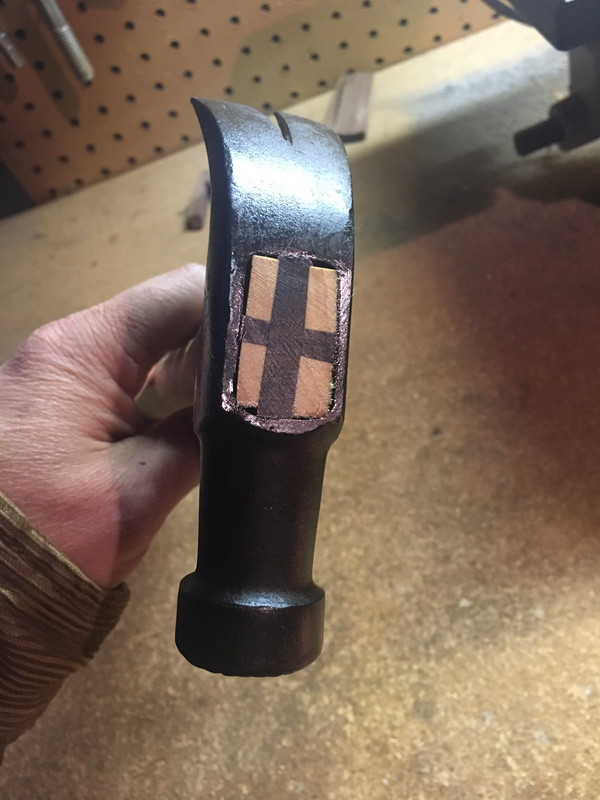

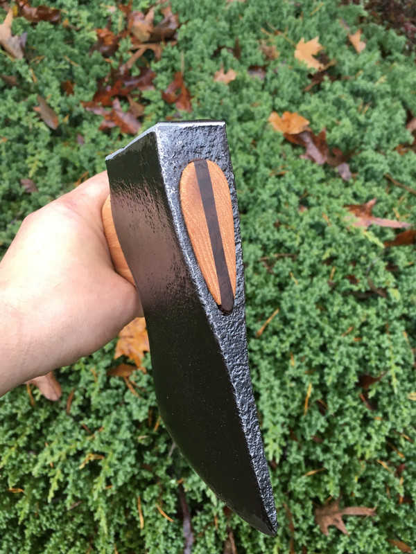

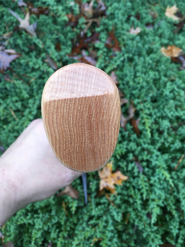

891EF8FA-1121-4241-9790-C6957A32AB41.jpeg 509DFED9-48C3-4858-91BF-F2ADBA03336C.jpeg 4F0D2700-D067-44AB-A353-9EAF671B89E0.jpeg E12558B3-BB80-403B-93BC-CE7A9F84ED61.jpeg EB69531D-E494-4CD8-9A5D-C096F4133544.jpeg Rehung this West German 2.5 lb head. Not a fan of wedges, but the eye had a funny kind of bevel around the top, possibly created at forging or perhaps by a previous owner. I don’t like the cracks around the circular wedge but hope they will tighten up once I soak the eye in BLO.

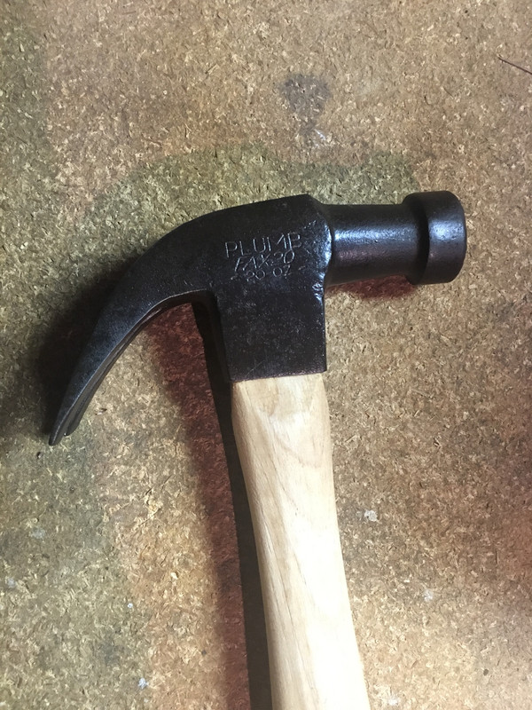

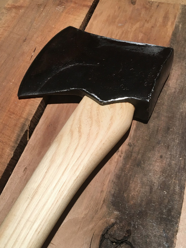

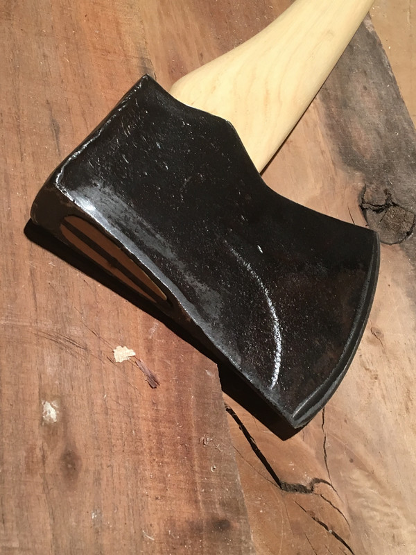

The wife gave me this beautiful plumb broad hatchet for my birthday.

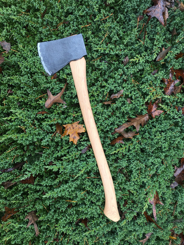

Hfted this 1.5 lb Gransfors head on a 24" birch handle. Carved it nice and thin. A joy to handle.
Did you carve it from a piece of wood or was it a factory birch handle (I understand some parts you can still get these, not sure where you live)? Do you have a full picture of it?
This was carved from a birch I harvested earlier this summer. I will get some better photos of all angles. Our trees grow very slowly up here due to the short growing season which makes for tight grain. One problem I emcountered was when the grain curls. The grain switches direction abruptly and only for 3/8". I am having a tough time keeping it from tearing out at the curl.
