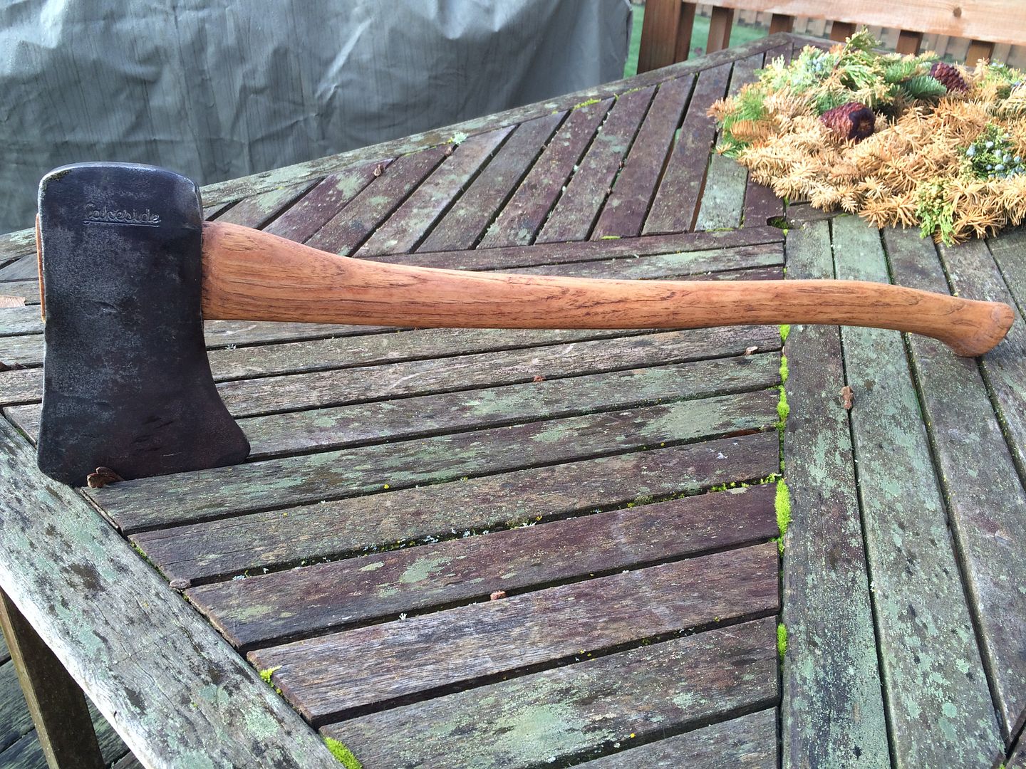

Here is one that I had fun putting together. Lakeside 3.5 lb’er . There is a town next to the one I grew up in that shares the same name – thought it would be worthwhile. Feels nostalgic – probably will have to hide it in the back of the stack when my brother and father are visiting.
The handle was a pig of a stick that I got at an Army surplus place in Boring. It caught my eye because the grain was really good looking. It is a 28” single bit that I whittled down into something more comfortable.
It feels pretty good in hand – haven’t tried it yet but it feels like it would split rounds and be quite manageable.

That's good stuff. I had a bench vise made by that company.

That is a nice contrast. The stain really brought the grain out. I like that Collins. There is one here w/o the 3 1/2 stamp.
Nice work!

It looks great and I bet it feels great, too. I love it when someone takes the time to make a fine haft. Kudos.

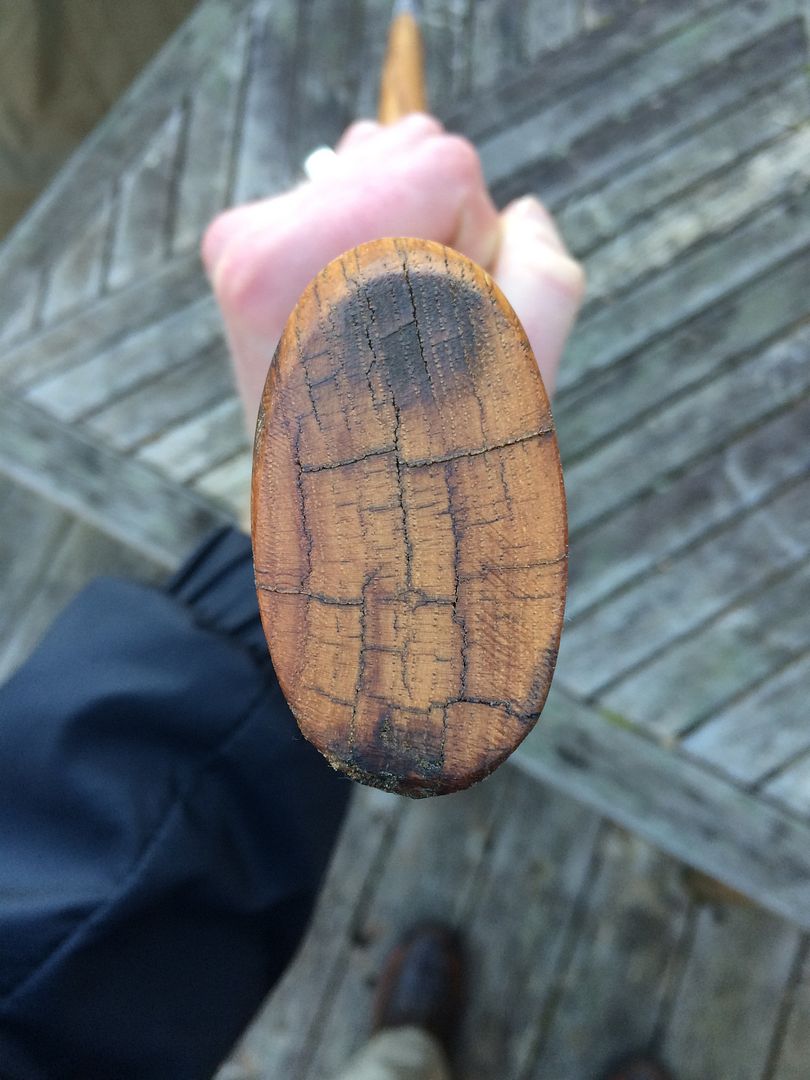

If you want to take the time to do it, you can fill those cracks in the swell with BLO. Applied by brush with the haft in a vertical position a good quantity will get down in the cracks with each coat. 4 or 5 coats applied one coat per day would do the trick. Sand after the 2nd or 3rd coat to help fill the cracks with hickory dust. As the BLO cures it will bind it all together.
JB- Very satisfying indeed. Square_peg - I will give your coat/sand approach a try. Sounds like a winner. This axe is sort of growing on me - wasn't sure about how it would turn out.
