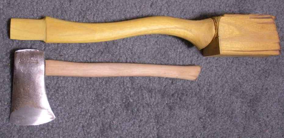

A hand made ball peen from 1958. Apparently my coworkers grandfather gave it to him for Christmas when he was six years old. It had spent the last couple of decades without a handle. I carved this one out of some hedge from the wood pile. Hopefully it holds up.
A Kelly hatchet from WV, and a Wards Master Quality. Notice the similarities?
The Kelly and a no name rehung on the handles they came with. The Kelly handle had no kerf only a large metal I shaped wedge. And the Wards waiting on a new handle. I'm debating between a 16" and an 18" if anyone has any pictures of hatchets on longer handles I would appreciate it.

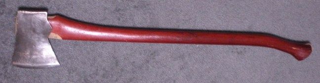

I'm not sure if this pic will help but the axe on the right is a Plumb "Victory" Boys Axe Head with a recycled handle. The bare head weighed in at 2lb-1.6oz and the total with Hickory is 2lb-13oz even. I started with the OAL at 28", dropped to 25" and finally settled on 23.5". Frankly I didn't like my chances at marrying that head weight to anything under 28" but I was very pleasantly surprised. It's light enough for carrying but has just enough (well, barely) to do good work with trails, etc. Because it's a handy size I enjoy using it for kindling.

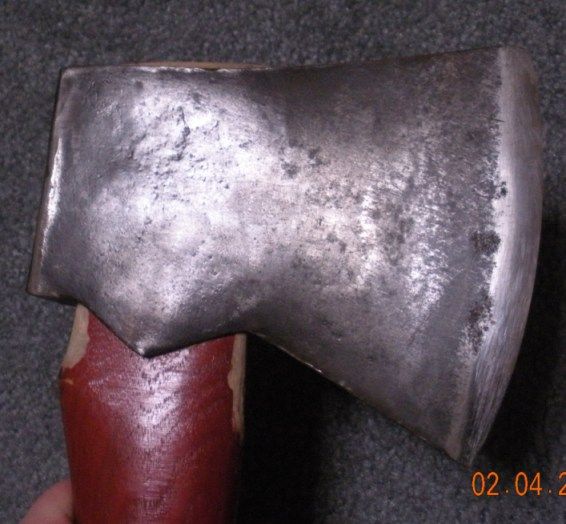

I actually did this one a while back, but just took some more photos. Anyway, I found this no name Jersey head at a yard sale, and couldn't pass it up for only $5. It has grooves in the eye, which proved to be the work of the devil.
I guess this would be considered a 3 1/2 pound head, but it was 3# 6oz according to a scale.

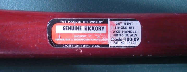

I checked out the local hardware store for a suitable handle, but they were mostly junk modern ones with poor grain and shape. But then, I spied this red painted handle sitting nearby. I brought it up to the counter, and the clerk asked where I found it. I told him it was sitting next to the display of other handles, and he commented that someone must have brought it up out of the basement, because it looked decades old. He even pointed out that the label on it said it was made in "Crossville Tenn.", not TN, so it was made before the postal system switched to using two digit state abbreviations.
I had a heck of a time getting the head to seat, and ended up causing a split in the base of the handle, which I patched up with glue and a couple screws. I was carefully rasping it as I went, so the handle was not too big; it just didn't want to move with those grooves in the eye trying to dig into the wood. I don't think it's gonna come off.
I reprofiled the edge and sharpened it up- this steel is quite hard. I already used it to chop a 10"-12" thick mulberry tree that had fallen over the edge of the bean field, and it really throws the chips.

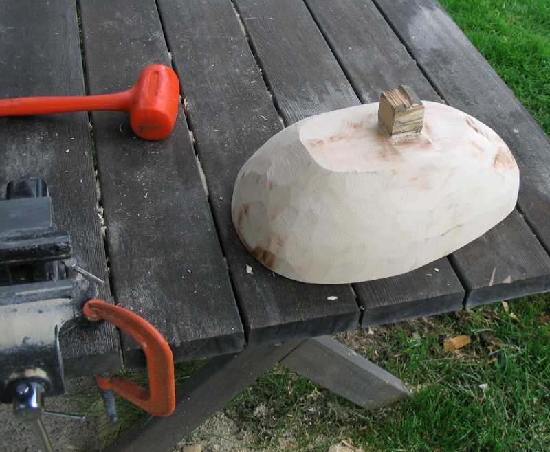

Here's one I'm currently working on. Dad brought home this little Craftsman pocket axe from an auction, for $4. (he also brought me a nice vintage Plumb scout axe for the same price) The thing is tiny. Someone made a handle for it out of a scrap stick, and it's literally smaller than my pinkie finger, and doesn't fit the eye well. So I went out to Dad's pasture to look over the post pile, and found a big log of hedge wood (Osage Orange) with straight grain. I used my chainsaw to cut out this block, and started shaping it that night with a drawknife and rasps.
On a side note here, I have to say my new Iwasaki carving files are simply amazing, and I highly recommend them to anyone who has a lot of wood to shape. They actually carve faster than a draw knife, but with all the control and versatility of a rasp, so ya don't have to worry about tearing out the grain by going too deep with a blade.
I also started reprofiling the edge, since it started out more than twice as thick as my Swedish made hatchet. The steel on this thing is very hard for a hatchet- I'd estimate around 57-58 Rockwell; files were about useless on it. I still have a ways to go with the stones, but won't put the final edge on until I have the new handle fitted.
It will be a while before I post any finished pictures. Now that I have the handle roughly shaped, I want to let it dry indoors for a least a month, so I don't have to worry about it loosening up with shrinkage.

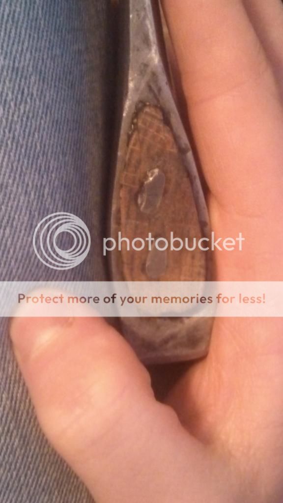

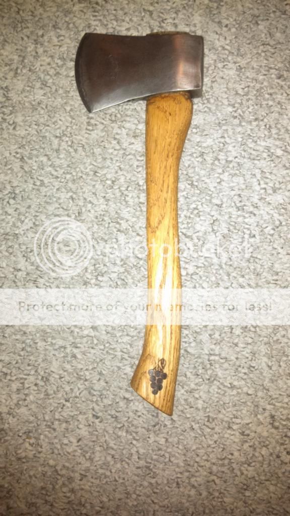

I have just got into axe restoration I love it I made this handle out of oak. I love this hatchet I restored. I used two metal wedges because I was worried about it coming loose.
This was my first time hanging an axe or hatch Idk what to seal the grain with I was told not to use varnish I did use some stain. Please give me some advise.
Looks good! A few coats of boiled linseed oil would seal it up nicely. Your oil stain no doubt had some linseed in it already.
I like the little 'grapes' logo you put on the handle.
Yeah my last name is Graper. But no I haven't put oil on it. I put some stain on it though and I burned in the logo.
