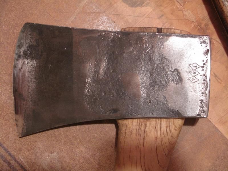

JB- I like that axe. It's got old charm. The handle, is it a full-sized just cut down?
Yeah me too! The handle is old, but the head is OLD, so I'm almost certain that it is an old replacement. I don't know the maker or the history of the head, and it looks like the poll was ground to fix mushrooming long ago before mushrooming again. Any maker's marks are long gone, but that's OK- this head has history. Given that, the handle and the eye wood is probably in too good a condition to be original, but like I said, I think that it is also old. I think that the handle was intended to be it's current length, as it has a swell that would not be there if cut from a longer handle. Also, it's thin just beneath the head for a control grip that you don't see on full sized handles. I think that this was a replacement handle intended for this type of axe.
This whole thing is like the ugly mutt that you just have a fondness for. I'm going to carefully grind the poll and put a nice edge on it and make it a proud tool. I probably would not take it camping as it weighs 4lbs, this would be for my firepit at home. My current camping favorite is a 19" 3lb (w/handle) Kelly Red Warrior.

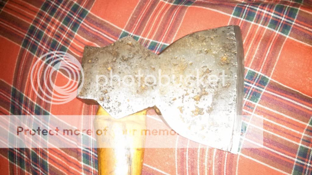

I just rehung this its a plumb it is anchor so its older my friend found this at his farm in the ground.

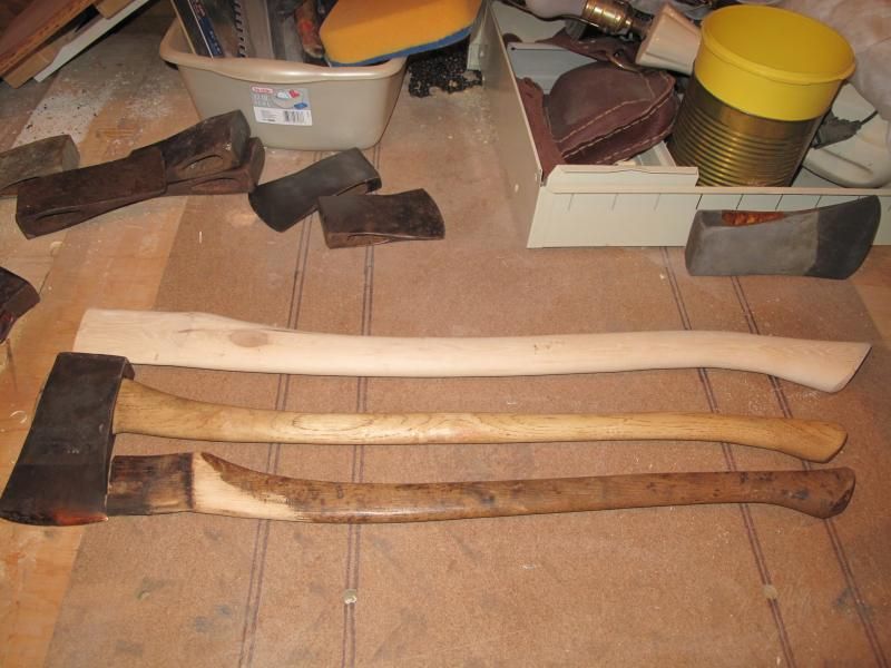

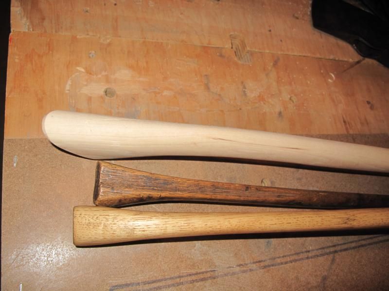

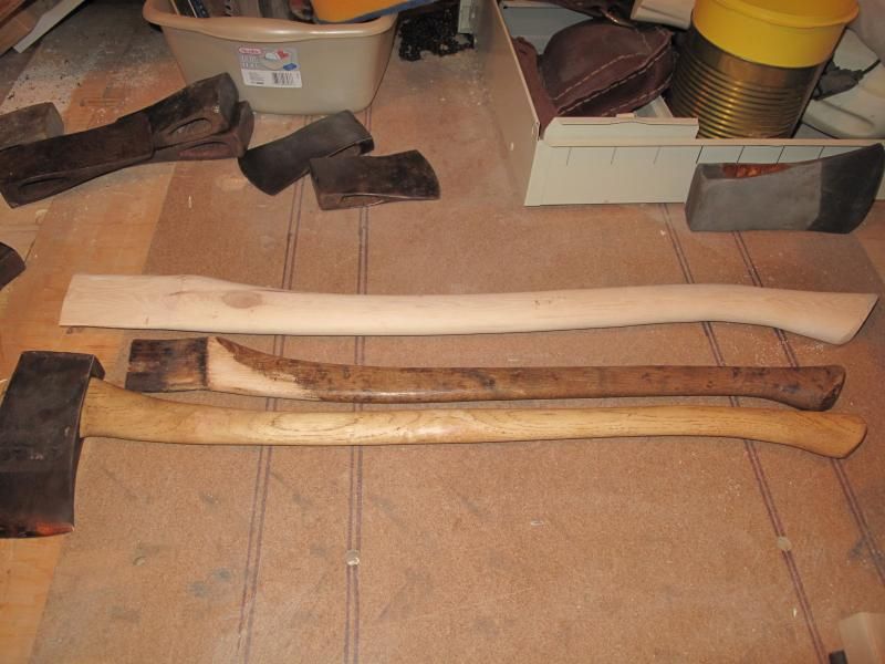

I really like this 2 3/4lb Maine pattern TBA. It was in excellent shape but the haft was too short for my liking. So I slimmed down a grade 2 fatty and tried to straighten it out some to more closely follow the old haft & knob. Finished out at 3lbs 10oz and 30" long. Tools used- hatchet for roughing, draw knife and spoke shave, Kearney and Foot toothed half round rasp, four in hand and sandpaper. Edge needed only light filing, stoning and paper for a fresh edge. Excellent balance and feel. Does have a couple of small knots that may end up being issues but for now, I like it. A LOT of handwork and no masterpiece in the end but satisfying. I need better handtools- spoke shave is cheap and no adjustments. I also need to work on my jig for holding handles while working.
Bill

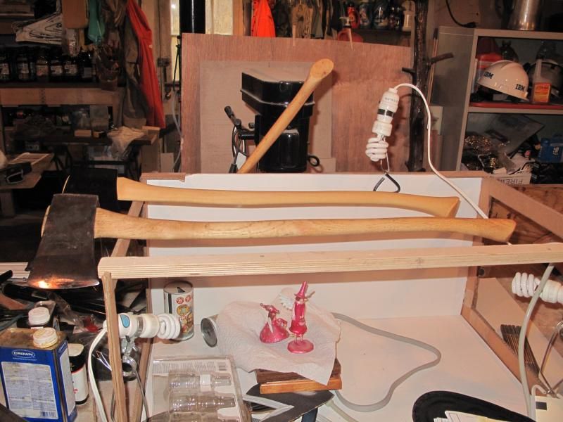

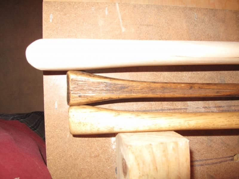

Good lookin in here folks. Bill, that new stick looks good. What is the other new one that is also in the pics? Looks like enough meat on that thing to get a nice shape from.
That is a twin to the one I used to make the new stick for this head. They are 2nds sold locally at one of our flea markets. I became friends with the man and get them for 3 or 4$ each. I am not sure where he gets them, maybe 1 in 4 has good enough grain and straight enough to be useful. Most have at least pin knots or small inclusions but they can be worked into good handles.
Right now I have a few pretty decent HH 32 and 30" handles to play with :)
Bill
