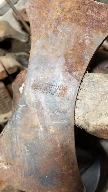

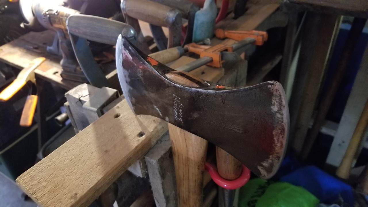

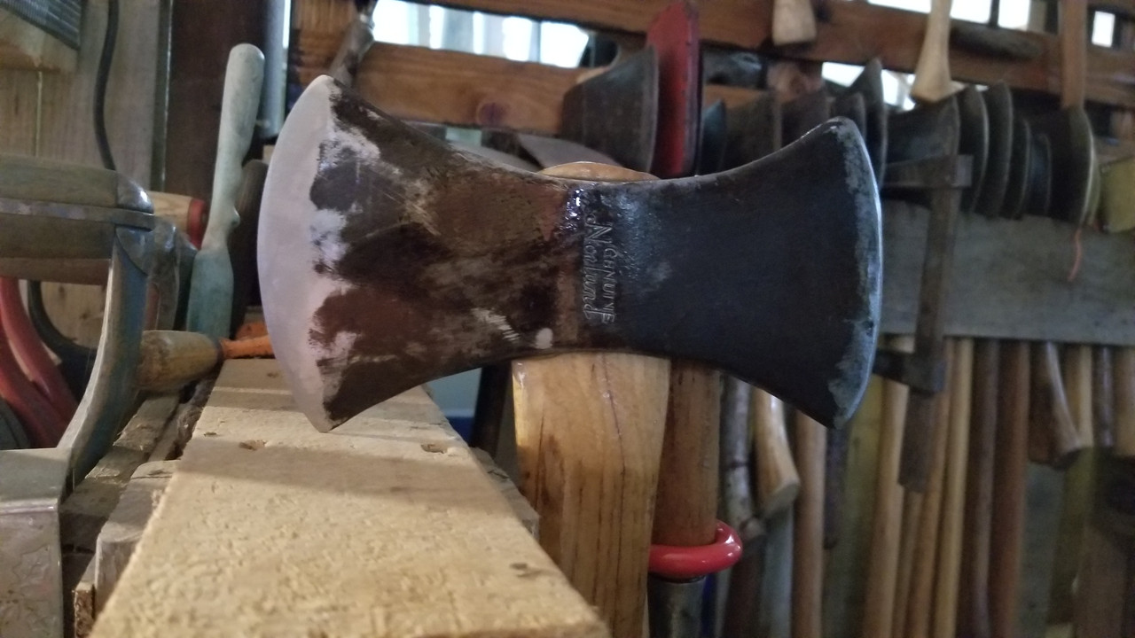

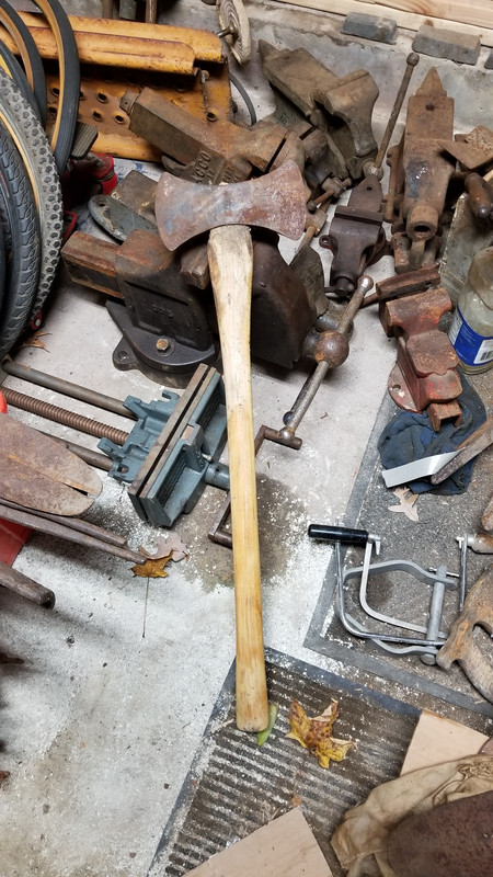

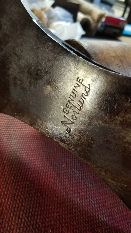

My Great Grandfathers Craftsman Hewing / Carpenters Hatchet, brought back to a usable life after many years.
The haft is an 18" House Handle, hand picked, no Finish and Octagoned that Chris House described as an Old School Broad hatchet handle that he had a limited amount of. Finish is two hand rubbed coats of Minwax Tung Oil Finish I had available.

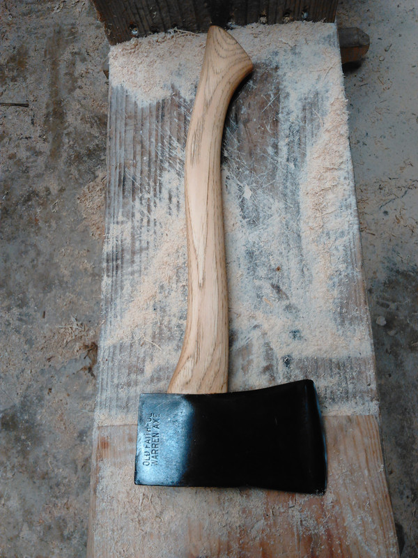

Rehung a Mann hatchet head 1944. Very nice, had to grind down some of the mushrooming on the poll but that was about it. Cutting edge is 3.5", so a little wider than my other hatchets, weighs in at just under 1.5lbs. So far haven't added any steel wedges though I might. finish is just a waterbased stain with oil over the top.
Put it on the belt grinder to bring the edge back (I'd swear it has not been sharpened since it was first issued/left the factory) as it appears to have been used as a root chopper and hammer primarily. The original handle had four screws driven into it and a healthy layer of old duct tape as an overstrike protector. Saved what was left of it for making knife handles later.
Normally I would do all the rough work with a file, but this is (surprise) heat treated to a higher Rockell than my hardware store hatchets and machetes, the file was 80% skating and I didn't feel like that kind of a fight. Still need to finish it off by hand, it should just fit a Snow and Nealley hatchet sheath. Is going to make a great backpacking chopper.

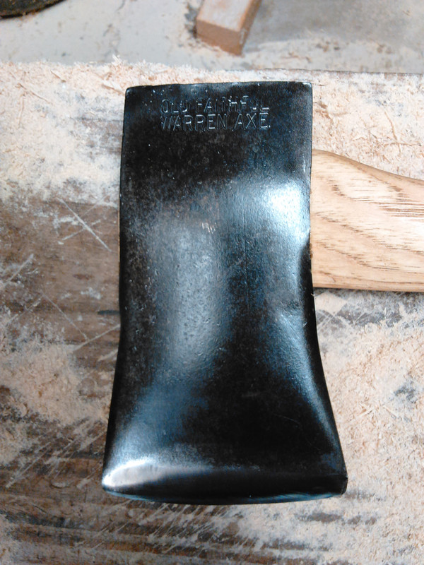

Here's the Red Knight filed, honed and hung;
This haft was painted white I believe from a factory.
I was pleasantly surprised to find white oak under there! My first white oak helve. It's closed cell and has long rays as opposed to the open cell and short rays of red oak. Here's a couple prior to final seating of the head;
Has very near 100% contact at the bottom of the eye and fairly decent contact up from the bottom. I've done better but I hung it up off the shoulder a ways so there's plenty of room to re-hang when it comes loose in the coming years.
You can see I was a little rushed to get this hung last evening and didn't sand enough off the sides near the back of the tongue. So my wedge was driven forward as I drove it home. It's all good though it won't be a major issue. Wedge is driven in hard two and a quarter inches out of the two and a half available in the kerf.
Here's some of the beautiful rays...
I have to say I'm pretty smitten with this white oak. It works even easier than red and it's lighter. But according to those who know it's actually a little tougher! Good stuff! The steel on this axe is comparable with Snow & Neally vintage stuff. A good temper. Anyhow another connie! Gotta love that! Take care guys!
