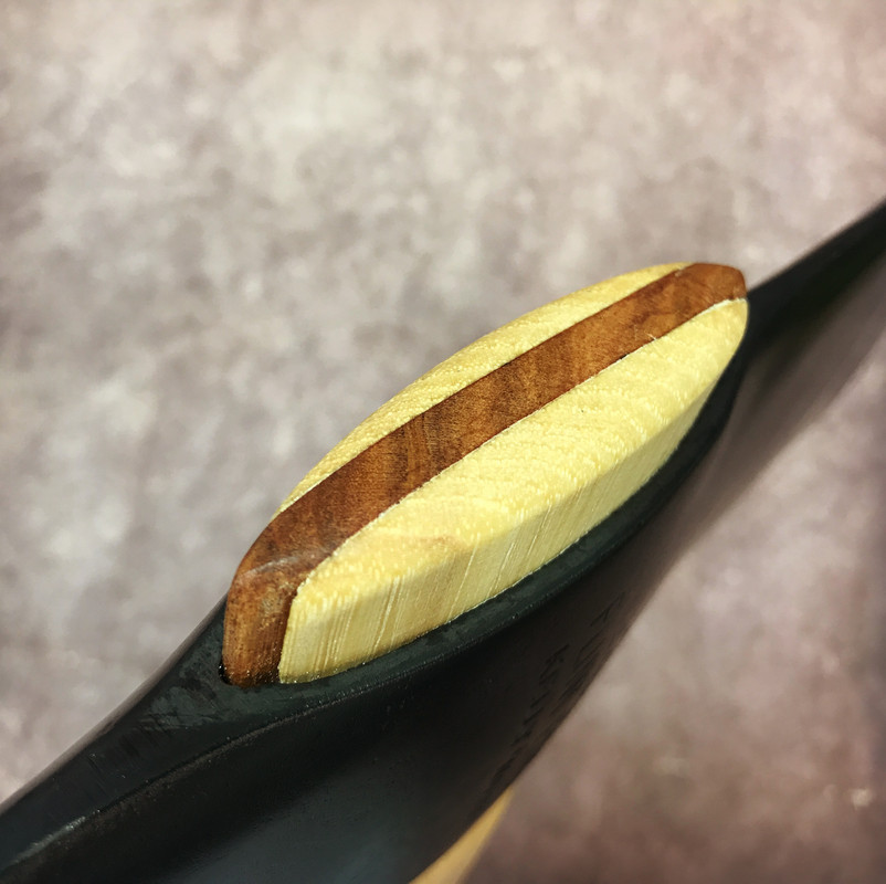

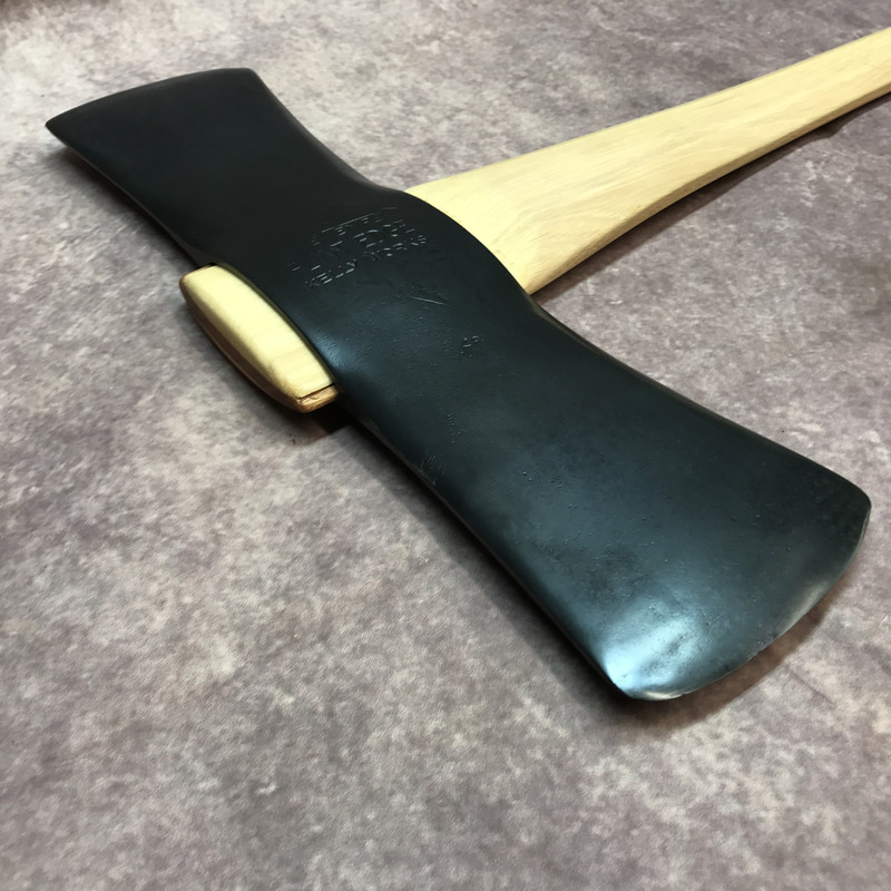

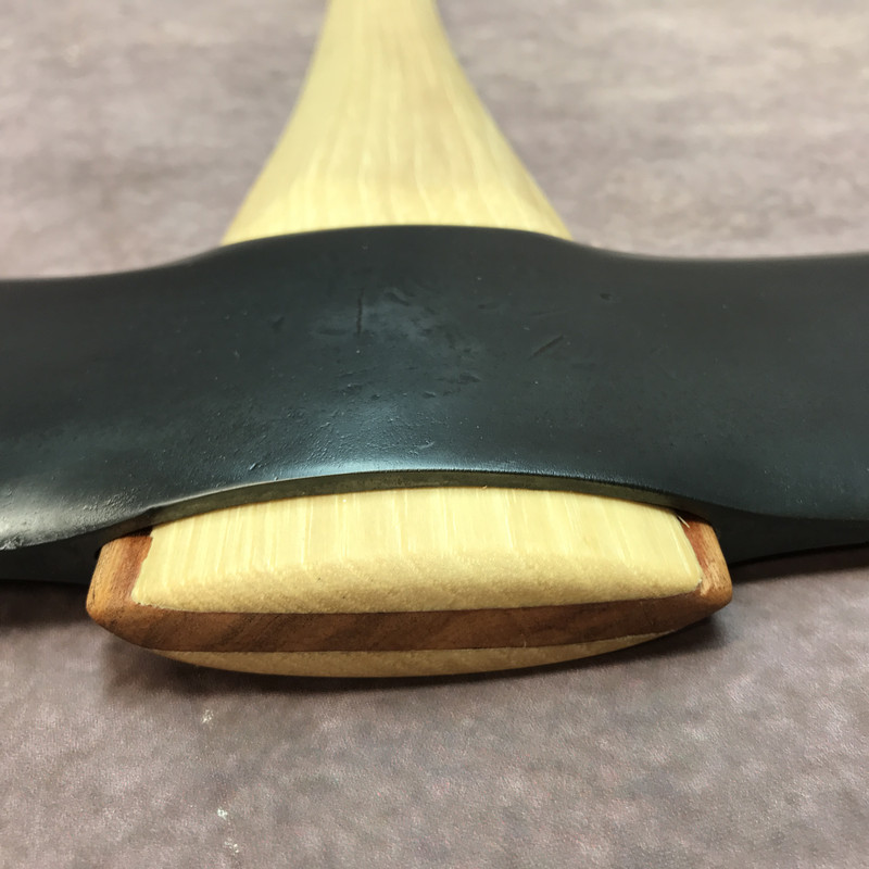

Filed and honed this last evening and hung it a couple hours ago. It's one of the nicest axes I own so hopefully you'll all indulge me a few extra photos!
I seated it home without cutting the kerf. Did that last.
The previous owner beat on the tip of the fawns foot to seat another head. But never cut a kerf so he gave up I guess. Unfortunately that's kind of messed up. I did use my swell saver tool so as not to damage it more.
I've had this haft for around a year waiting for the right axe. It has a stamp on each side seen here;
Never have been able to find a description for the "AR" code. Have a great afternoon and thanks for looking!
Edit; in case anyone is wondering, I hung it up off the shoulder on purpose. Doing this means I can reuse a haft at least twice. And this one is pretty nice in my opinion and worth keeping around as long as possible!
Crazy! Just crazy! That’s gotta be your favorite axe!?
