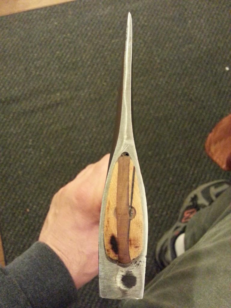

Finished hanging my ship carpenter's axe/masting axe. 21 inches long black locust with a red oak wedge.
I could only find a few images of this type of axe with handles, and they were typically very short. At least one of the images I found had a straight handle, but I'm not planning on using this on masts, or in a wooden boat. So I put a bent handle on it for hewing. I've not seen many broad axes with swells on the handles but I had plenty of wood so I put one on. I can't wait to see what it is like to hew with this axe.
Spectacular! It looks like Locust makes a great handle based on the grain characteristics.

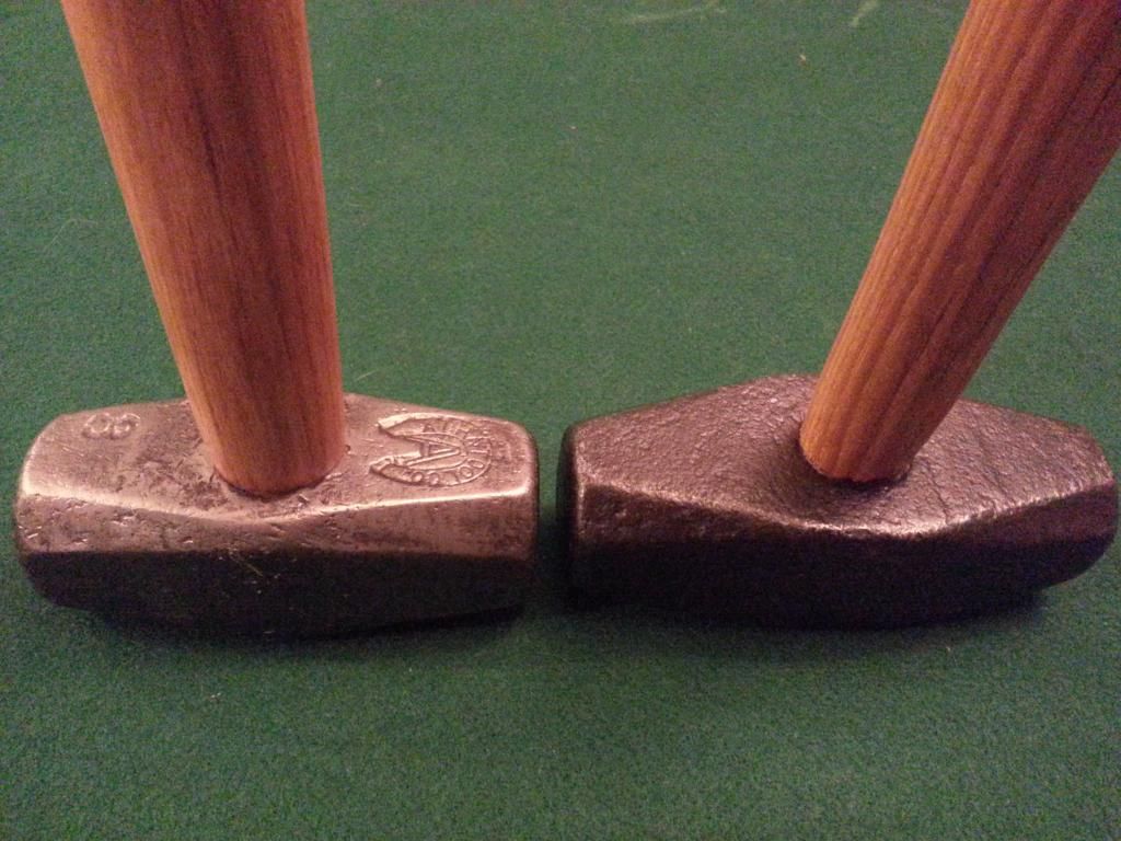

Well they arent axes but they are all mainly late 1800's plumb blacksmith hammers
they are YERKES & PLUMB and FAYETTE R. PLUMB CO. marked
, and one champion DeArment 3lb ball peen, and a 10lb true temper sledge
I have a bunch more to hang they were my grandfathers

A man after my own heart. I don't want to go find a hammer forum, and these are closer than cousins to out beloved edged tools. I'm very cool with people posting them here but would understand if anyone objected. If anyone does, we should have an Axe Forum sub-forum.

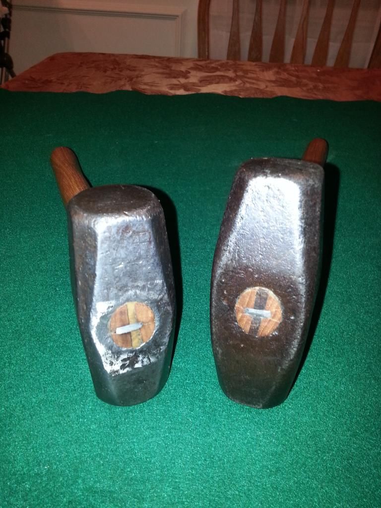

These are what I think of as the Klitschko brothers, Dr. Ironfist and Dr. Steelhammer. Brothers, because they share handles recreated from a single 36" dry grey 8lb sledge handle that had spent many years outside. I cut it in half and shaved dead wood until the good stuff was reached, and thinned them until they were good fits for these 3 and 4lb heads. These are 14.5" and 12" long.

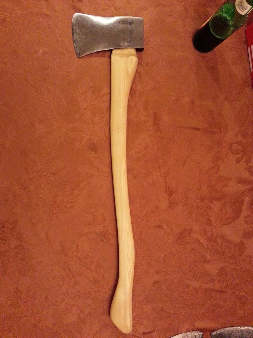

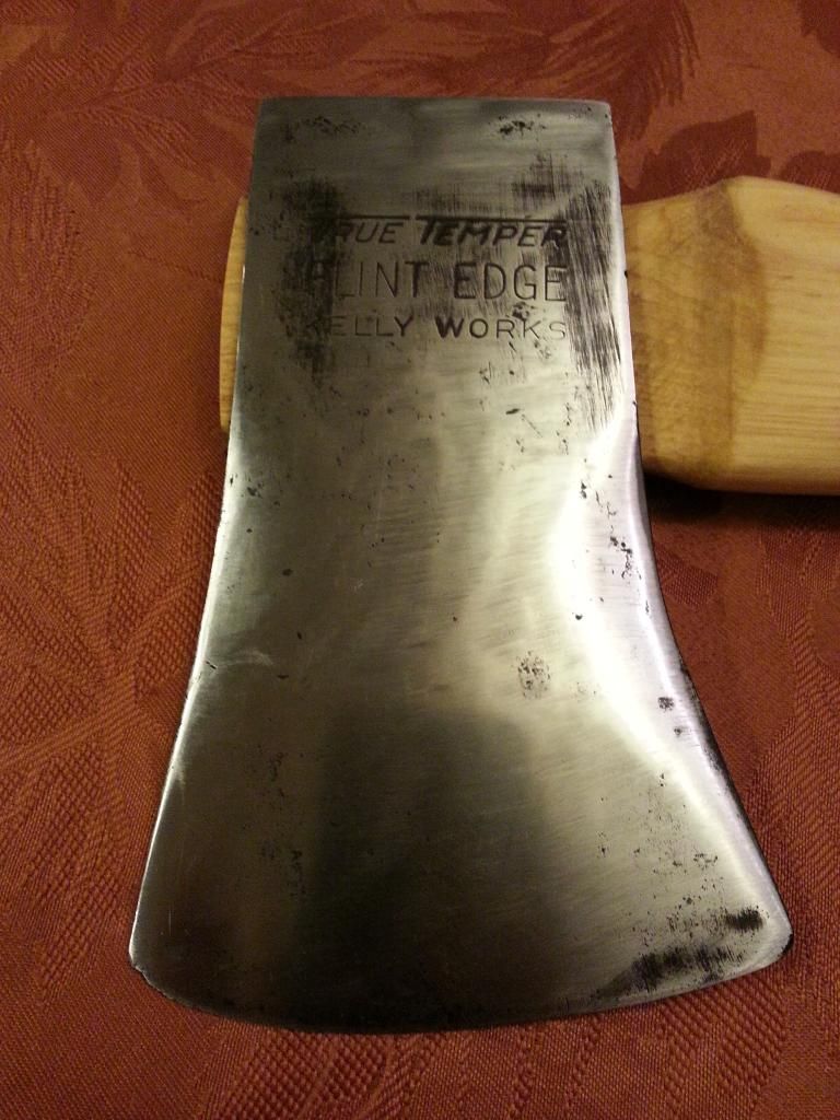

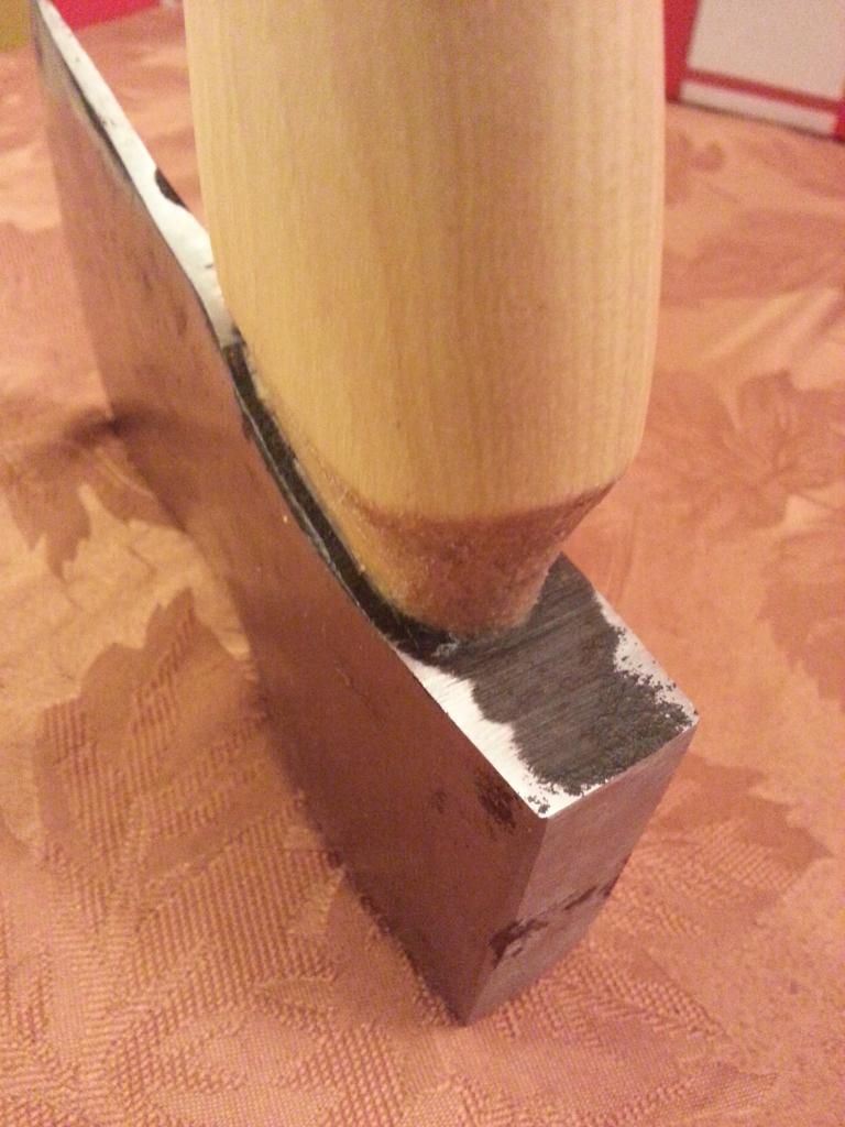

It's nasty cold out today, so I decided to hang my old Kelly Perfect 3.2. It has been lurking around the wood shop for a few years. Got it cleaned up, sharp, and back in service.
Looks great. Textbook hang. Perfectly seated on the shoulder.

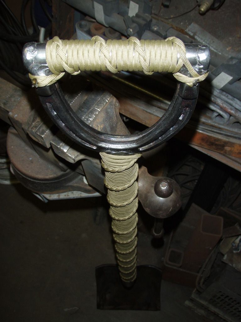

Slight difference in handle material, though I finished the rough-in today. One layer of clearcoat to keep the oxidation at bay is all I chose to give it. I am wrapping the 'D' handle now with 550 cord, I may also do the shaft if I have enough cord.
Edit: I had just enough cord! All done.
