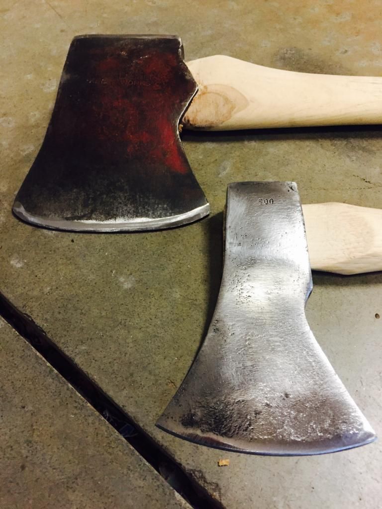

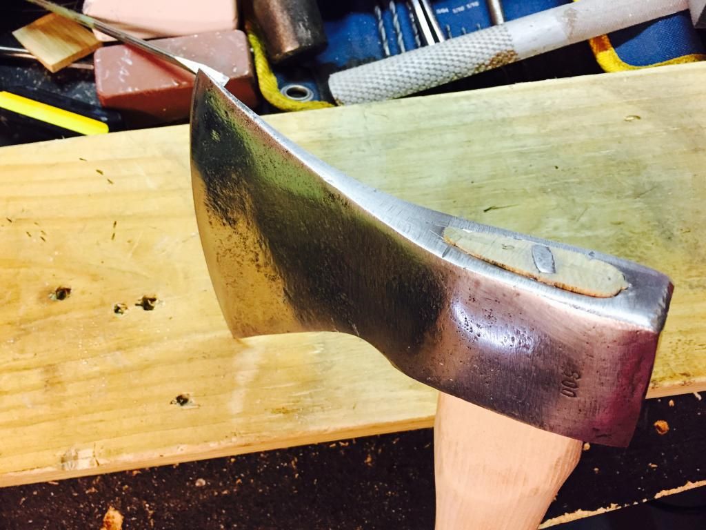

An old hand or drop forged Wedgeway/Morley Bros. This is the first nice axe I've restored and I really tried to take my time with it. There was a lot of rust and pitting when I first got it so the project was pretty time consuming. Handle is a 32" from House Handle.

Nice axe, have not seen that mark before. And, nice Michigan! Is it wide? The second pic makes it look like a Connie.

hutch, nice job. I don't know who made that axe for wedgeway(do you?) but it reminds me of a Plumb. Really nice.

I'm not sure who manufactured the axe either. I did some research on the Morley Bros. hardware suppliers but I don't believe they ever manufactured any axes themselves.
I'd call it a Michigan pattern but it is pretty wide. The bit was more curved than that when I got it and the toe is still too far back for my preferences but I flattened it out as much as I felt I could without taking off too much metal. Since I'd never handled an old axe much I wasn't familiar with the old American style of high centerline, convexed-cheek heads. So initially I thought it was way too thick but after learning a little more about that style I guess it made sense. And being that this axe was from the northern midwest where it could have been used primarily for big hardwoods the thickness of the bit makes sense now.
That looks nice, and familiar. Is it hatchet sized? I have one with an identical looking head and am interested in where it comes from/who makes it. Know anything about it? Could you post a top down shot of the head?
Thank you, I actually know exactly what ax you are talking about. You posted a thread about an interesting ax you had come across a while back. I had offered to post a picture of this head prior to hanging it as it looked to be the same as yours. It's an odd one. The weight on my fish scale was about 1 lbs 12 oz the eye was definitely in the boys axe range as are most of the other dimensions. The eye itself was imperfect in such a way that it almost came across as hand forged, while the rest of the head was very uniform minus the obvious rough finish. I opted to hang mine on a 19" house ax handle as it came to me head only.
Unfortunately I don't have any additional information about the origins of this ax. If I recall someone in your thread had stated that they purchased one as military surplus decades ago. I have seen similar surplus ax heads so I see this as the most likely possibility.

Close, but not the same. Mine is 1lb 6oz including the handle, also seems like a thinner bit, and the poll shape is different. Mine tapers in. I can buy the surplus idea, but I don't think that mine is American surplus. Ah well, maybe I'll learn, maybe I wont. I'm trying carving with this one.
Interesting, the poll on mine was a little mushroomed so that could have obscured the original shape. Your poll looks longer, and mine wider. If you don't mind me asking what is the size of the eye on yours? Its almost like mine is the boys Axe size and yours a hatchet. One thing's for sure they are quite similar. Good luck with the carving, I've used another hatchet I have for roughing out some work. It can be a lot of fun.
