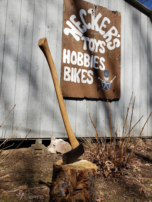

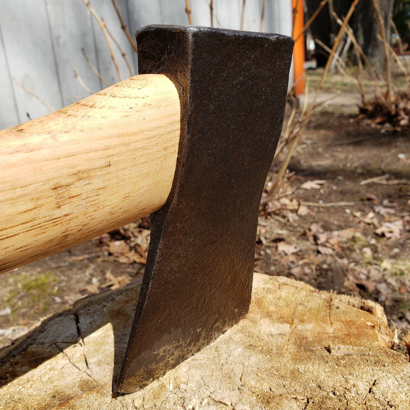

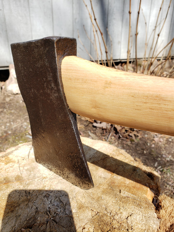

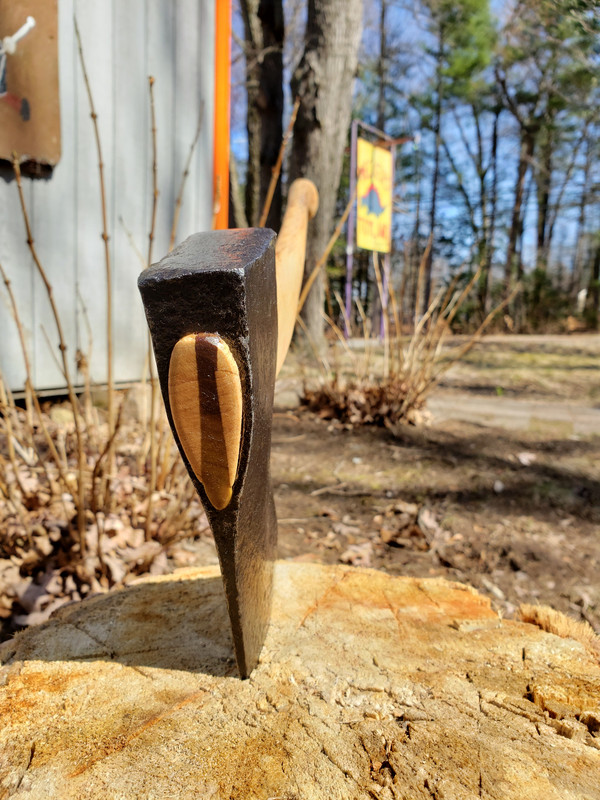

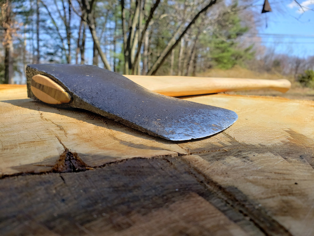

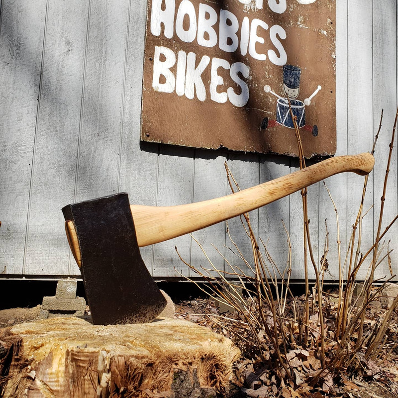

Did this one for a friend at work. Finished over the weekend, took me this long to figure out a new photo host, then figure out the embedding.
Wood was a tiny hickory trunk that he had already, wanted to use it rather than some osage I bought for other projects. Came from a family farm I guess. It's nice dense hickory, but I'm still not sure it will last. Either way, its good to practice, and I'm a bit interested to see how long this one lasts.
Here's the other side (and the reasons for my dubious outlook!)
Here's the older axe that was the inspiration for this handle
I deviated quite a bit on the swell, I went for comfortable grip.

Eh, so it's not an ideal piece of wood, big deal. I think it looks great with all the mix and variations. Good work, and yes, it's always great to practice! I'm a firm believer in use what you have. Is that a newer Snow and Nealy head? What's his primary use for that axe? What's the OAL it ended up at?
Visually I do like the wood. And yeah, if he breaks it I'll just make another, maybe with some better material.
It is a new S&N head. I have another I'll hang for my own use and see how I like it. The owner of this one does a lot of camping and guiding for a hunting outfitter, idea was for a general purpose light ax. OAL is around 22" or a bit more, didn't measure but that is about what I was eyeballing - short enough for one hand if you're coordinated, long enough for two if you're doing light limbing or something like that.

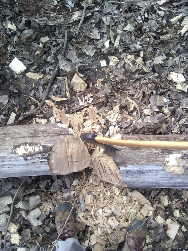

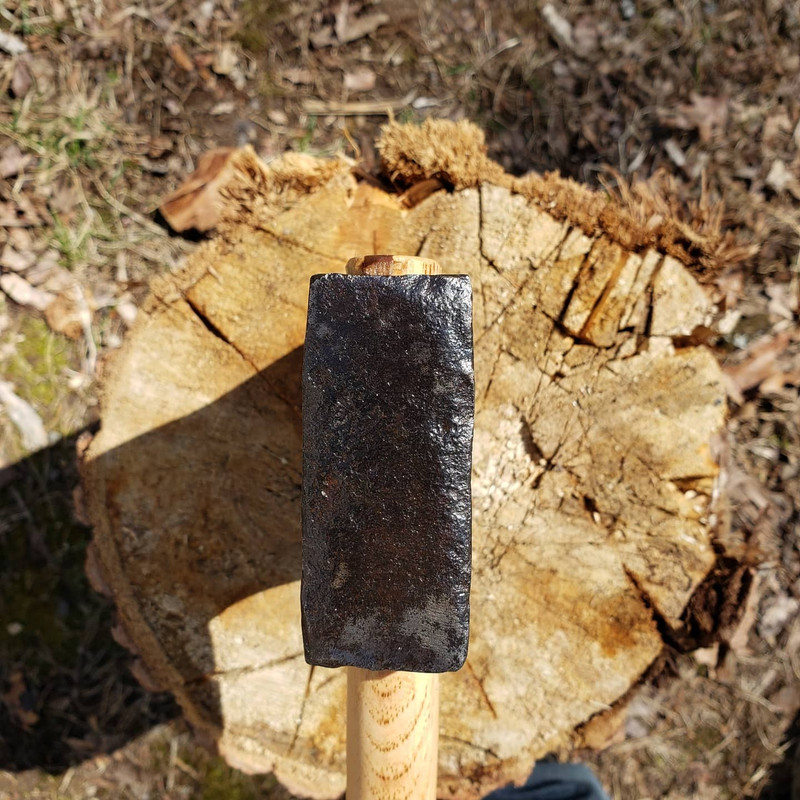

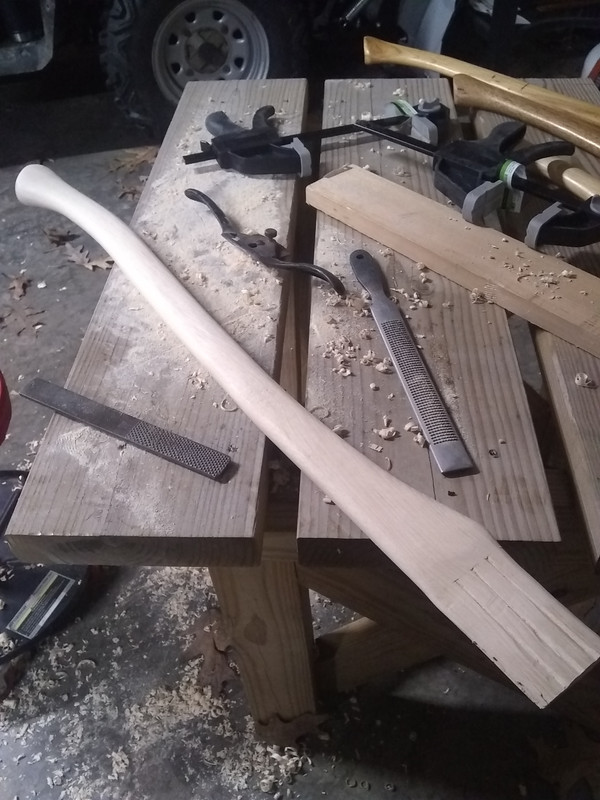

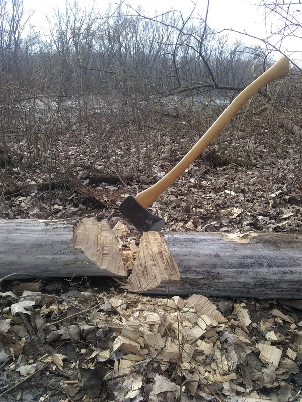

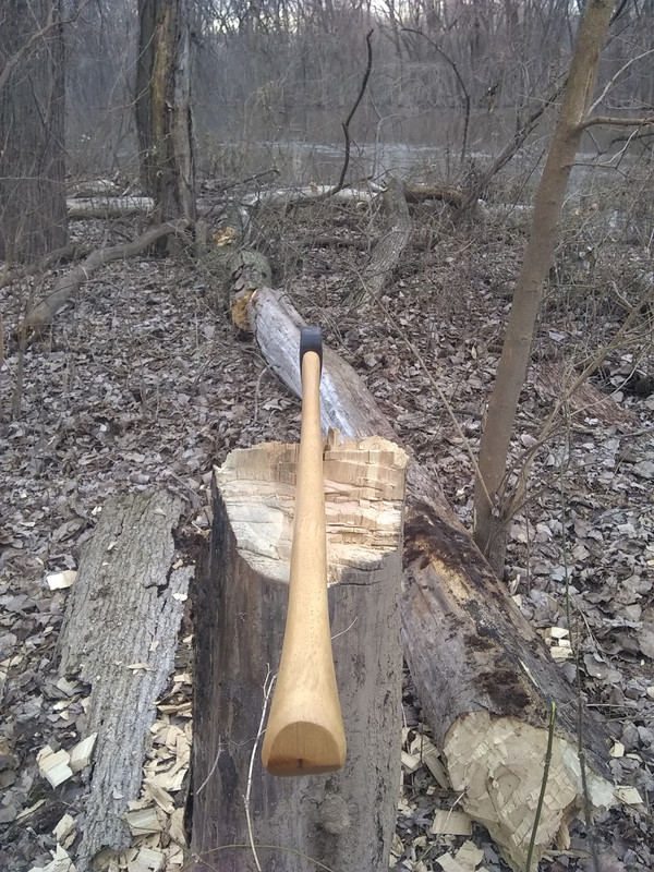

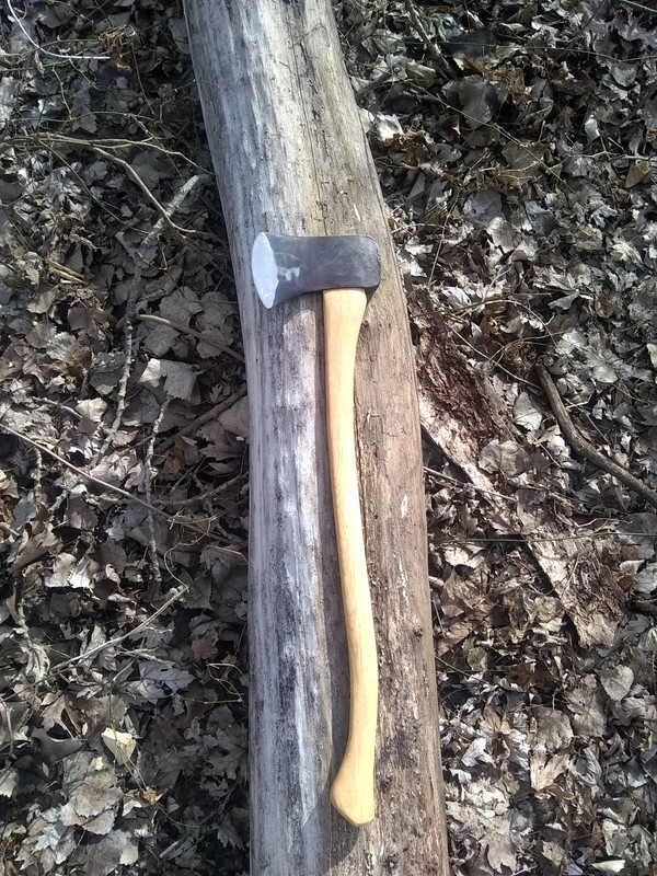

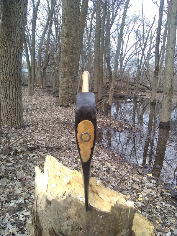

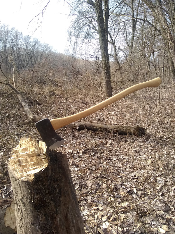

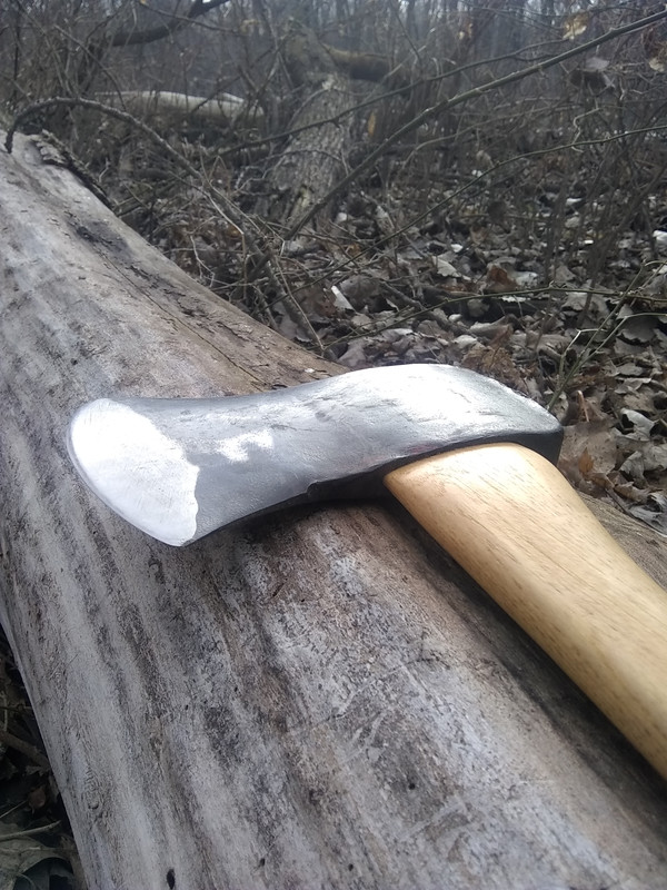

Finally got around to finishing this long overdue project. Not sure what this head is, no markings, just ridges in the eye and little bit of red paint, possibly a woodslasher. Was my first head with ridges in the eye hang. Used a 32" House club, ended up at 31" OAL, 4 lb. 2 oz. Total weight.
After a ton of thinning...
Test run on a good size dead but solid standing tree...
Pretty happy with the final fitment to the ridges for my first time, dropped a barrel wedge in it, just because...
Practiced standing atop the log bucking...
Pretty darn happy with the final results. I really like the length/weight balance. Thanks for looking, hope everyone enjoys the weekend!

Very nice! good job! looks great and looks like it works good also - that old dry oak is pretty hard stuff.

It's a beautiful handle. You certainly did that piece of wood justice. But I agree with your assessment of it's durability.
:fingerscrossed:
I have a Powr-Kraft double bit with ridges like those in the eye. Never occurred to me to cut grooves for them, I should have done that!
I don't think he cut those grooves in the tongue of the handle. I think the ridges in the head pressed those grooves in while he was seating the head on and off while fitting the head to the handle.
Maybe, hard to tell from a picture.
I tried it that way on mine and while they did make grooves in the wood the handle did not end up as close fit as I wanted. Still nice and tight, but it's not gap free at the top. If I ever do one of those again, I think the last thing I will do before wedging is to run a V-carving chisel in the grooves left by fitting. Just a couple passes should do.
I might even go so far as to pull the wedge and see if I can improve the fit a little...
I pre cut the grooves with a utility blade. Crude, but it worked. As I seated and fit the head farther down the tongue I cut the grooves accordingly to where the ridges were making contact.
