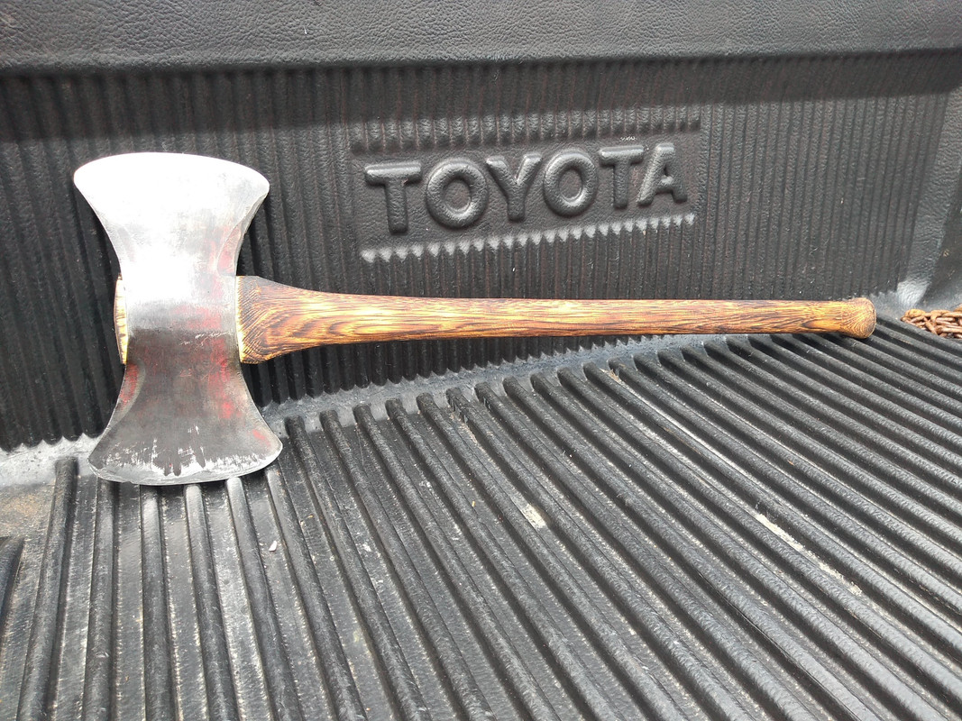

Here's a double bit axe head. Can't remember if I've shown this one before.
Its a beast. The only stamps on it are "Made in USA" and the 4^2 weight stamp.
It measures 10 1/2" long, and the bits are 5 3/4" each. It weighs 4lbs 11oz
anyone want to guess who the maker might be?
Finally hung this beast yesterday. Had a very dense Tennessee Hickory Handle. Thinned it up and decided to give this one some color with the torch.
Total length is 31", total weight is exactly 6lbs.

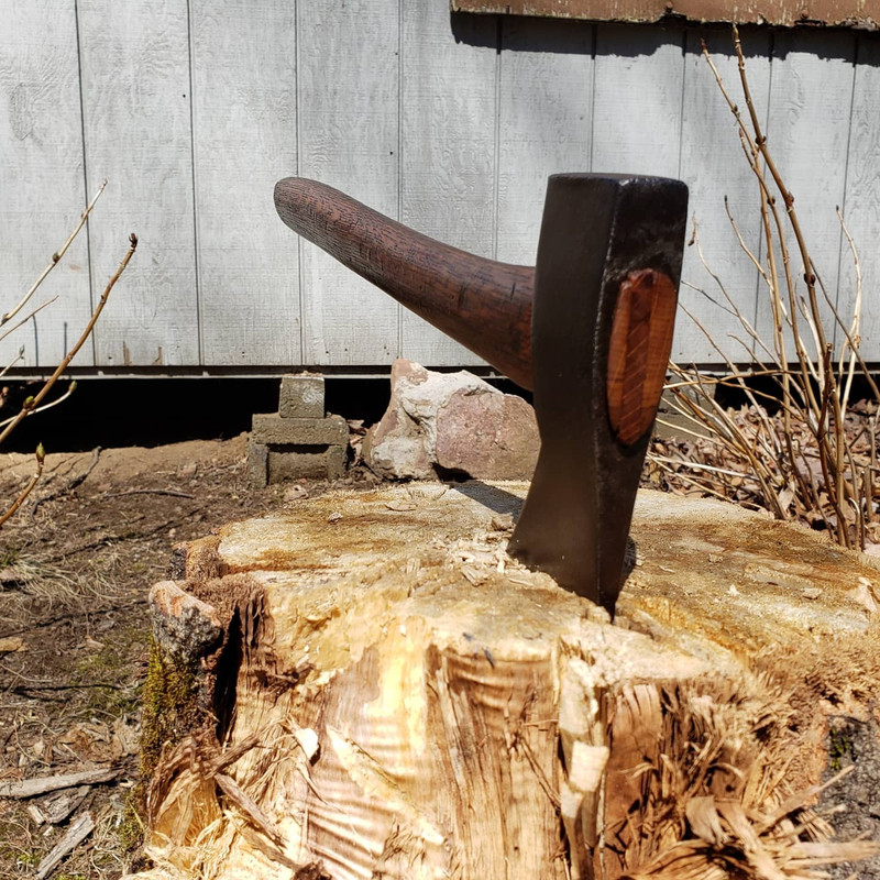

I made a rock maple helve for this Walters Black Diamond saddle axe a couple years ago. But it was from dimensional lumber so the palm swell sucked. A few days ago I decided to change that so I added some black walnut. Took some photos to share with you guys.
Here some pics of the axe and helve all finished and oiled. I skipped an awful lot of steps there but you can imagine the work that went into it. Lots of rasping and sanding!
And just a few more of the swell.

VERY nice! I love it. I'm going to have to try that 'swell' trick sometime. Nice Head also!! Love Walters axes! - and a black diamond even!
Hey thanks a lot man! Yeah it can make a useful helve out of an otherwise not very good one. It actually opens up a ton of options as you can even get away with using 5/4". Most everything under the sun is available now! I just used titebond II.

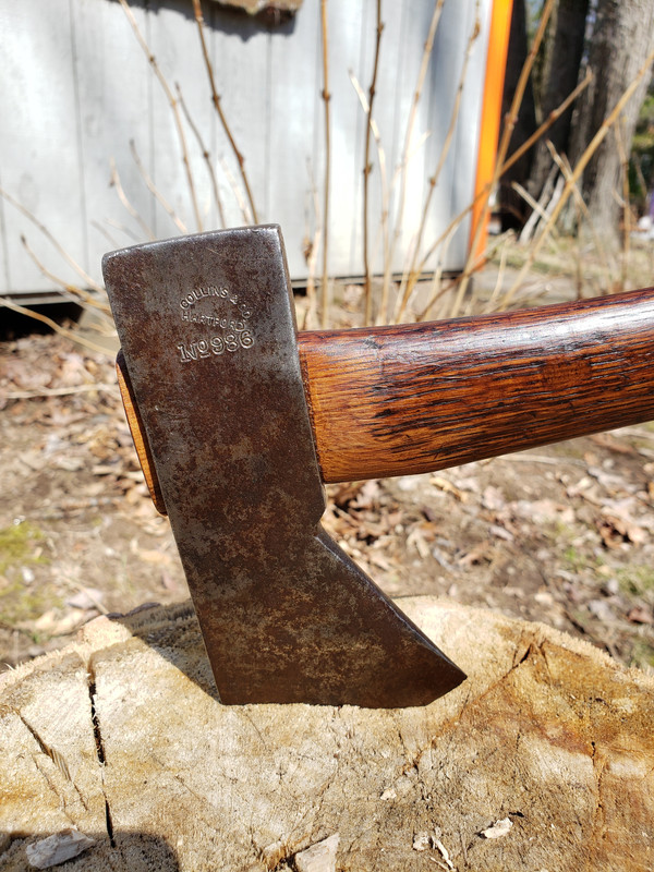

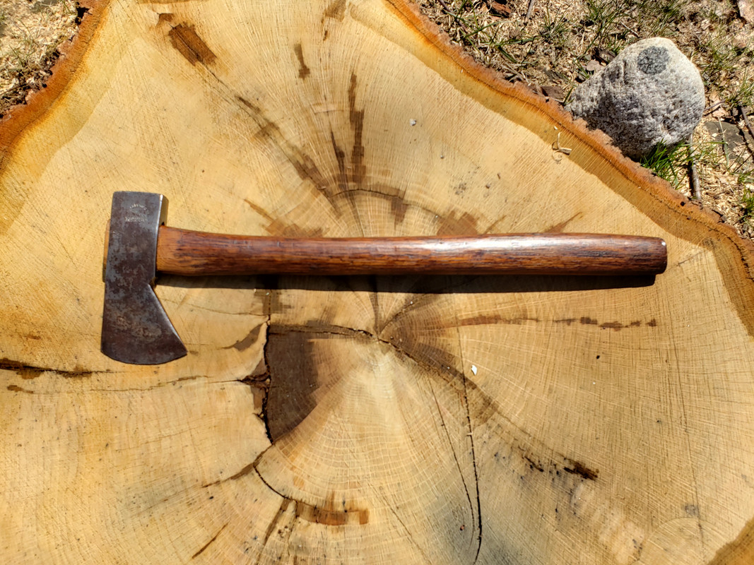

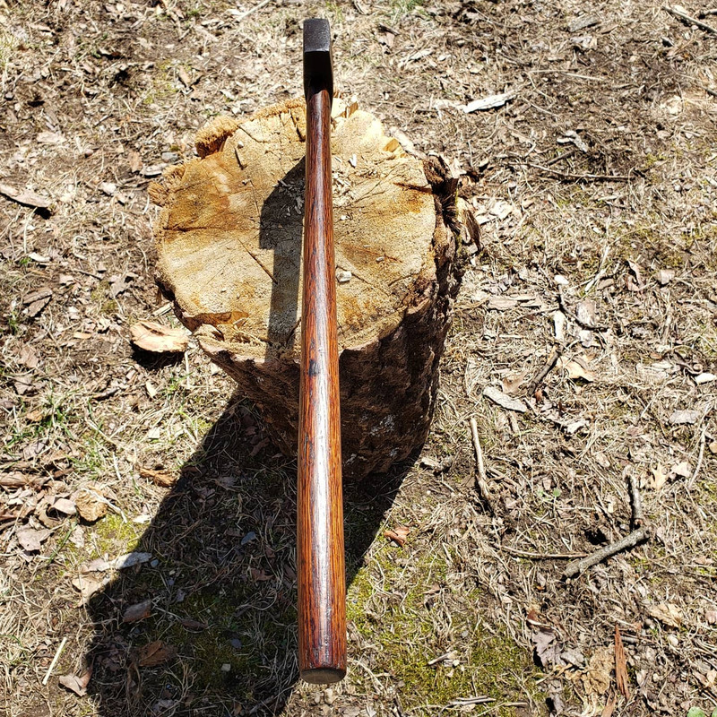

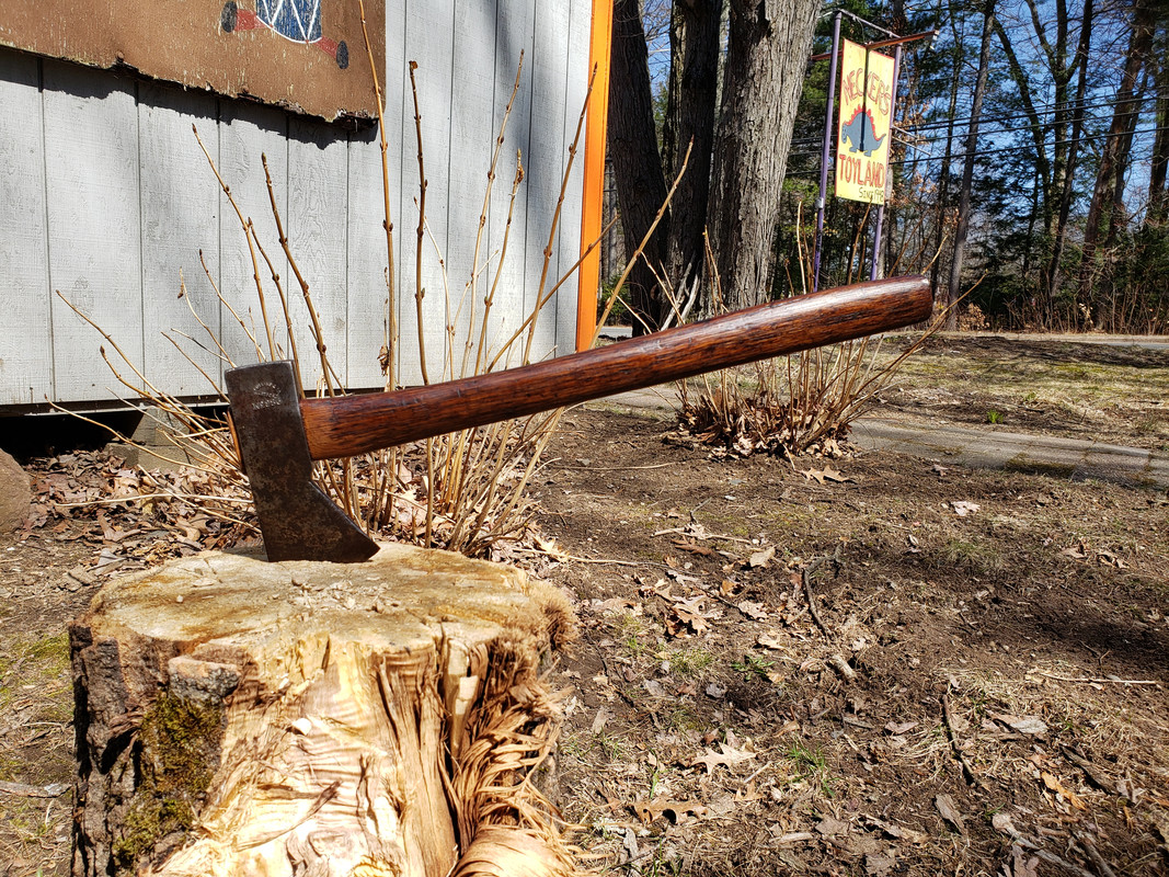

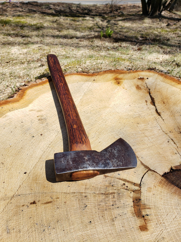

This is one of my three boys axes. I have much trouble finding the smaller size.
I got this one rusty and flopping around some. This is the handle that came with it.
Luckily, I was able to remove the head and drop it down some more. Saving old handles is the best!
IT'S AMAZING WHAT SOME SANDPAPER AND LINSEED OIL CAN DO!
Didn't thin the edge much, it already was thin enough for me. The cheeks are mostly flat.
Handle grain looks good. I was excited to get a nice one. Anymore, no stores have quality product.
Fits tight enough, looks good enough. It's getting used for some limbing tomorrow when we cut down a big tree in the back yard. No museum pieces!
You can see some lean to one side, the handle was not perfectly straight.
Won't notice it once you get working and stop staring at your tools!
Now to sharpen and prepare the other tools for tomorrows adventure.

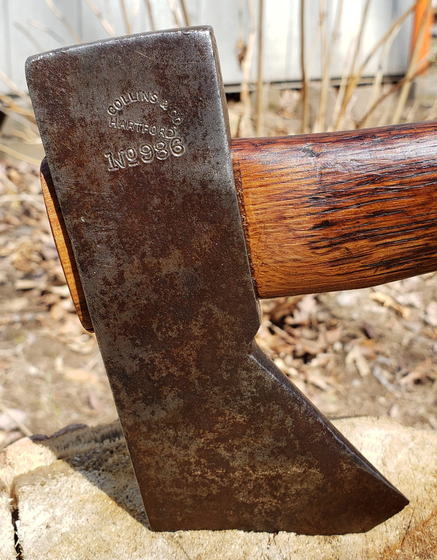

Love that old oak man! That super old Collins ain't bad either... ;):D. Did you ever figure out the age of that? Roughly anyway? I'm not a huge fan of the Hudson bay pattern but those ones look good..:D:thumbsup::D
The Hudson Bay is not a pattern I seek but this one is a Collins with a great stamp.
The Collins & Co name goes back to the beginning, 1826.
I know the name was changed due to a company reorganization in 1834 to The Collins Manufacturing Company.
In 1843, another reorganization changed the name to The Collins Company...on thru 1966.
In the late 1870's thru 1880's Collins had major axe counterfeit issues following their ever expanding and basic monopoly in the South American market. The export business being so expansive, along with the counterfeiting, Collins began to include the city of Hartford in the stamping and labeling to separate and inform these stamped axes are the real deal.
The name Collins & Co was used on thru 1966...
I wonder if this partucular head is no older than the 1920's(?).
