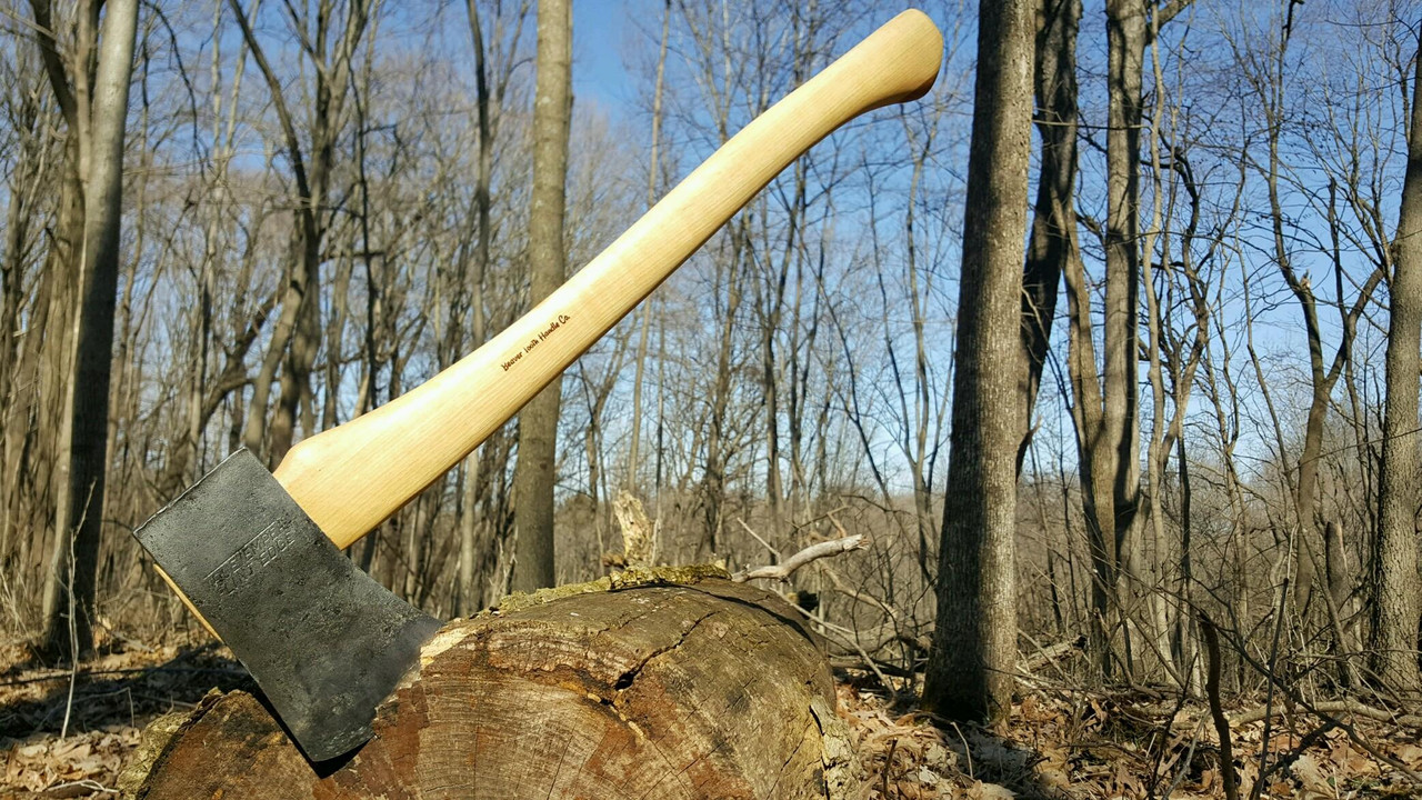

I ended up at my local hardware store to pick up a new (and correct) handle. It was a nice piece of hickory with some good looking grain. I hung it and applied boiled linseed oil and viola! I've got a great tool now:
Boiled linseed oil on the handle and some Rem Oil on the head until I can get around to making a custom leather sheath which is my next project. I'm happy with the final result:

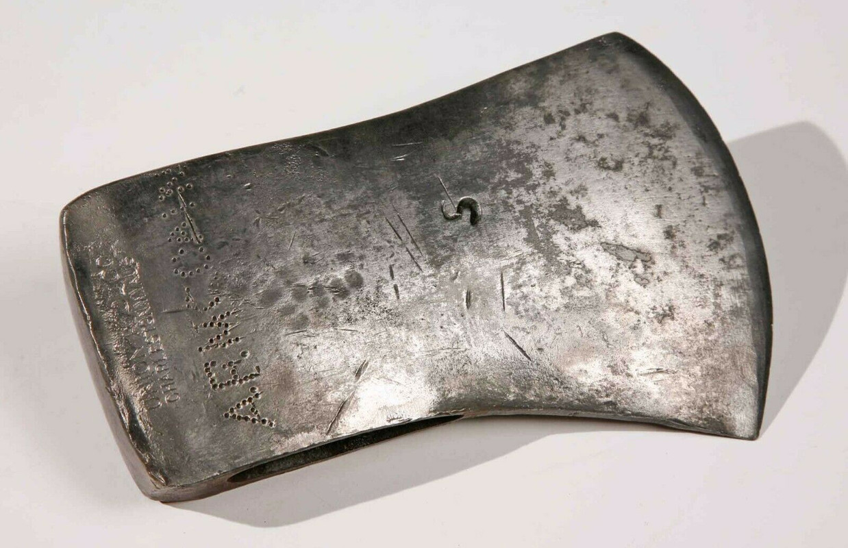

I've seen a picture of an axe head with a 5 stamped on it that was also stamped DEMON (If I'm remembering right).

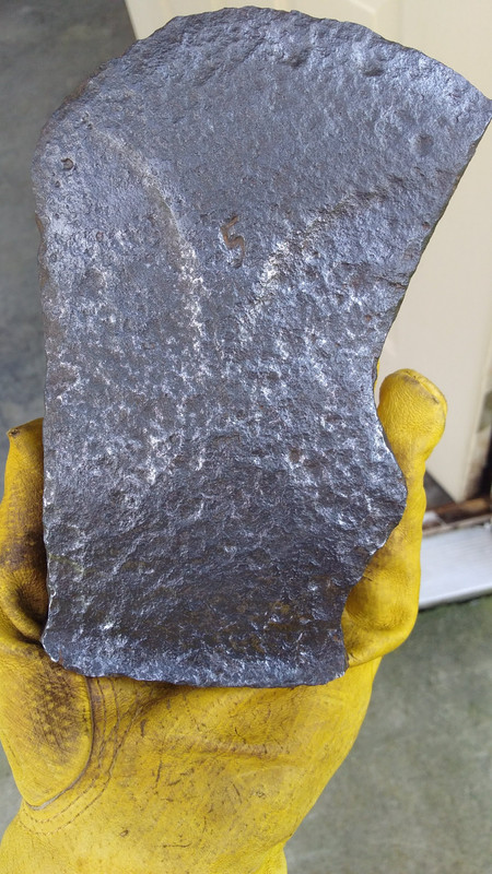

Here's another one with a similar stamp. this one looks like a 5 or an S, and like the others is not straight and is deep
Its a union tool, charleston wv axe

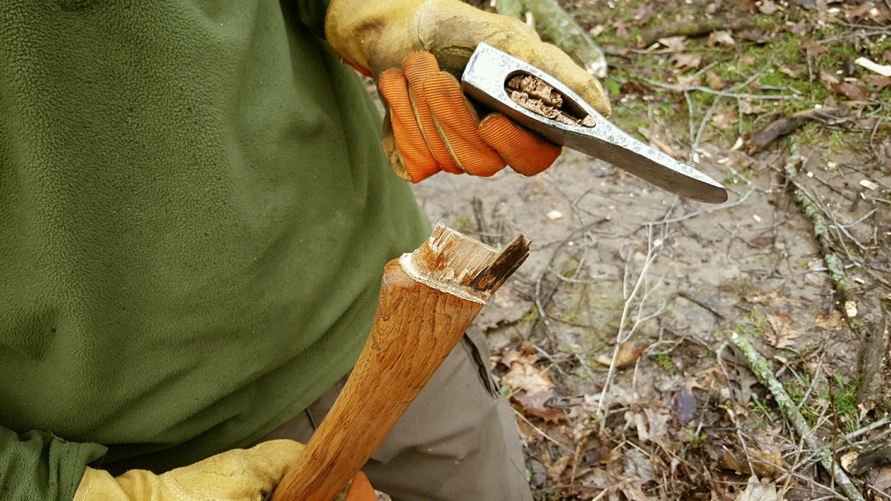

.the tounge had seen better days
If i had to call the cause of failure i'd blame 3 different factors:The kerf is probably way too deep;the shoulder was left too fat relative the tongue,and the transition formed as an abrupt inside corner has acted as stress-riser;and lastly,that wood inside the break ain't looking too healthy-either it was getting moisture in there and bacteria chewing out parts of the cellulose structure,or it was over-cooked in kiln-drying process...
Good job,man,nice re-hang.
I agree, I think it was a little of all of it, mostly the poor condition of wood in the tongue, combined with me not thinning out the shoulders gradually enough. I was giving it some good swings, and just cracked in a fracture type break right along bottom of the head. That haft had ridges cut into the tongue before I repurposed it for this head, large gap in front part of eye I soaked up with a piece of dowel, and the tongue was thin to begin with. It looked nice, but didn't pass the longevity test. No good if you can't use it...glad I had a spare haft ready to go...cleared some more windfall off the trail today with it.
