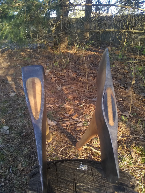

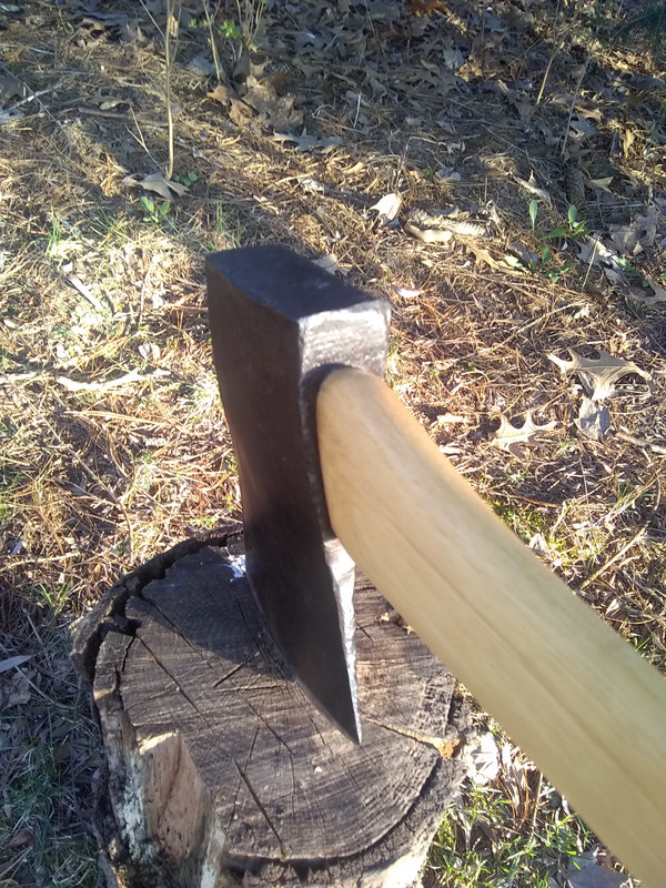

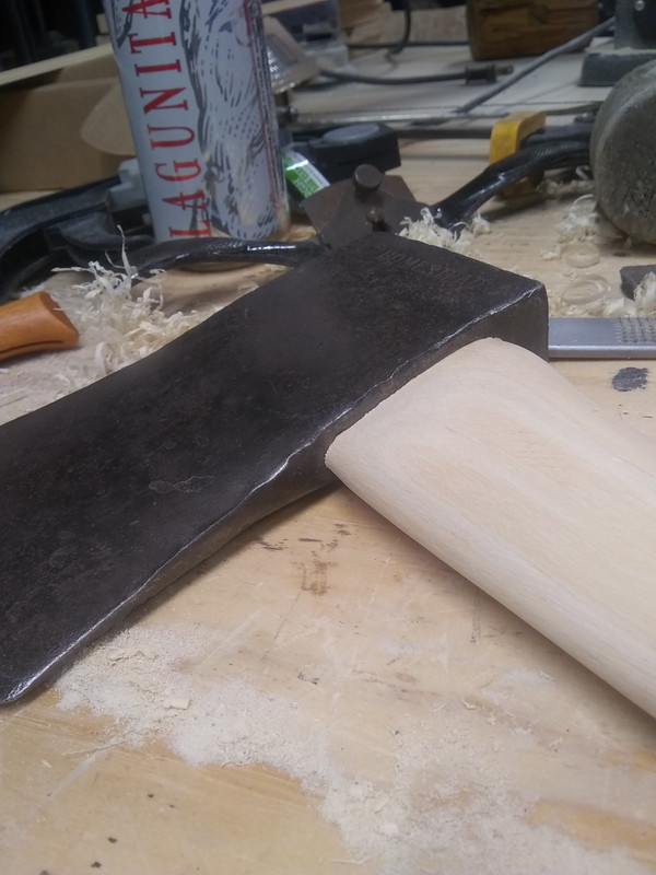

That Link handle was kinda...barely adequate...kerfed crooked,shocking lack of material in the tongue in general,i made it work,but will look for a better haft by'm by.View attachment 1315792

Oh I do like that head profile...I've been in the market for something similar...is the forge open for business yet?! Love that head @Square_peg acquired.
No,man,i'm sorry,this forge is an experimental/testing facility only!:)
For now,and probably always...Unless i could either grow younger,or very seriously mechanise the process.
But i appreciate the honor you do me by asking,and thanks for kind words
2¼lbs
13¼"
Truper Collins probably
Original haft
Rehung, single wedge
BLO
Quick file and stone sharp following existing bevel
That's a good looking hang there! Good fit on a 13". Makes the head look massive. I like it, good looking set up sir!

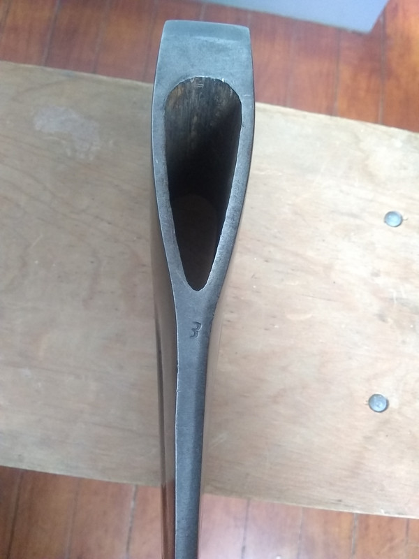

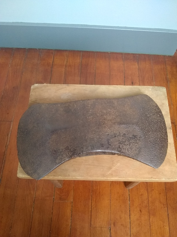

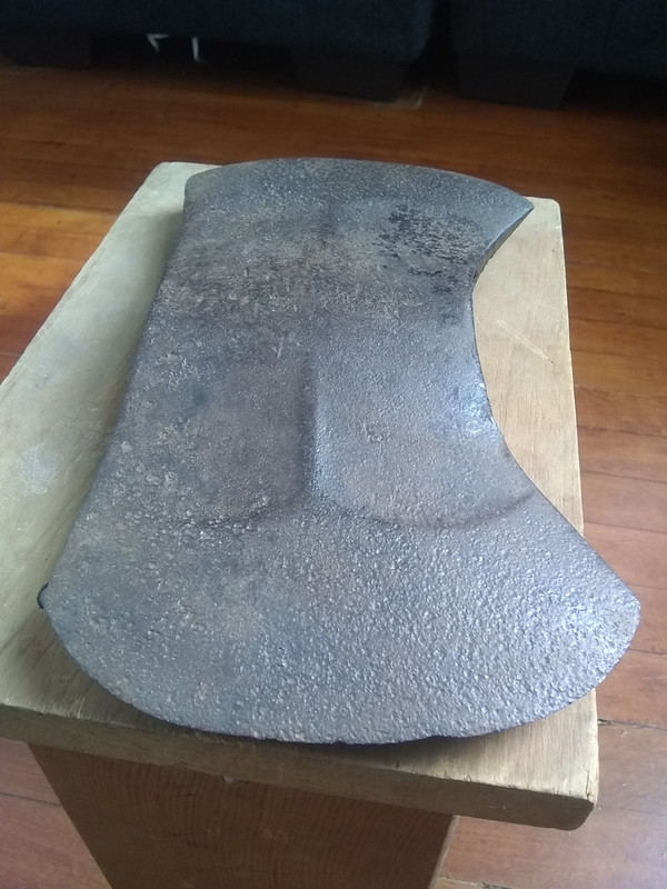

Here's an unmarked double bit I have that's pretty pitted and worn down decent, has a random placed deep 5, although it weighs 4 lb. 10oz so I figured it started as a 5lb. One I have that confuses me is a KP I have that has a 3 stamped on the bottom, and weighs 3lb 15 oz. Sorry, probably not the thread to discuss this, but I figured while we were on the subject...
That double bit is an AmericanAx. No question about it! That skinny ridge between those iconic bevels... 100% AmericanAx! To my knowledge they were the only company to ever make bevels like that. It was their trademark shape. Congrats man it's a nice one!
Thanks for the info man, ive been curious about this double bit and it's bevels, they are very different from your typical Plumb or Kelly style of bevel. I thought I saw something in an old reproduction catalog, that had axes under a house brand name with similar looking bevels. I'll go look again when the stores open back up, I didn't buy the catalog!

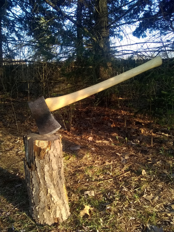

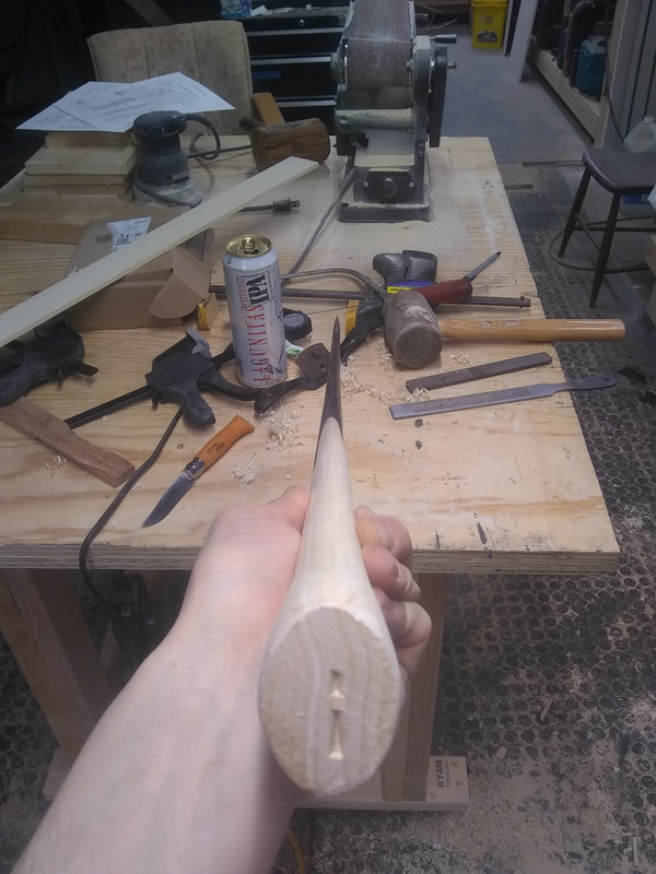

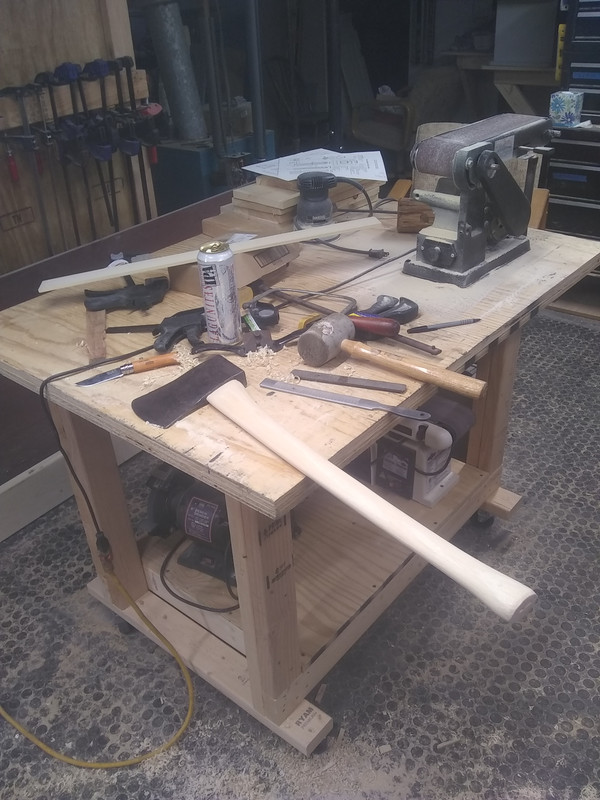

Hung another new S&N head and a hammer I've been meaning to get to for a couple years now.
The axe handle is a House boys axe handle (28" if I remember right). Needed a lot of reshaping on the knob and the shoulder but I hardly touched the middle :D
I left a lot of shoulder, figuring it might be useful one day.
Sorry about the contrast on the first pic. I really should move that round out into the sun if I'm going to take pics.
I ended up using the round wedges that came with the hammer handle, since the handle was a different brand than the head, there was a lot of gap to fill. Can't say as I'm wild about those tube wedges, though I've improvised them for small hammers and liked them ok for that. Must be the huge gap to take up that I don't like :D

Is that one of those Stilleto hammer handles? I was going to try using one for a hatchet, but the eye taper is cut backwards to a typical hatchet. If you're not trying to do a future rehang or save a vintage haft, the barrel wedges work great.
Yeah, the handle is Stilleto and the head is something else, I think it was Home Despot's house brand but I don't really remember. Framed a house with it before the head became too loose to use. Probably would have been pretty disgusted with short life of it if I'd been moving on to framing the next one rather than moving on to the drywall and trim work and using different tools.
What I don't like about the tube wedges (or any metal wedge) is that they split the handle. I'd rather use a wood cross wedge if I need to take up gap in both directions. Gotta get the angle right for that, however. These tubes were zinc or something else soft too, that bugs me a bit.

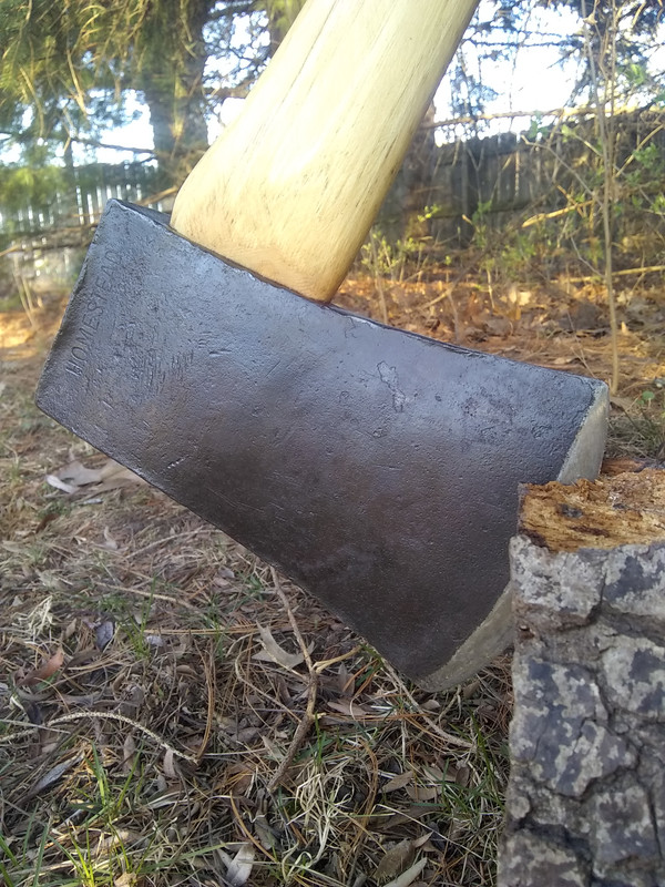

1 3/4# hatchet I've had laying on my bench for several years, found a haft for it last year, 18" NOS, tapped the wedge in until it started to split, at that point I left it resting for 3 days, give the BLO time to soak in, then I cut the wedge down to about 1/2" above the haft, went in about another quarter inch and mushroomed. Trimmed it down and sanded it, that old bit sure was thick, got it down to .30, after the file I put a coarse stone on it and called it a day. I'll finish the edge next week. Came in at 17 3/4". Will make a good truck axe.
1/2# makes a big difference in hatchets. Here is a comparison shot with a 1 1/4# hatchet.

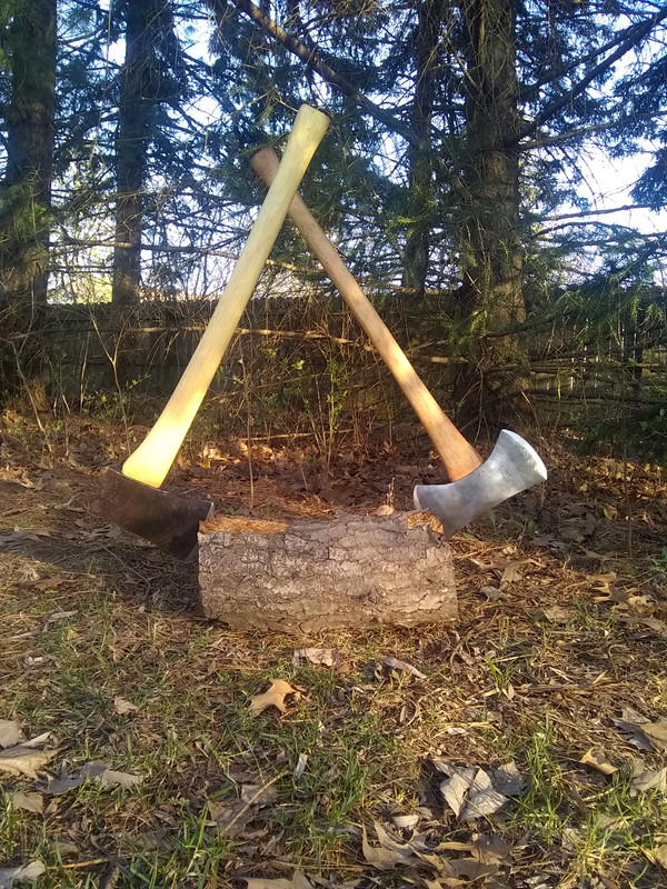

Finished this up over the weekend. Older Homestead yankee head on 28" straight House club. I've gained access to a basement woodshop, making things go a little faster. After spoke shaving, I did use the belt sander for a little shaping, but finished it with a rasp and left it like that. Ended up at 27" 4 lb. 5 oz. I was going for a fallers/wedge banger, but I think my primary use for this one will be light splitting at camp fires. Picture heavy as always. Enjoy!
The Plumb cruiser snuck into the pics, was sharpening them both. It's 26.5" 3 lb total.
Very nice!! great hang!
