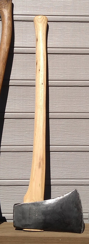

Another TT Flint Edge, I really love these heads as they are available in my area somewhat often.
Hung on a beautiful day, I just really need to sharpen it. It was hard going at times. Those eye ridges are evil!
I got really lucky on the fit, only three attempts and the wedge was down.
It's still a bit oily. This has BLO now, but it got a new watco finish later in the afternoon.
It has a baby curl and just enough gap to not care about. My time matters more than perfection on a user.
I should have been mowing, the yard takes an hour pushing it. I refuse to buy a rider.
However, this was so much more fun!
I don't think this head has seen very much use.
BONUS: I got the Plumb somewhat finished. It wanted to give a sneak peek.
Besides the nice work you did, both those heads look very fresh, great heads.
Pretty flowers too, shame the grass isn't better kept.
