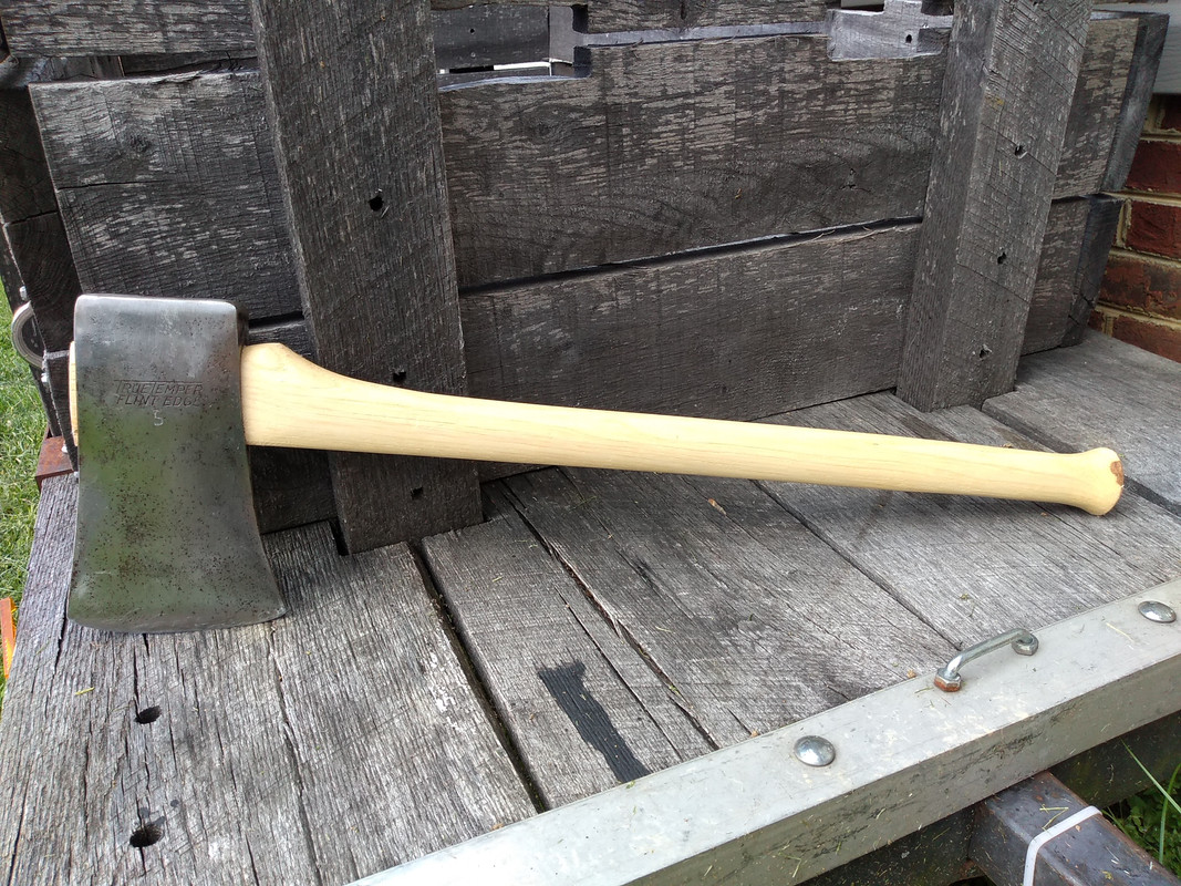

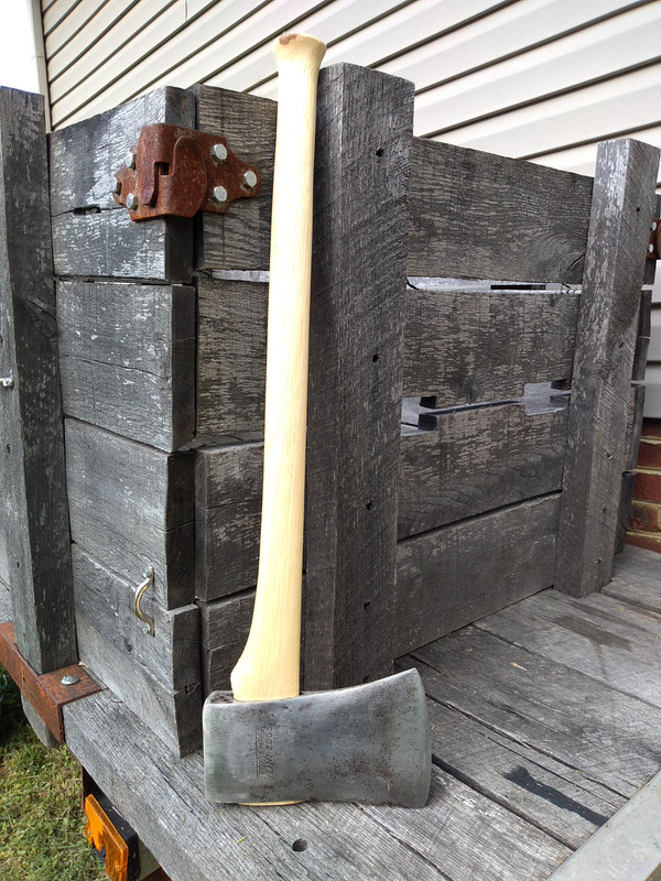

Figured I'd share my other recent hang. I made this haft for that E&S connie in my last post.
It's a long story but I ended up chasing a gap at the back of the eye all the way down near the shoulder. It was getting dark, I was tired and really trying to get it done. Ended up with the axe way too closed in hang and therefore the front of the tongue was sanded very, very thin. So thin I thought I had ruined the haft I spent so much time and care making. :confused:
But I was able to hang a pre-1930 Kelly Works Champion on it! Thank goodness! :thumbsup:
So it's hung a fair bit more closed than I really like but I'm happy to have been able to salvage the helve. Anyway here it is!
3lb 5.5oz KW Champion connie on a hand made 29" French curve white ash helve with a yellow birch wedge.
So anyhow I'm happy with how it looks at least. Being so closed it can have its uses. Mainly for me over hand chop though it is a tad short for me for that purpose. In the end I was just happy to be able to use the haft.
Thanks for checking it out and sorry for the photo bomb! :thumbsup:

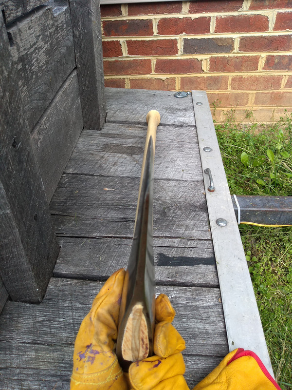

I thought you'd like this one for several reasons... 1 is I left the tongue proud a tad this time and 2 it's hung way down to the shoulder. Both things I think I know you are fond of. :thumbsup::thumbsup::thumbsup:.
As you know know I'm a hard-core flush cutter from way back.;). And I normally leave them up off the shoulder so I can reuse the haft when it inevitably shrinks or otherwise loosens one day. But this one was only going to happen one way! And I like it a lot too. :thumbsup::thumbsup:Thanks again man. :D:)
