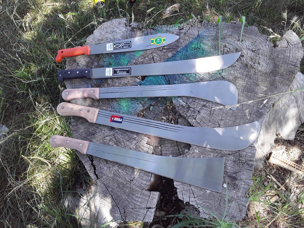

I don't know if it really counts , but I used the end of an old cracked axe handle on one of those Incolma machetes that came in on Tuesday.
The 22" Latin is light and fast and the long blade started to seem useful to me so I decided to keep it as well, but the handle was just too small.
I threw together a quick and dirty handle from pellet wood earlier today and it failed, that's when I got the idea for this.
The orange duct tape is just there to lock down the string I used to cover the gap at the bottom, it's properly glued and pinned.
It's the second one down from the top.
This should be one awesome weed slasher around the yard.
I'm going to buy a gas string trimmer when and if that darn stimulus check ever arrives, but the machetes and even the 18v cordless trimmer will always have their place.
