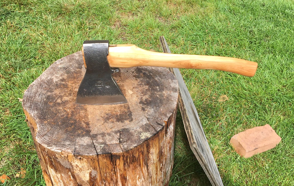

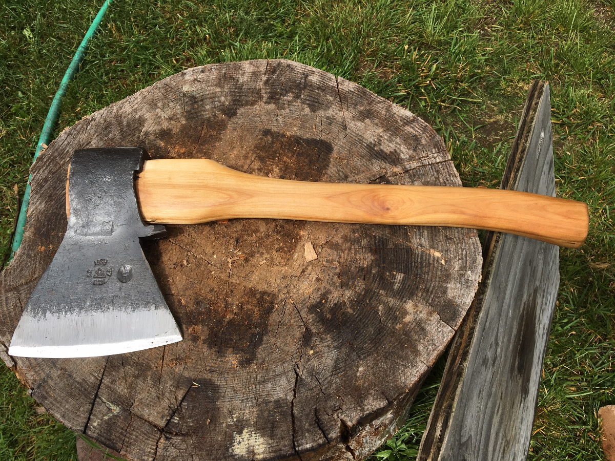

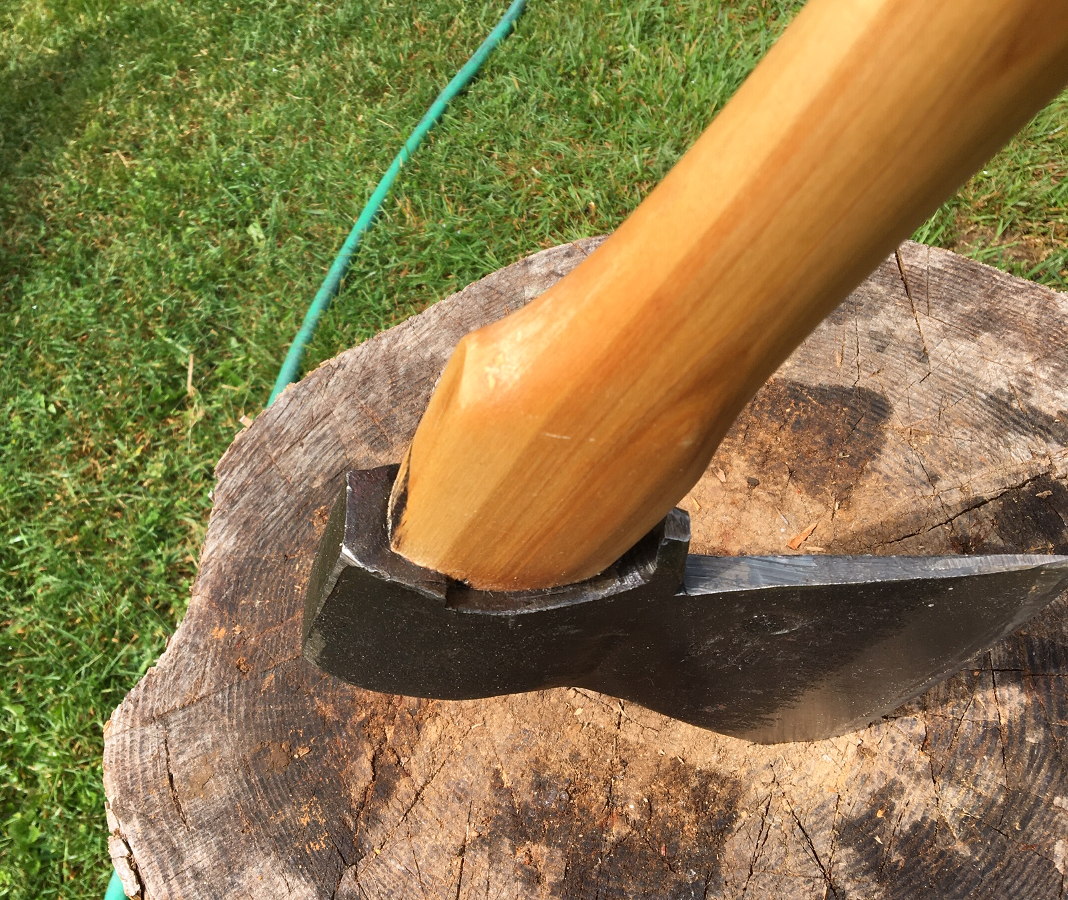

It is probably me stereotyping but when I see Topor stuck deep into a stump I imagine abundance of headless hens and unlimited supply of chicken soup for cold Winter season.I rehung my Russian Topor. This thing has been sitting on my bench for a couple years while I debated fixing the spur. The spurs on these are only decorative since they don't make contact with the haft. I thought about what I would have to do at the forge to correct this and decided it wasn't worth it. This axe has a very well formed eye and it doesn't need the additional support of a spur.

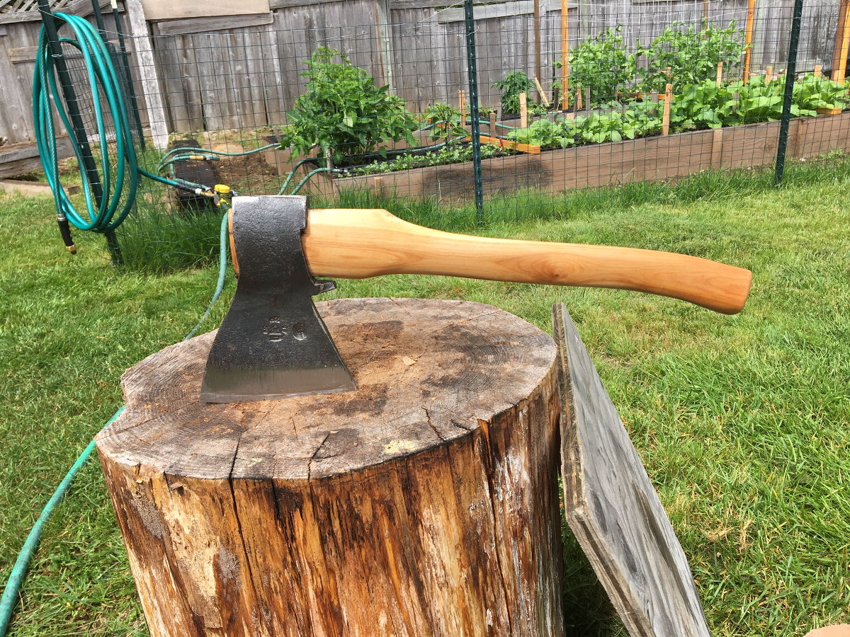

When I first received this axe it was coated in some sort of tar or dried cosmoline. This was a NOS axe, never used. It was a mess and a bit of a bitch to clean up. My SKS was coated in a similar substance.
But underneath all that was a decent axe and handle. It's from 1955 when they still used decent steel in the Soviet Union.

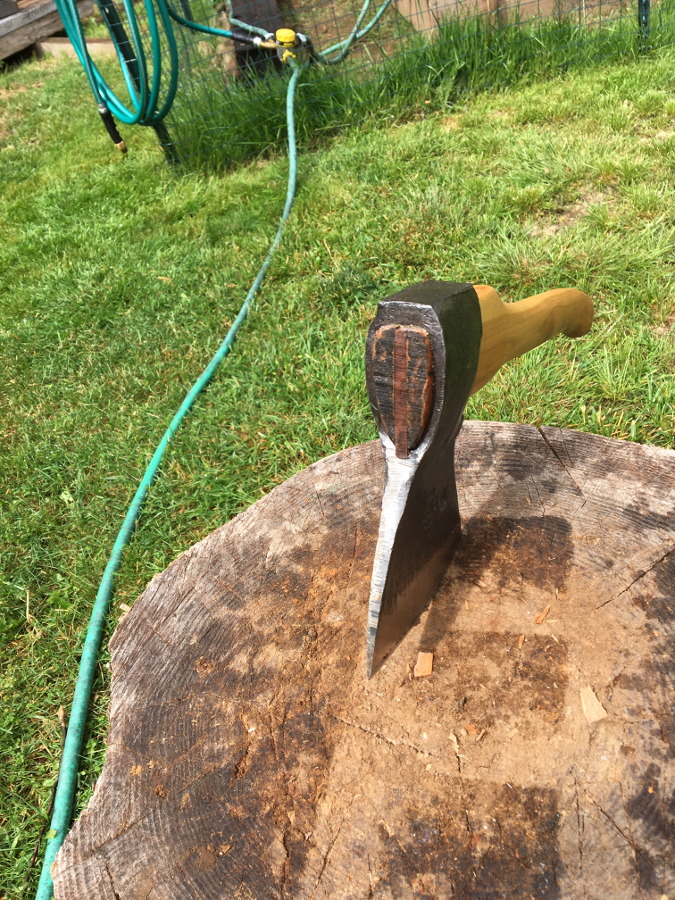

I cleaned off most of the tar. It soaked deep into the top of the haft and even after cutting off 5/16" of wood the top is still black. Walnut wedge.

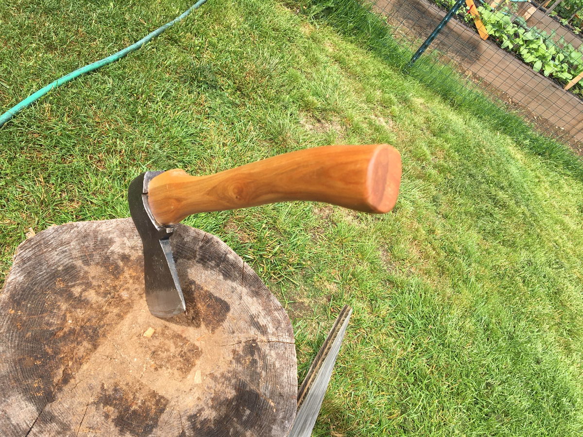

Grain is pretty good to excellent and the handle is well sized to the eye.
A few stains of cosmoline remain on the haft.
