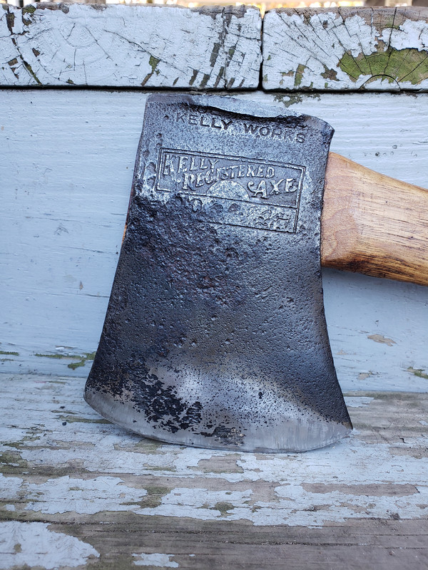

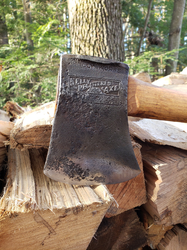

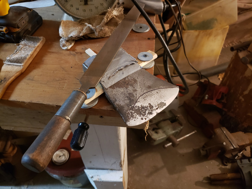

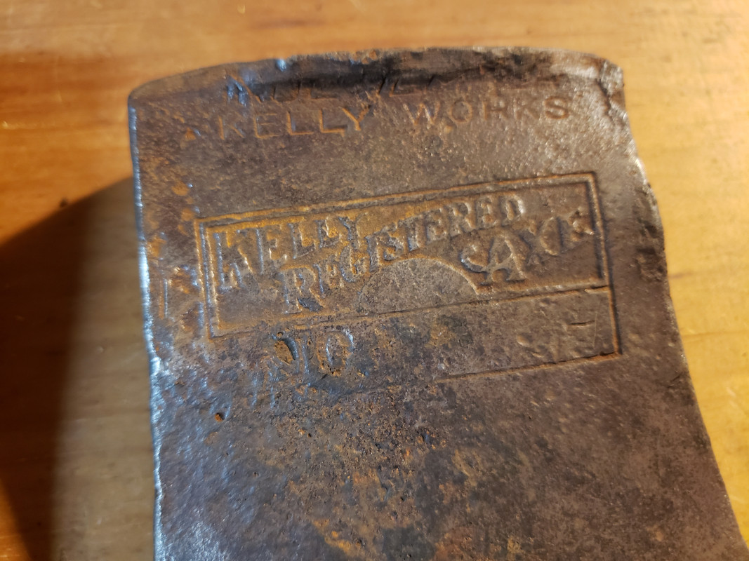

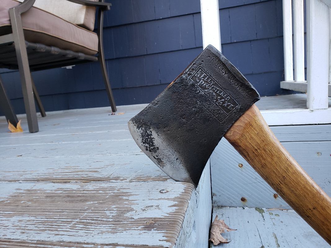

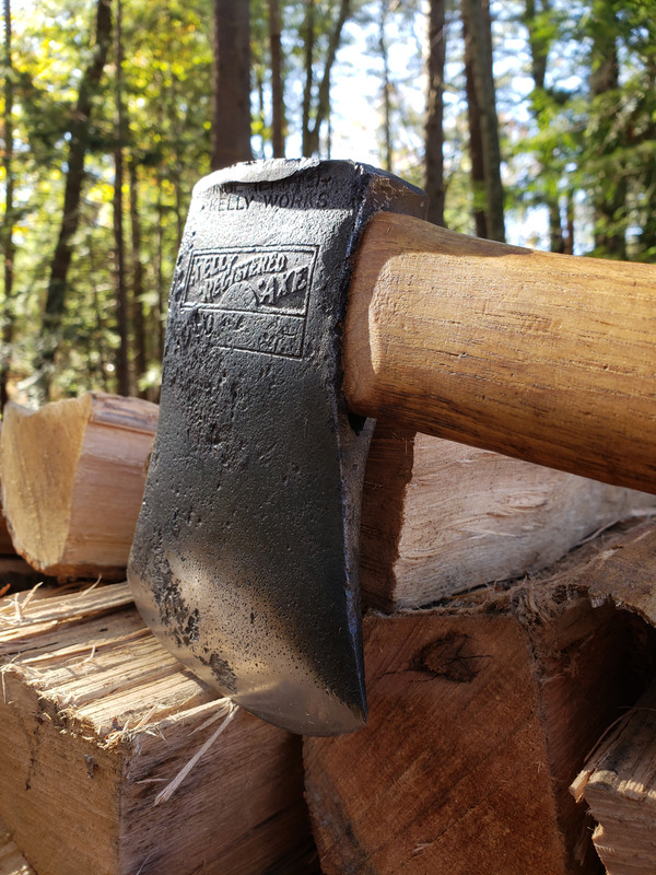

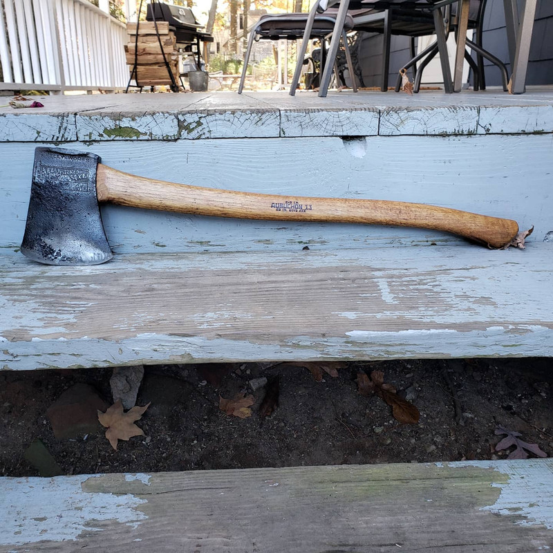

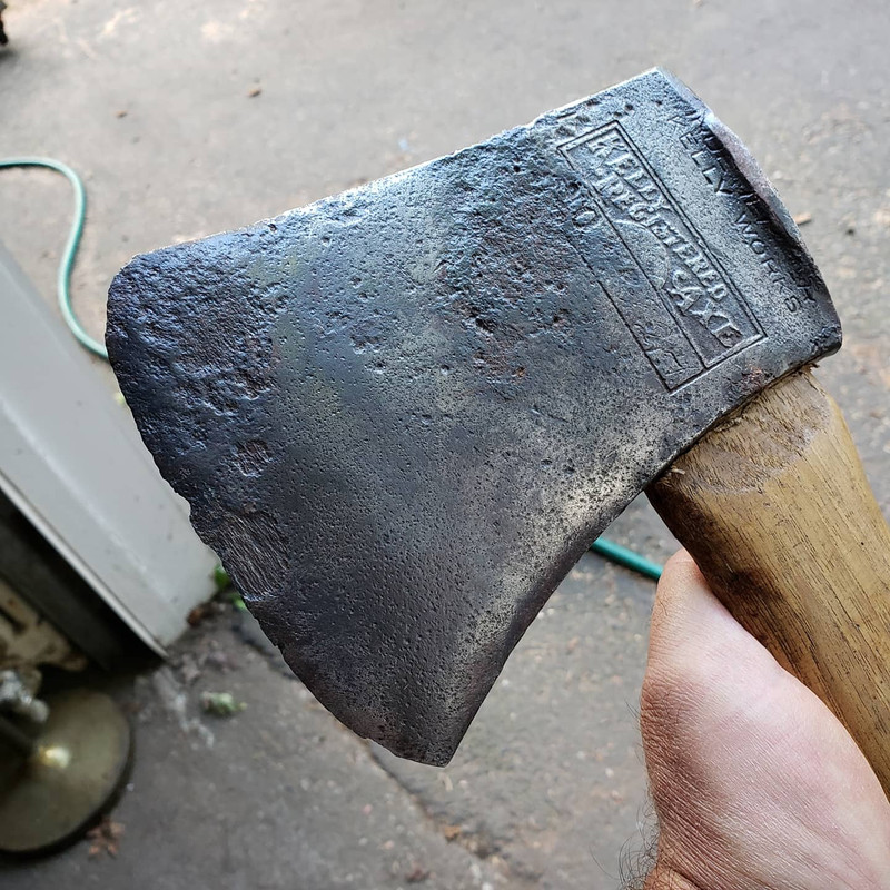

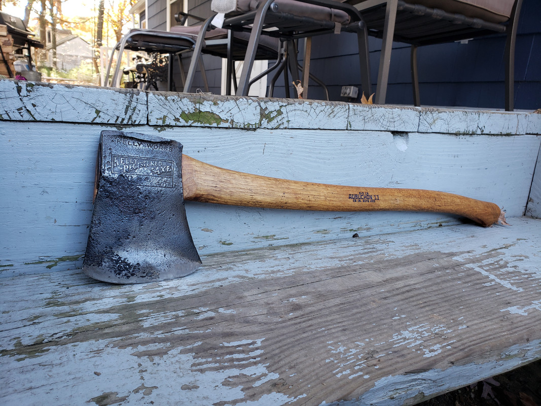

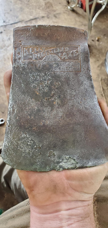

Hung this Frankfurth cruiser last weekend.
Jeff
6⅛" long
5⅛" bit
3¼lbs
4lbs.
27½"
• Kelly Registered Connecticut Pattern
• True Temper
• Kelly Works

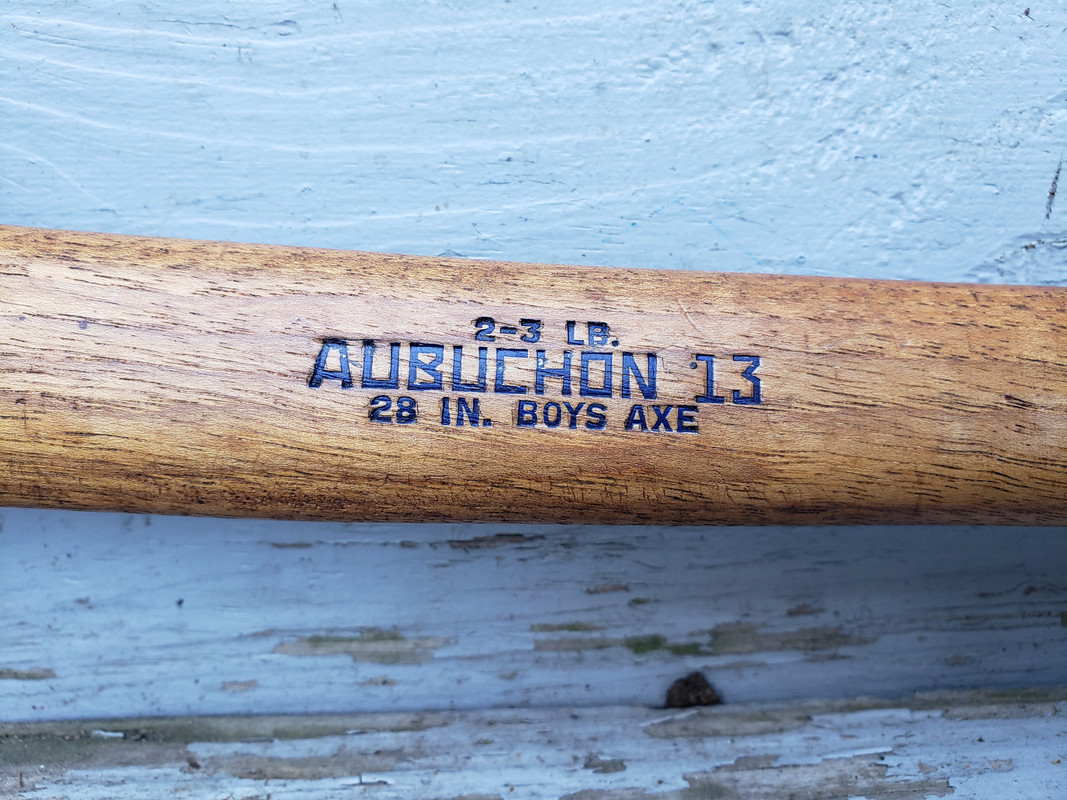

• Vintage Aubuchon Hardware replacement Handle

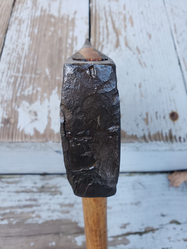

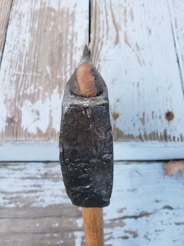

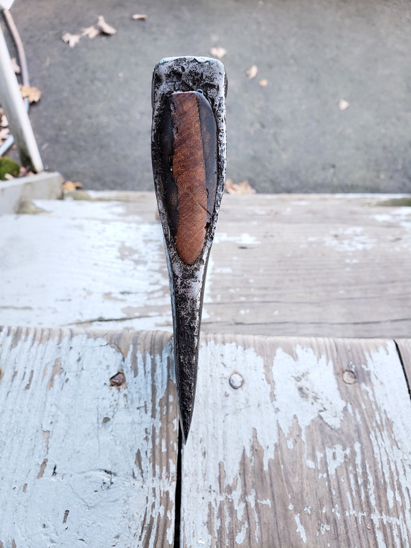

Abused pole and wonky eye is how i aquired but gently persuaded the eye back to close-ish-enough :thumbsup::cool:

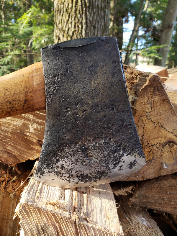

Turned out just wonderful! What a looker! I love that you improved but just ever so subtle. Eye came back in quite nicely. And that light file looks amazing! Got her looking great brother!
Hair shaving, paper slicing wood chopper!
Thanks buddy! The handle and the head just scream WORK ME!

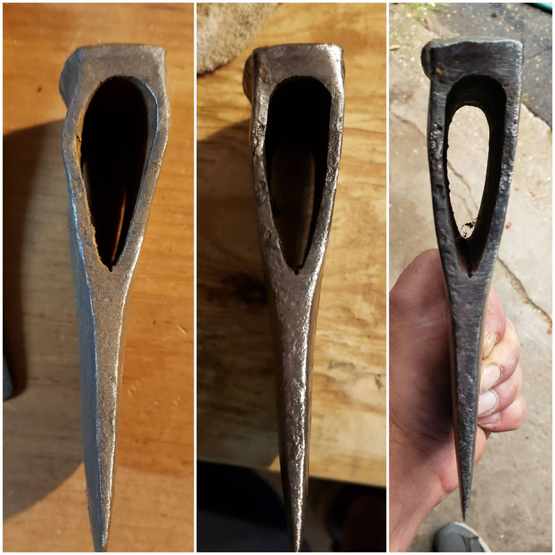

Amazing, amazing job! Teach me. What was your process for adjusting the eye? Amazing job!!

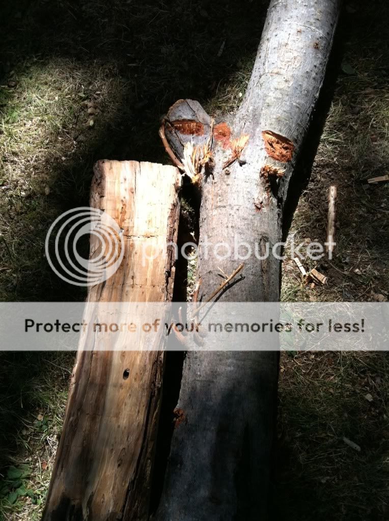

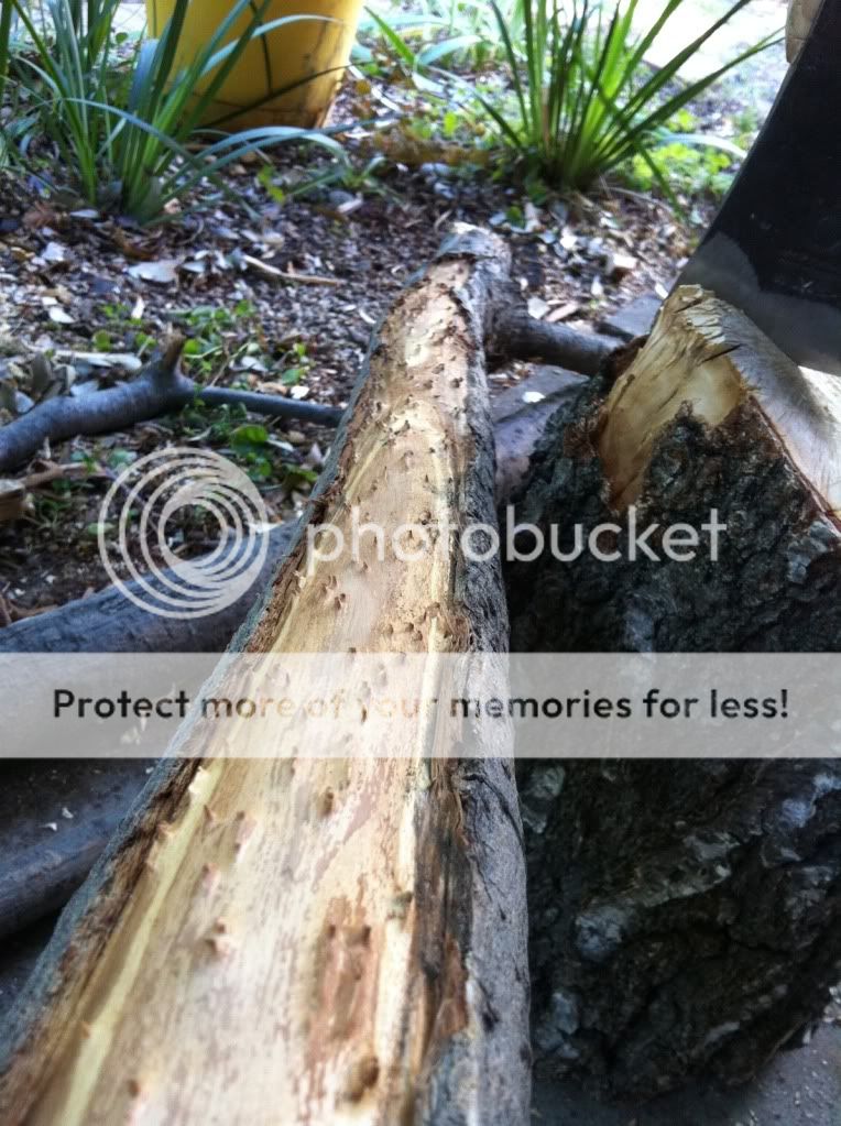

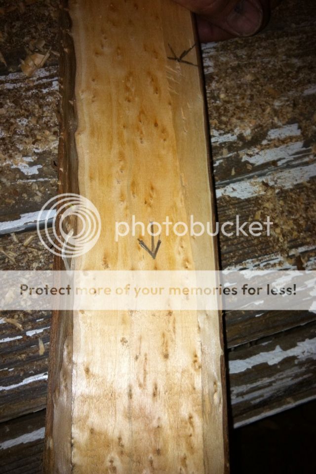

Anyone seen this wood before? I've no idea what it is.

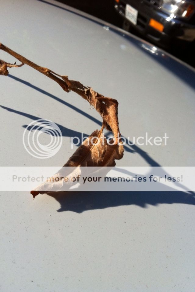

A couple leaves that were on one piece.
Im sure 7 years is plenty of time for this to no longer matter, but I believe the limb you used is off of a beech tree. Beech is a good wood for tool handles, chisels and the like, so I’m curious how it held up on an axe. I’m only on page 15, so I’ll keep reading.
Soft face hammer and the anvil.
I used a copper faced hammer on the Registered. Hitting at the etch was nerve racking but the copper left in the etch looked cool. Practice on other heads first, start slow.
I put the hammer down often between sessions of pounding just to take the pause and not accidentally go to far.
I also hammered out the pole shroom over at the True Temper stamp and filed, trying to maintain as much as possible and maintain the overall character that the axe came to me with.
The Aubuchon replacement handle is possibly more rare a find than the axe head.

Thanks for the description, this level of modification is new to me. I have a few tweaked eyes that I live with, but would love to adjust if I could safely. And always interested in what's possible fixing a mushroomed poll to save as much stamp as possible (definitely thinking of my 3lb Rixford Kentucky). I was encouraged to here that you didn't use heat.
I don't have a soft faced hammer, but I have a hard one and lots of yoga ball rubber available. Would that be comparable?
