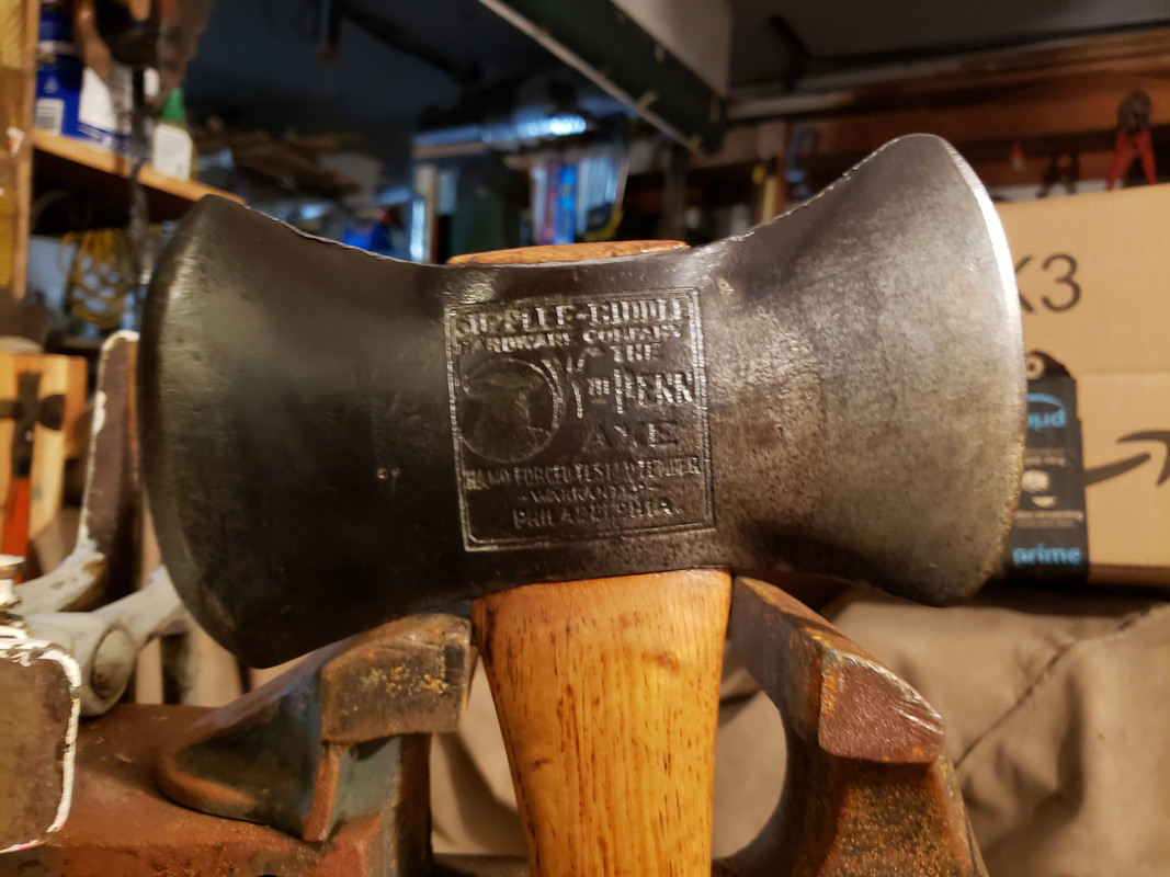

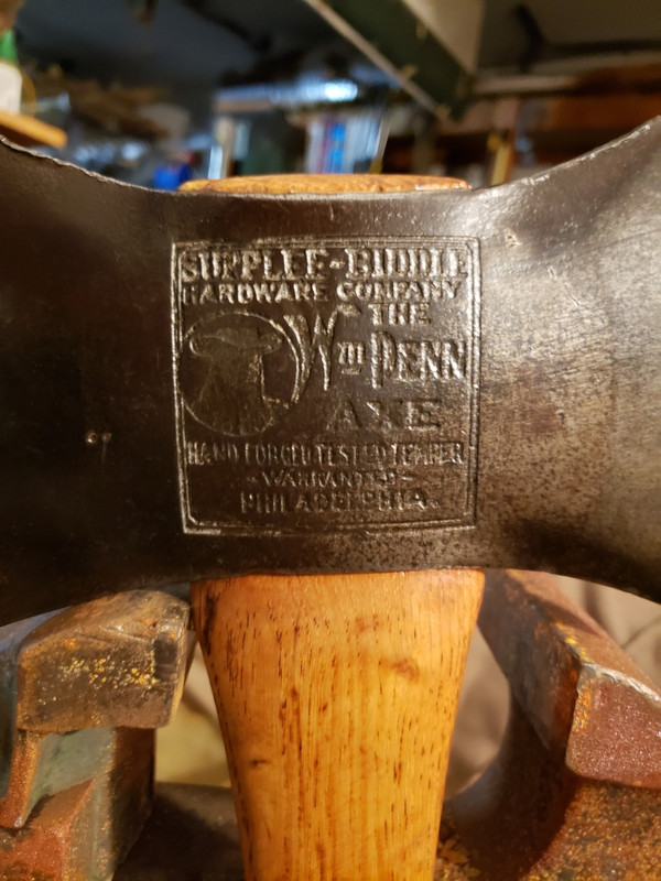

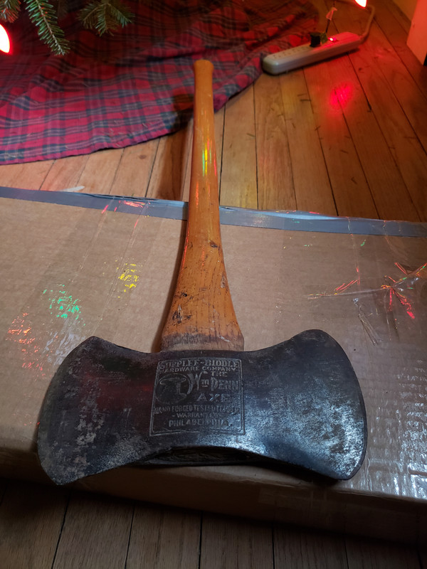

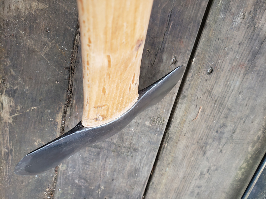

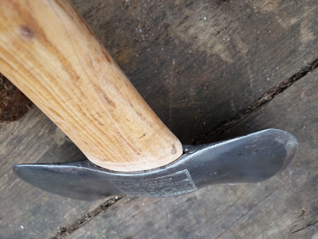

I rescued this from an antiqes store for $20. 2 1/4 lb. AA&T. I have been questioning whether it is original or an imposter due to the logo. I honestly cannot tell if it was just a byproduct of the rust or if there is a double-stamp on it (sure sign of a fake). However given the poor condition it was in I am leaning towards authentic. Either way, the mushrooming at the top of the head (how & whyyyyyyy?) and the screws and nails keeping the head on was making my one eye twitch so I had to do something for it (see last photo). It has seen a tough life so I cleaned up the blade a bit and ground off aforementioned mushrooming. I wirebrushed it to keep as much of the original patina as possible and hung it on a 19" handle that fit the eye perfectly. I am probably going to paint the handle and that will be it. Thoughts on this being an original specimen?
https://www.bladeforums.com/threads/fake-aa-t-axe-head.1764413/#post-20191560
It's only my own practice, and to the degree it even is applicable in this instance is hard to say, (you've said that the axe isn't intended to be actually used, more of a show piece), and acknowledging that the handle as it is now is a success, but I think there are better finishing combinations than oil on maple, strictly from the stand point of appearance and figure enhancement, you understand, which is really the reason we add a (oil) finish anyway. First, in general oil will accentuate the natural tendency of maple, (also other light colored woods like ash, birch and so on and so on...) to yellow, particularly boiled linseed oil and it is better suited to woods on the red/brown color spectrum, oak, hickory... for example. This specific feature of the wood, (curly maple) is heavily dependent on maple's distinctive light refracting properties which oil will even diminish as it ages, absent a continual refreshing and vigorous polishing. Tung oil in particular can give a cloudy cover which light colored woods are particularly susceptible to, and maple even more so. Oil will also not seal the wood and so there will be an inevitable accumulation of dust and other potential filth dulling the refraction and making the feature less dynamic over time. That said, in this case the stripe is exceptionally strong and so no fear it will not remain obvious. In fact because of the variation in the orientation of the pores the stripe will darken as it absorbs more oil but the refraction will diminish and a dullness/flattening will set in.
Personally I don't go in for complicated formulations and secretive productions for wood finishes and find a suitable one on such wood is simple shellac flake dissolved in alcohol, heavily diluted which will penetrate deeply, not alter the color much if any and seal the wood off from grime and dust and help maintain and enhance the curly figure in maple.

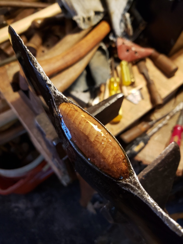

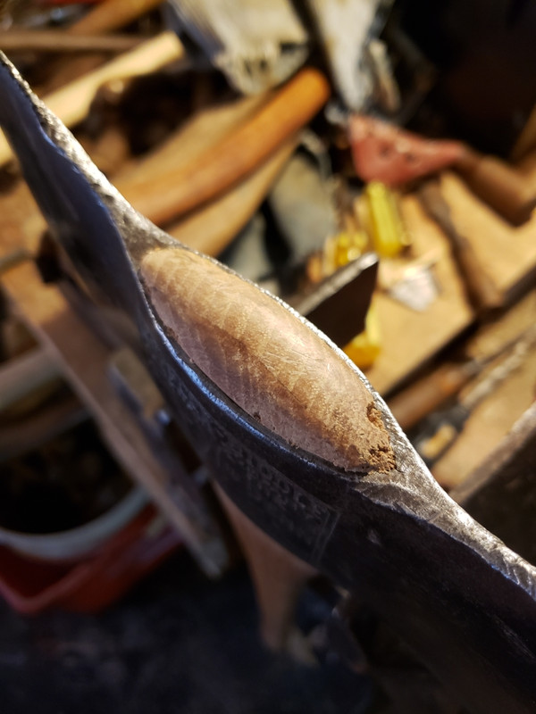

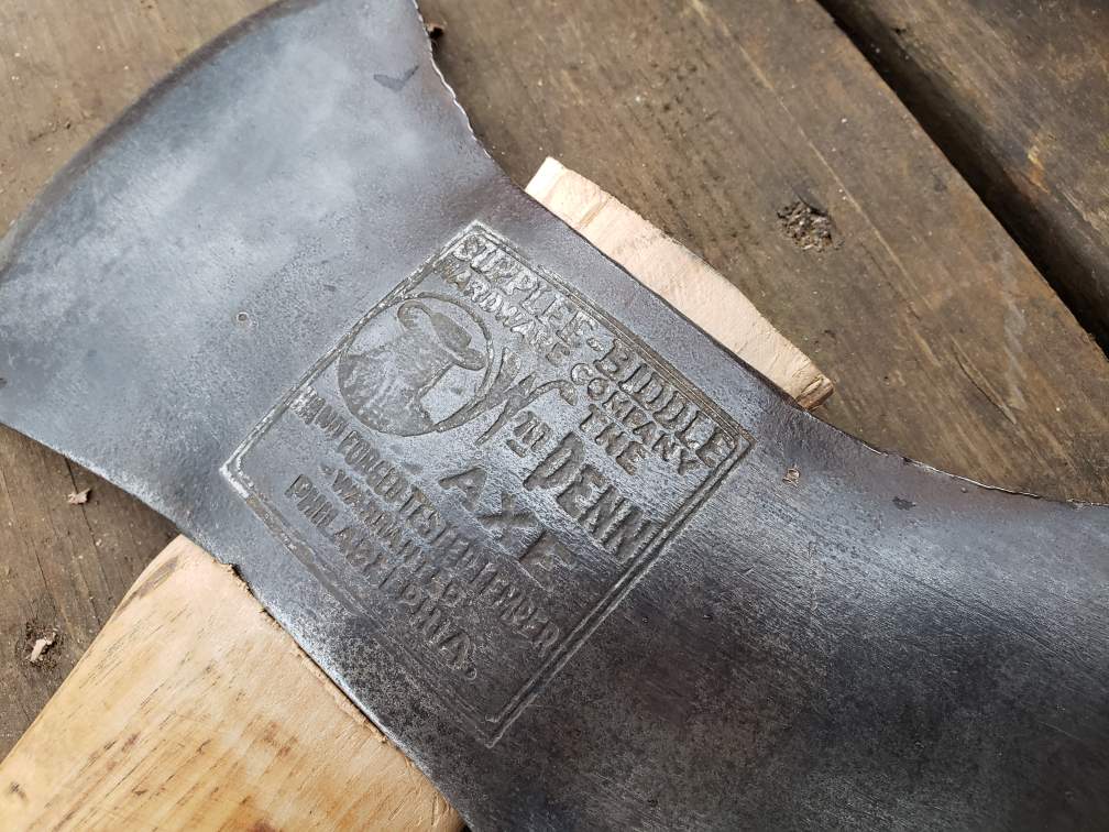

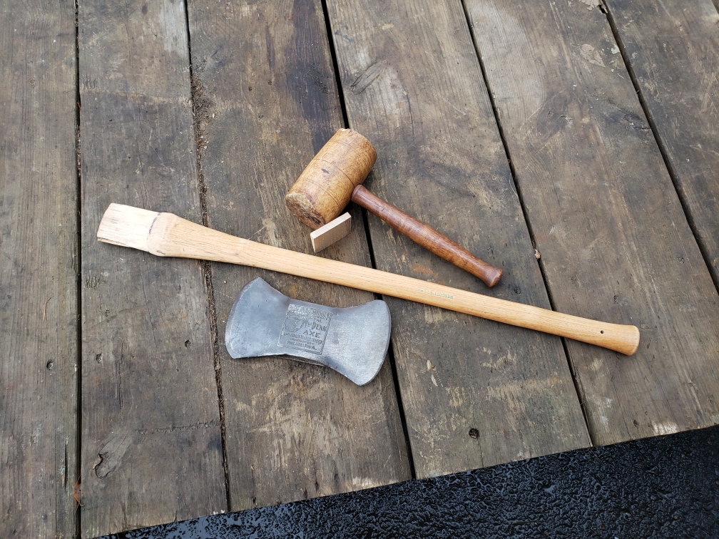

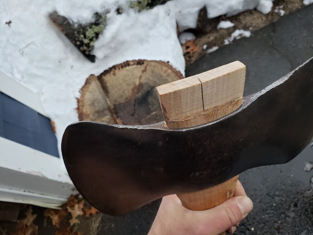

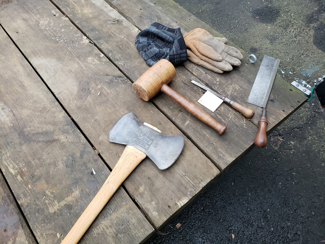

I actually practiced my double bit axe handle installation....had a Chinese 'Diamond' double bit head laying around. Cleaned it up and put a 'House Handle' 36" handle in it. An interesting cheap axe the Chinese diamond....It has an hour-glass shaped eye...the axe head isn't perfectly symmetrical(not to bad)....plainly marked 3 1/2 but actual head weight is four pounds four ounces!

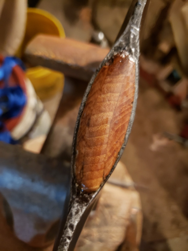

I usually apply a little watered down outdoor wood glue to the top after the wedge is fully set, then mineral oil the haft with some 1200 grit SiC flour to help grip and bring out the grain a bit. A blush of rust from being sharpened with waterstones, since oiled clean.

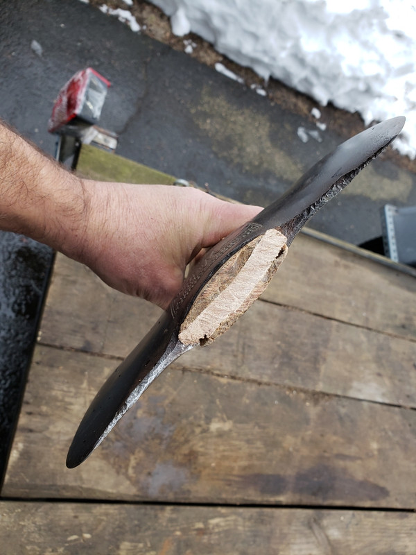

Hi all, this is my first post here. I recently was given a Genuine Norlund Splitting axe but the handle broke. Where can I find a replacement handle? And what I’m I looking for, I’m located in Calgary AB Canada and like a lot of people I’m on a very tight budget. I have never rehung an axe before but there is some great videos out there. Any insight would be appreciated cheers NB

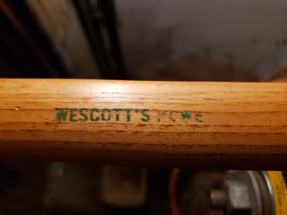

• Vintage Aubuchon Hardware replacement Handle
