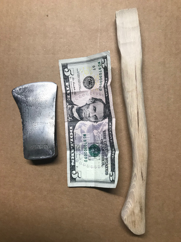

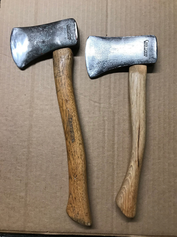

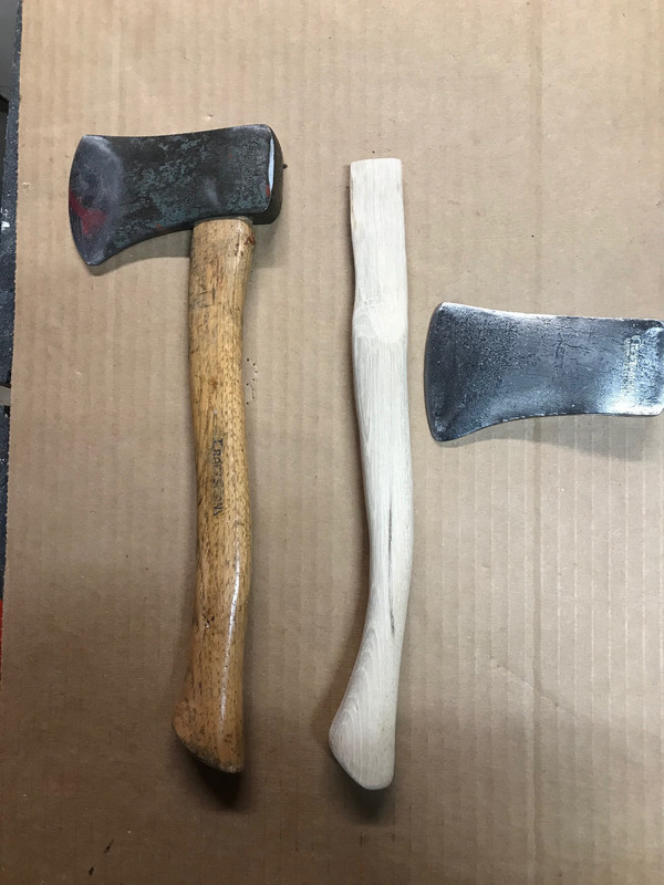

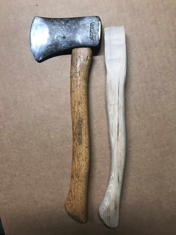

What did you rehang today?

Tha
Thanks for the description, this level of modification is new to me. I have a few tweaked eyes that I live with, but would love to adjust if I could safely. And always interested in what's possible fixing a mushroomed poll to save as much stamp as possible (definitely thinking of my 3lb Rixford Kentucky). I was encouraged to here that you didn't use heat.
I don't have a soft faced hammer, but I have a hard one and lots of yoga ball rubber available. Would that be comparable?
I might think not.
I dont really know not having tried or having ever touched a yoga ball.
Perhaps a brass or copper punch, 1" diameter might make a good soft blow with a steel hammer or a good solid piece of oak or hickory to use a steel hammer on also.
I may need to send you a brass head hammer
I might think not.
Thanks! The yoga ball rubber is fairly thick and comes in handy for loads of things. A yoga ball might be worth more cut up than inflated.
I figured using it for this purpose was a stretch though. I picked up a cheap used copper hammer head on ebay last night. I'll try and do it right. Thanks for your advice!
Thats great! Went and found a copper faced hammer!! Get after it! Cant wait to hear how it goes
