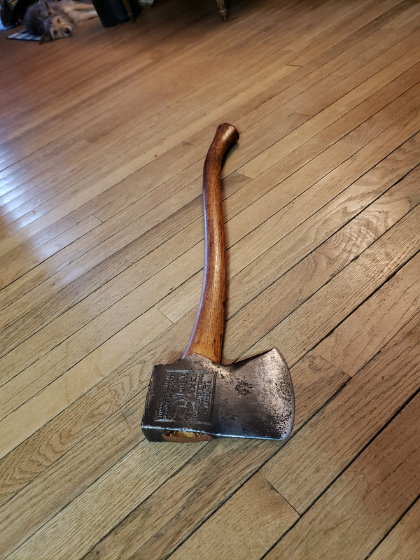

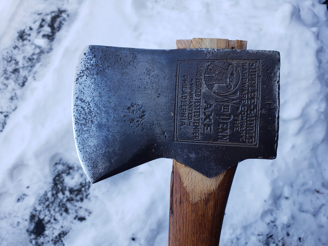

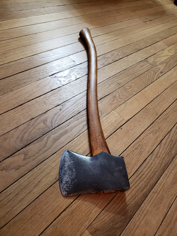

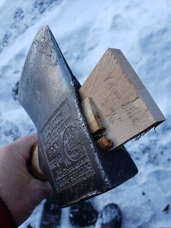

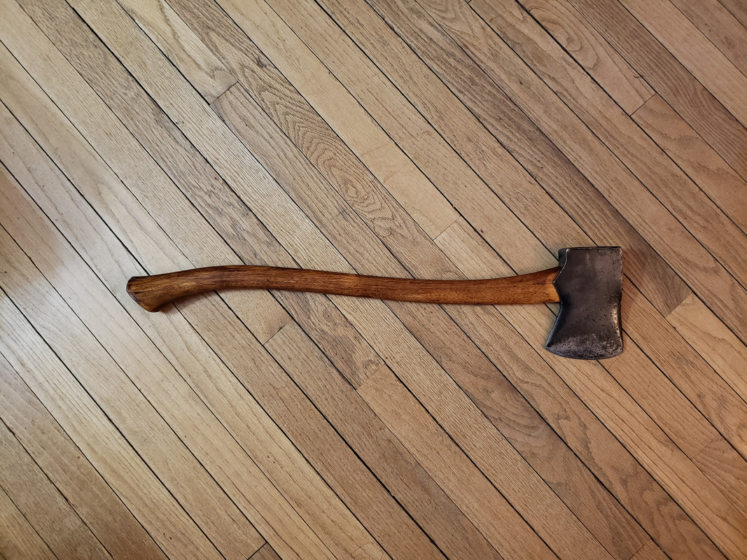

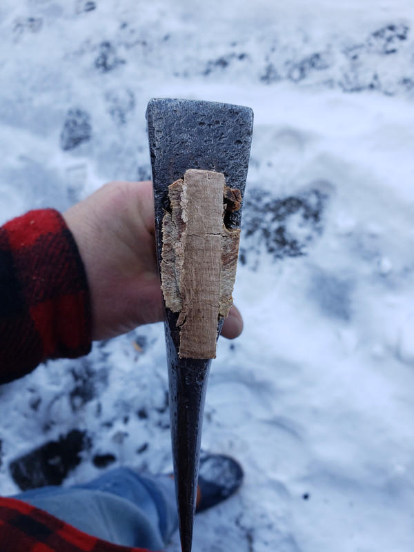

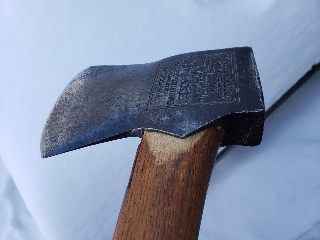

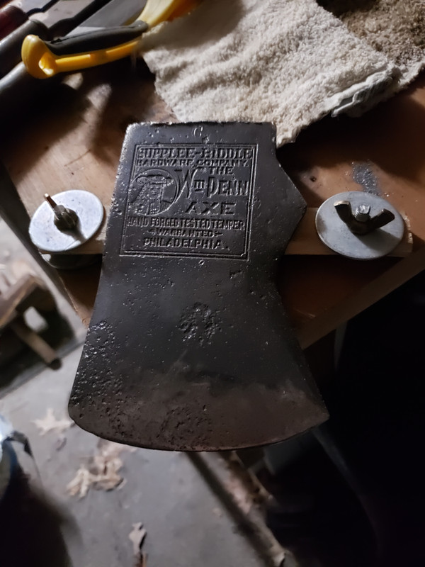

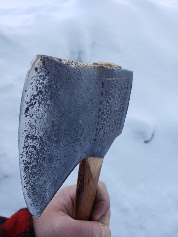

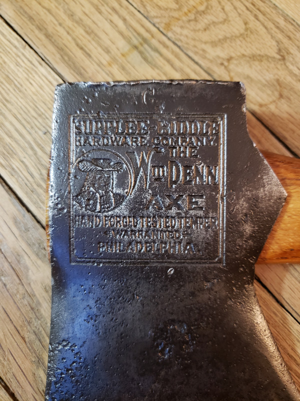

After picking this head up about one year ago, I have finally filed and hung this WmPenn Supplee-Biddle Hardware Co Jersey Pattern axe.

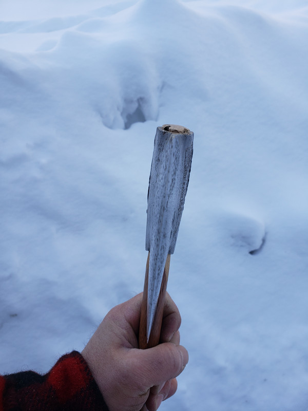

Fitting and ultimately shaping this Precut Yellow Birch Wedge that was given to me by my friend and fellow axe aficionado Josh, Yankee Josh Yankee Josh
Thanks my man!
Driven and hung
Sanded and shaped
Boiled Linseed Oil
Tight, snug fit
4¼lbs
27¾"
4½"Bit
6½" Head
:thumbsup::cool::)

That turned out great Miller! What an exceptional head! Good pairing too! Looks awesome!!

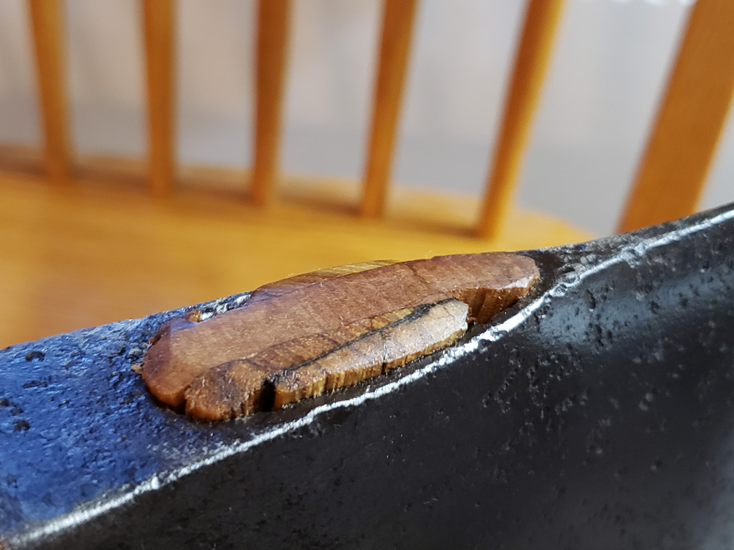

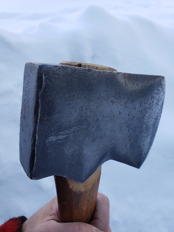

I just rehung my first axe today! Its a Council tools boys axe, and it has been a good, reliable tool. Finally the head got loose enough that it was rattling and it freaked me out. lol My dad got ahold of a very nice Amish made handle, and I used that to rehang it. It was a pain in the butt, but it is satisfying to finally be done. It went very well, though I had a small gap at the bottom that I filled with wood filler. I finished it with a metal cross wedge and some boiled linseed oil. it looks pretty good, hopefully it will last as long as the original handle did. I left the wood a touch proud, about an eighth of an inch, and the wood split just a bit when I used the metal wedge but I think it will work.
Sorry, just saw this. Yes, just bought copper but should have gone thinner. This was 3/16 that I just hammered into that shape. They do the job though.

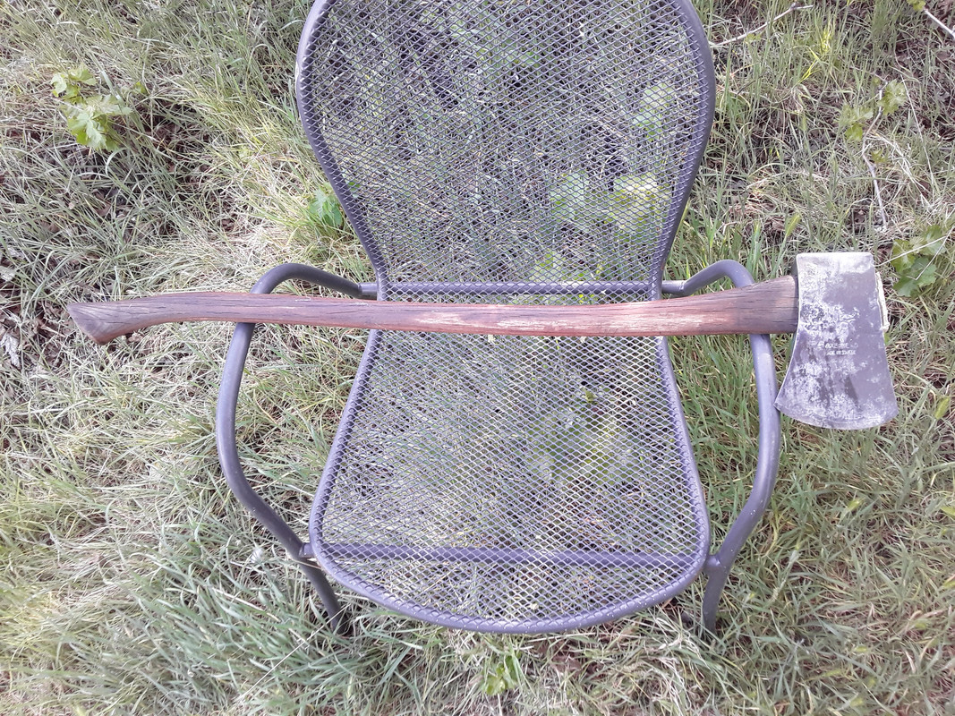

This is the first axe i've ever hung: its going to be a user

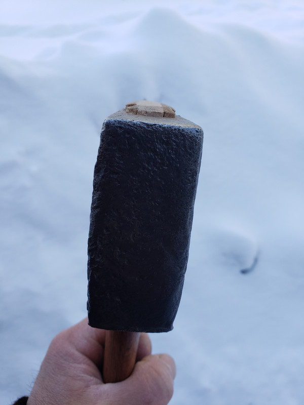

This did start cracking at both front corners of the tip of the eye on bottom. It had looked so sound after cleaning that I was hanging it with reckless abandon. So I instead proceeded very gently and used a super soft eastern white cedar wedge as to not apply too much outward pressure to the eye.

Here's the cedar wedge. Again I was very gentle so it's not perfect.

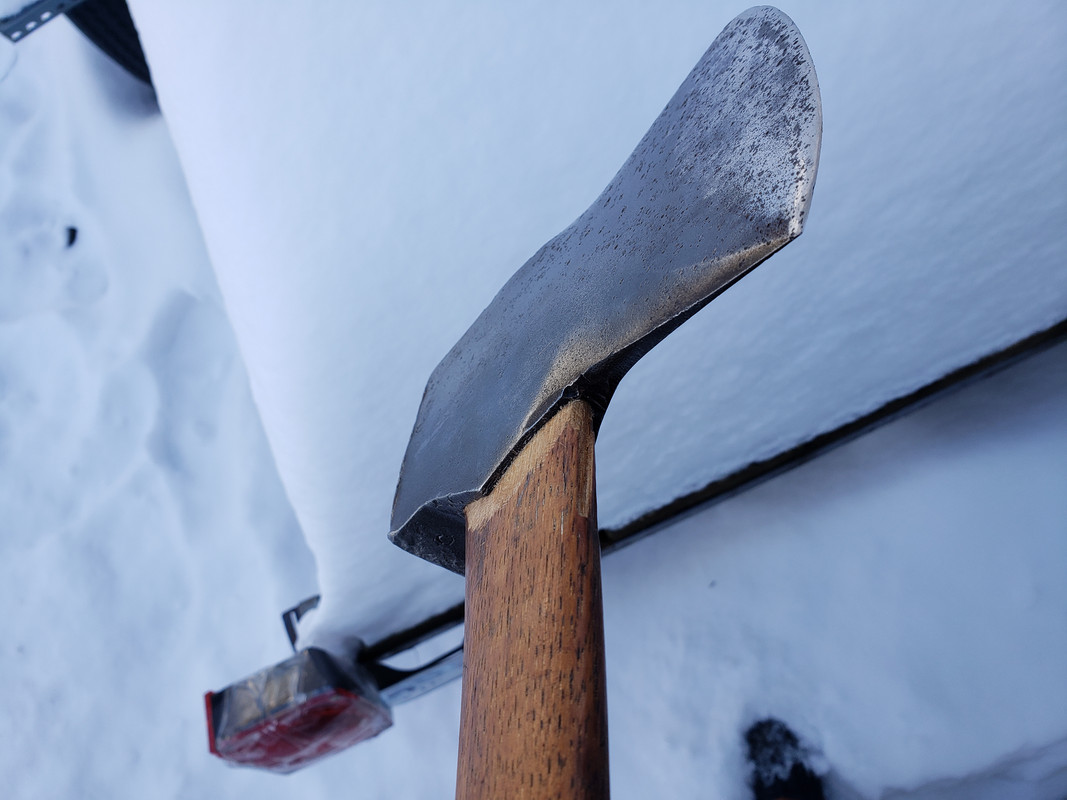

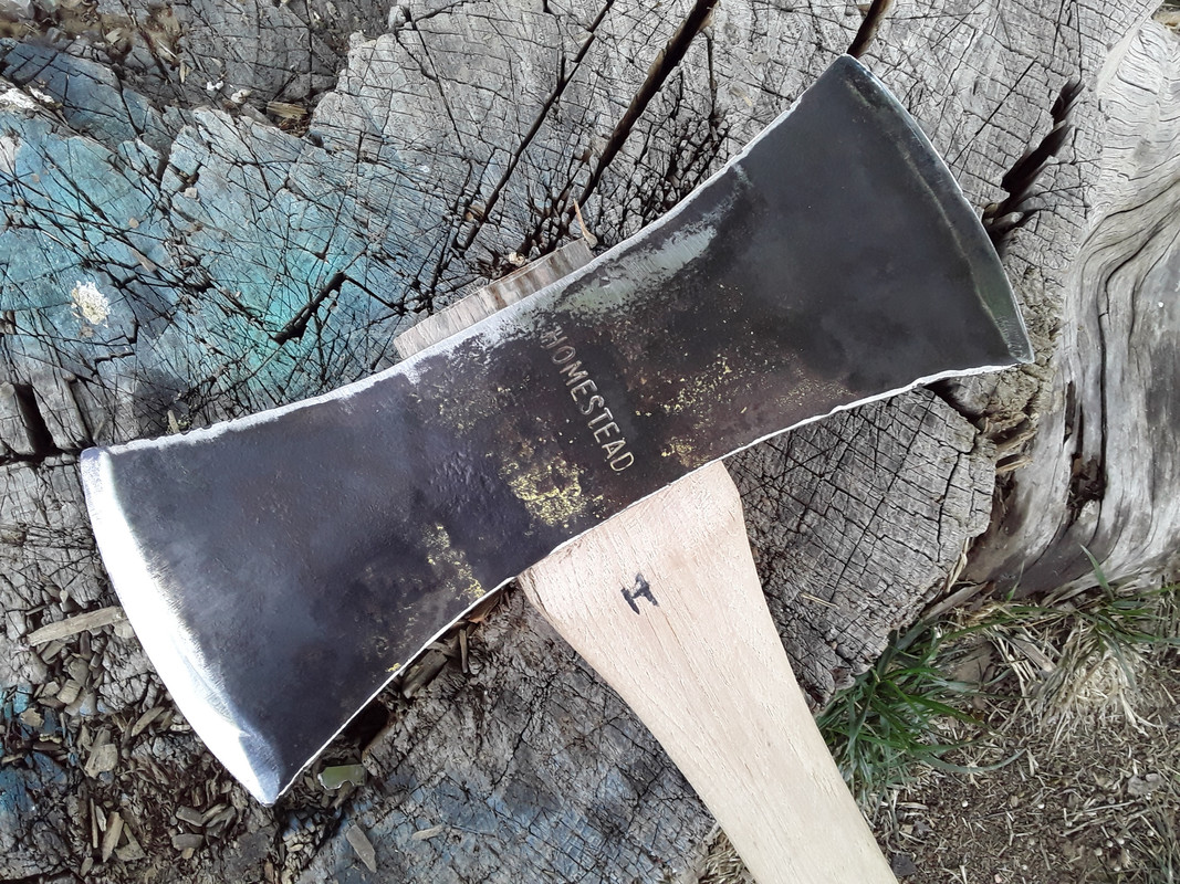

Today I worked on this 3.5lb Homestead narrow swamper.
I believe it to be a late pre Mann Collins like my homestead Michigan because they're pretty thin and slightly convexed, but they could possibly be very early Mann Collins axes.
I still need to wedge it and finish the handle.
