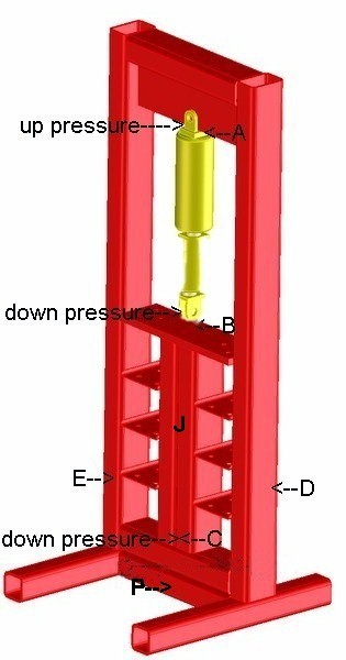

OK this is what I'm saying..what would the difference be..
I like Dan's setup,as for the squaring dies i think that is a great idea,but i would design it so the dies would slide and have a direct downward force on the working die....Keep the ideas coming.....
Mike thanks for the return call. :)
I just wished I were here or you were there for the calls..
you mentioned an example with a 2x4 if attached by the ends say 2" off the floor and you stepped on it , it would have a deflection. yes agree.
please look at the picture..
and tell me if I don't understand this
Please
consider this unit as over powered and will bend or brake things..
when you have pressure at A and B you have downward force on the
J columns ,,this
in turn would place downward pressure on P (the lower horizontal tubes)
if enough strain was applied to B, J, and either P bent or sheared the end welds
noting
that this unit is not bolted to the floor...
you are saying that because P is laying on the floor,Tubes E and D would not raise because of the pressure at A?
is this what you are saying to me? :confused:

I have already fabricated this press (minus the guide system) and if you look at the front you will see the same construction as an I-beam. The 2 vertical tubes being the web of the I-beam. The outside vertical tubes box in the "I-beam". This is a very strong and rigid design. Dan is correct in his second last post that the vertical tubes could be shorter. The unit is much stronger with the longer tubes thou and at a very small increase in price. ( the extra 12 or so inches of structural tube. Remember, Im using drop off for this.)
A w4x13 I-beam has a height of 4.16", a flange thickness of .345 inches and a web thickness of .280". A w18x114 I-beam has a height of 18.48", flange thickness of .991" and a web thickness of .595" There is a substantial hieght increase in the stronger I-beam. There is also a reason i used 2 vertical tubes instead of one. It shortens up the distance between the inside vertical tubes and the outside vertical tubes. This address' the point Dan made in his last post. If you tested this frame to the point of destruction, the side tubes would raise up with enough pressure.(i think alot of other bad things would happen first tho) The shorter distance between those tubes means the welds on the one inch plate are closer together which means there is less flex in the plate. That and all the welds on the bottom should keep those side tubes from raising up.
Mr. Claiborne, I for one, would love to hear anything you have to say about this design or anything else related to a forging press. I would not take it as trying to sell your press. (if you do end up selling more because of it that would be great). I am sure the boxed in anvil plates on your press are very costly to weld and 1" plate isnt cheap either. Maybe a I-beam cross section with a short vertical section like Dan suggested will improve the stength as well as take some cost out of it. I think that would benifit everyone. Please understand, I am not bashing you press or implying that there is anything at all wrong with it the way it is now. One of the major responsibilities of my day job is to find ways to cut cost without sacrificing quality and thats what im trying to do with my press. Let me rephrase that. I am trying to make it as simple as possible and keep it as strong as possible.
K.I.S.S = Keep it super simple.
S.W.A.G = Stupid wild ass guess.
Both should be used when designing
If i had to do this again I would remove one of the bottom horizontal tubes and weld it directly under the 1" anvil plate. I believe that would be an improvement on what I already have.
