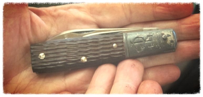

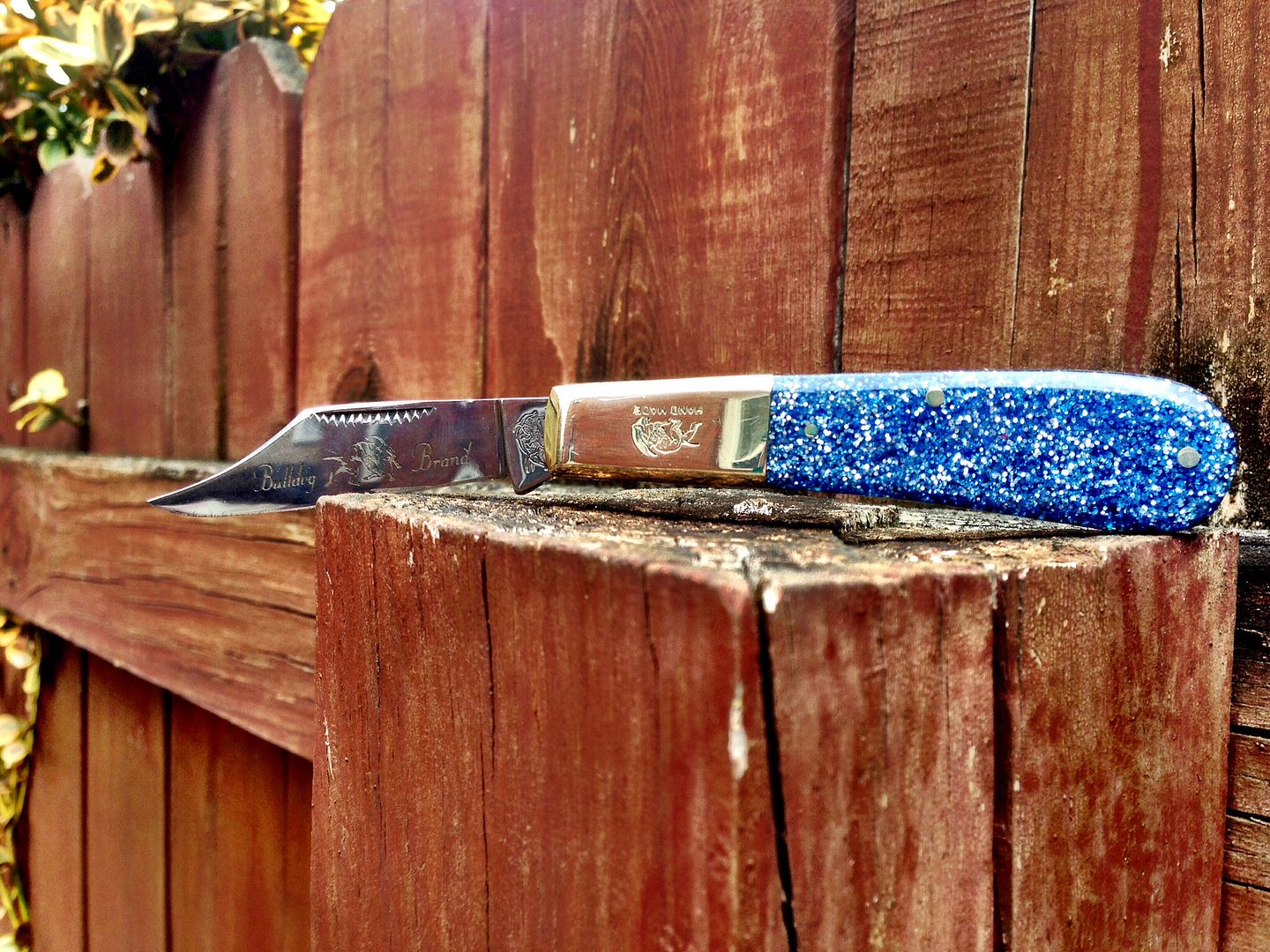

Here are a couple from my collection. The first is a single clip point Bulldog curved barlow. I like the match strike crescent nick and the covers. Oh, did you see the covers? :p
Disco!
And a Ka Bar dogs head single clip.

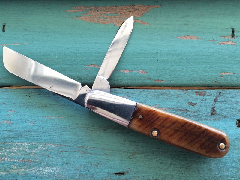

Here is an example of blade damage to a Sheepfoot tip that can be caused by a kick that is too low. Note the tip of the blade is missing, which can be caused when it hits the head pin. Though that may not be the cause in this case as the blade does not look that low to me.. cant say for sure, not my knife
It's my knife and yes it's probably impossible to say how the damage occurred but not because the kick is too low. The blade actually rests correctly when closed.

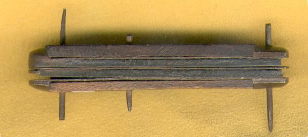

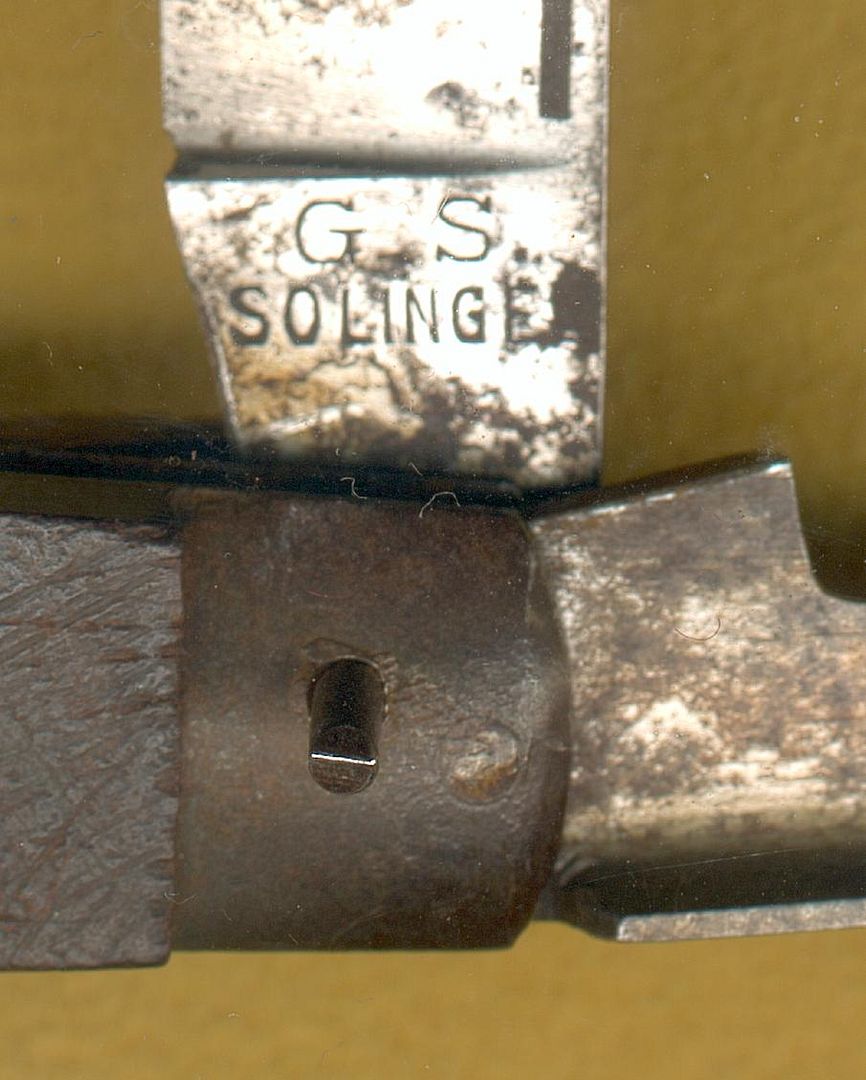

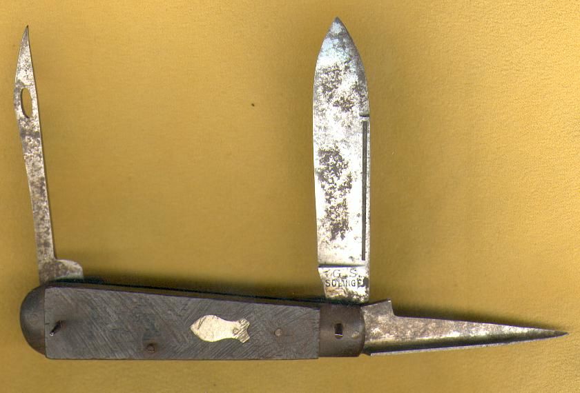

Not a Barlow, but I came across this unfinished knife at the Oregon Knife show several years ago. I've never seen a finished one!
It is indeed an amazing step from rough to finished!!
