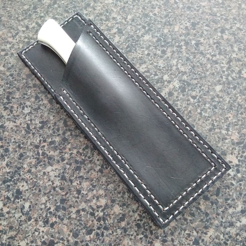

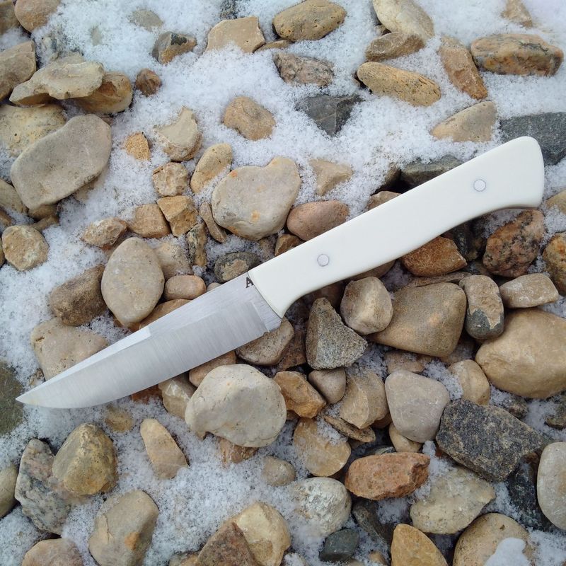

What would knife making be without making a mistake or two? I made this Murray Carter design paring knife for myself. I always seem to go for the smaller knives in the kitchen and thought I would try something of his. I have no idea where my head was at when I etched the blade, but I put my maker's mark way too far back. Oh well, live and learn. It will be a good reminder of what not to do in the future. I also made a little leather sheath kind of holder for it. The steel is AEB-L at 62Rc with bleached linen micarta scales.
I have a maker friend who calls those "stake" knives instead of mistakes! Says his wife has a drawer full! Looks really good though. Nice work
Looks like you got the tip just a tad hot and a little thin, But looks good.

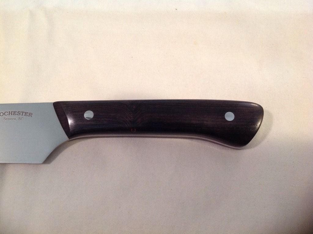

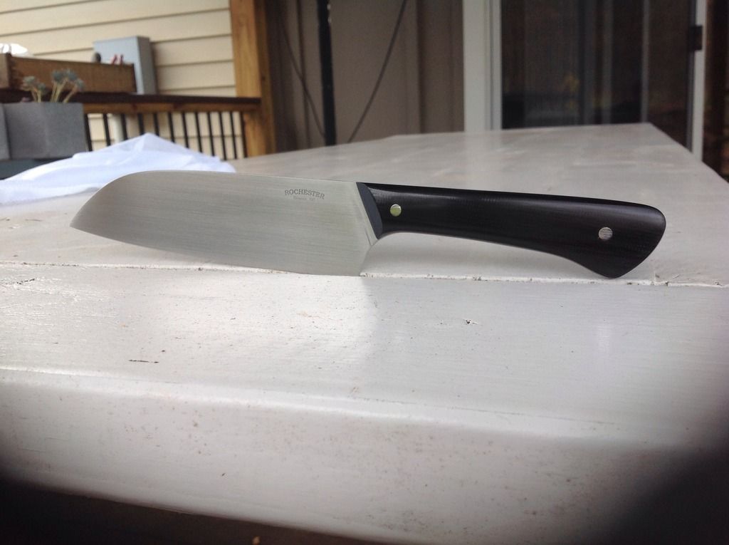

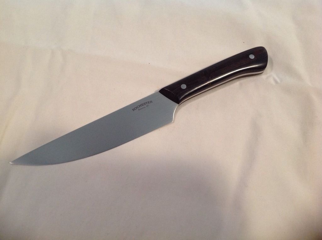

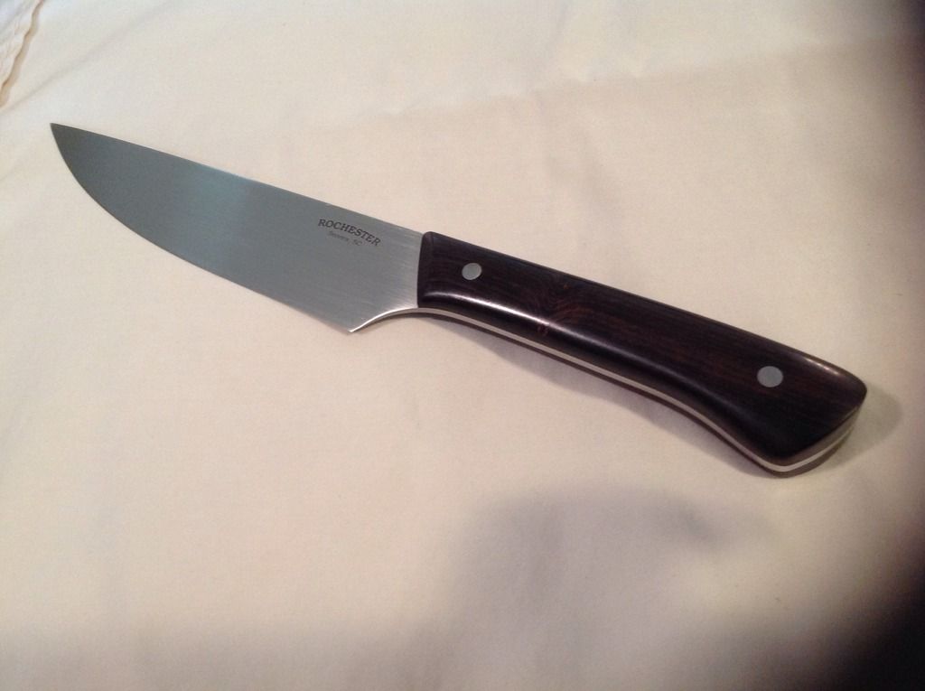

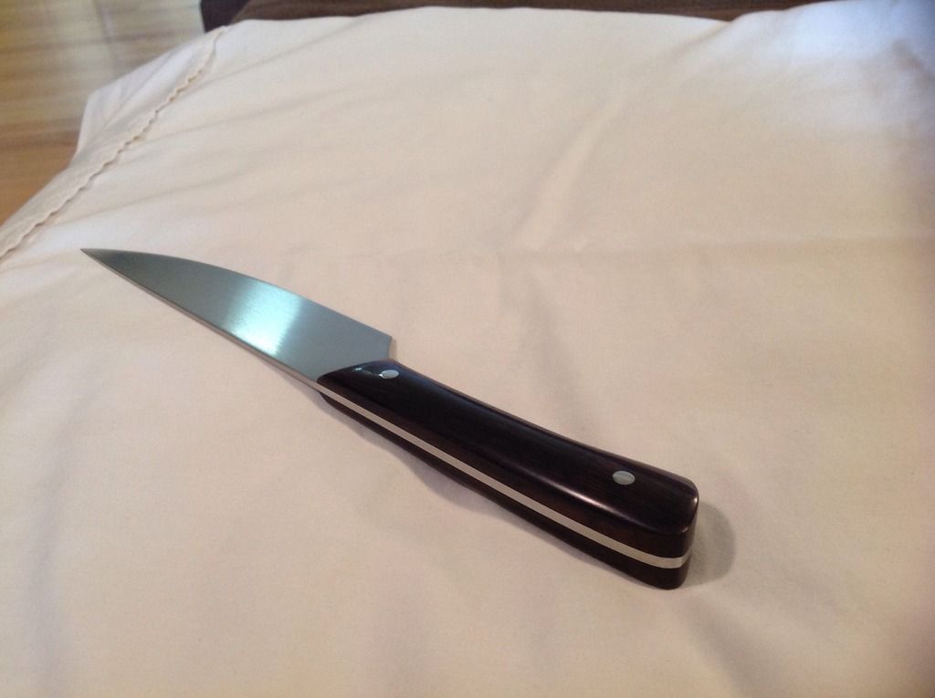

Here are a few pictures of the I just finished this morning. The blade is 3/32" Cpm154cm at 61RC. The handle is African Blackwood. I promise to get a better setup for pictures soon!

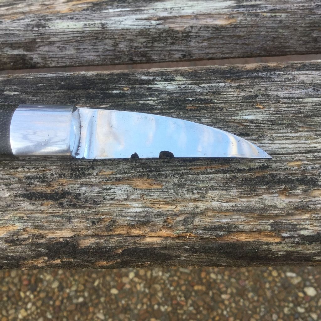

The customer confessed...
Yes, he was abusing the knife and he knew better. He's an instrument mechanic and one of my brothers coworkers at the nuclear plant but he hasn't said exactly what he was doing.
So this is how I tried to salvage the blade. Could I have salvaged this one some other way? Suggestions?
