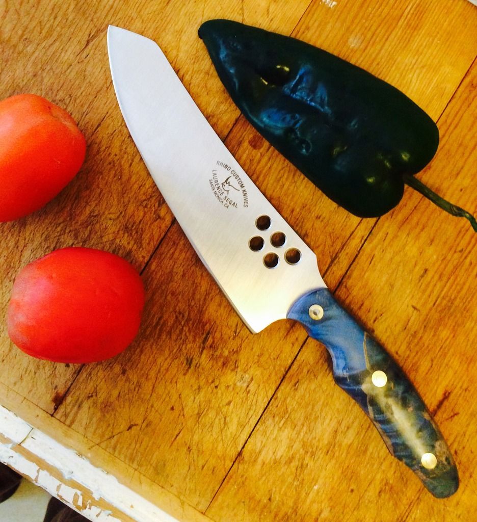

7 3/4" Rhino Asian Chef with Pinch Grip butterfly. 0.110 AEB-L Steel, RC 61 Paul Bos HT,
Dyed & Stabilized Ash Handle with Black liners. Loveless Bolts. The buyer will be picking this one up tonight.
